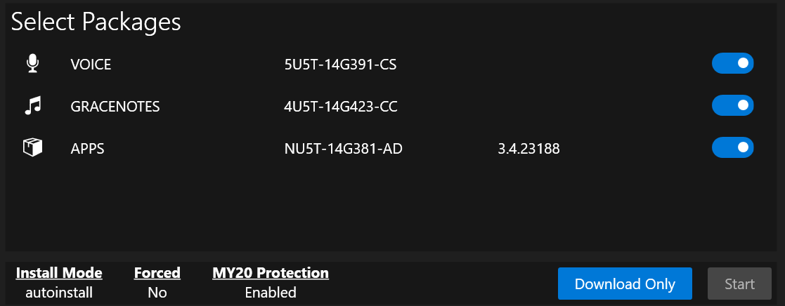

So, being inside the “guessing zone”, this is what I would try with Syn3updater:
  • Make sure MY20 protection is active, since your unit is MY20 and can’t be reformatted.
  • Create an upgrade USB with the following settings:
    – Current build 3.4.23188, region NA, NAV NO
    – Target build 3.4.23188, region NA, NAV NO.
That should give you these packages:
Note that install mode at the bottom left is “autoinstall”, you can only “autoinstall” stuff, never reformat/downgrade…
Those are the ones for NA units like yours, specially the APPS package which is for the 8 inch screen units. Also, Gracenotes for NA instead of China, the same for voices.

If the screen is physically about 8inches as the image suggests, yes.
