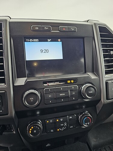

I bought the truck used from a dealer less than a month ago. They told me everything was stock. I connected my home wifi to my pickup and it did an automatic update to Sync. I cannot get the correct version because there are no buttons to push on the screen to see what version I am on. This is a picture of what it looks like.
What you’re seeing is exactly what happens when the Display Unit has been upgraded on a 4" to 8" conversion. Have you ever used Forscan on this vehicle?

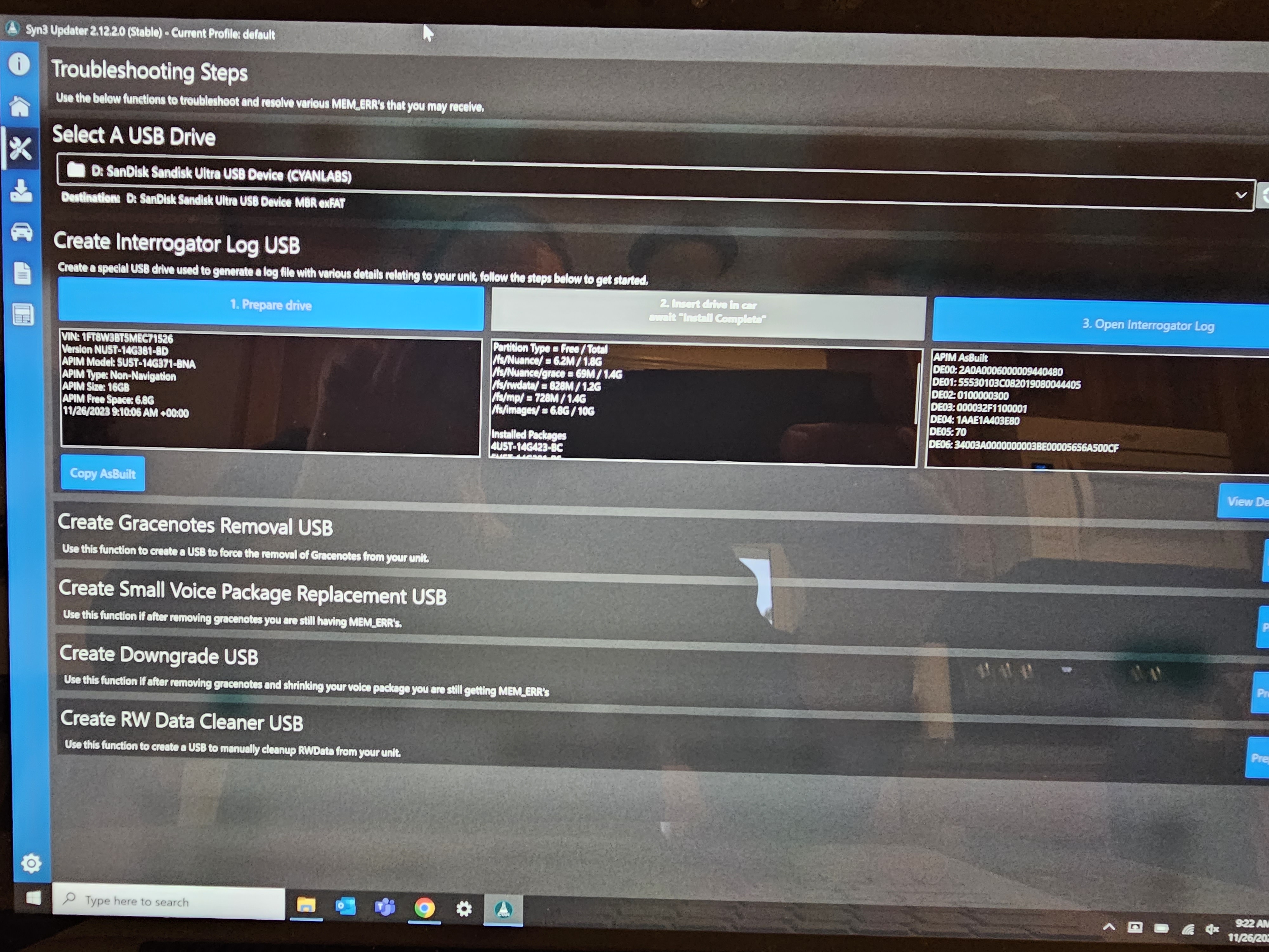

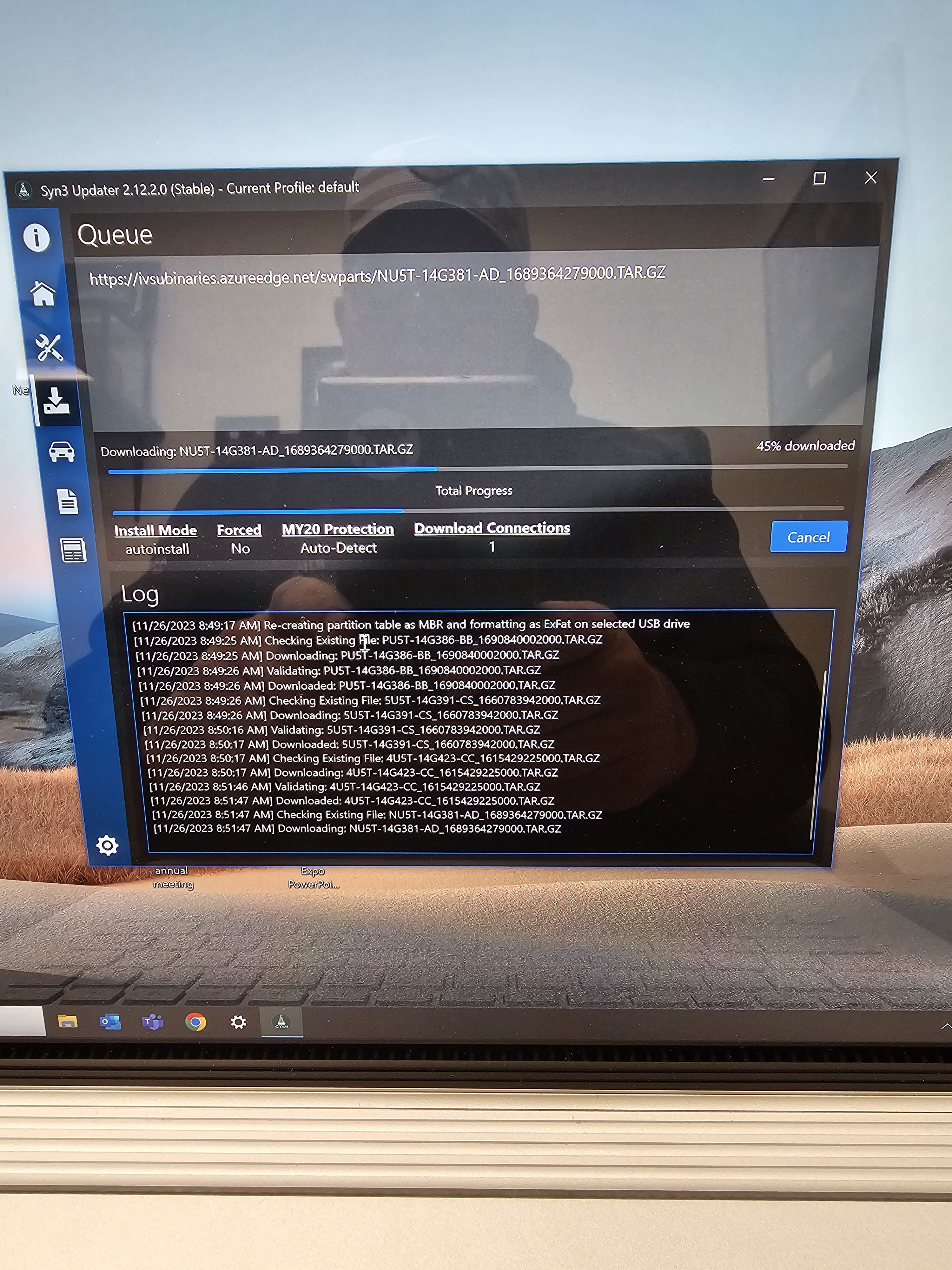

I was able to download the syn3 updater, how do I know what version to select? Hiw do I get the log file?

Back to your case, thank you for the information. The XML file would be better than a poto, but I have seen what I needed to see.
I have a very important question: what Sync3 version is the unit running?, you can check that on the screen in the About Sync section. This is very important, because I can’t find that package on our DB.
Based on deductions, that’s the small screen sw sync3 runs, hence the small screen.
But I need confirmation about the version and build number from the about sync3 section.
Sorry to butt in but apparently he cannot get into the ‘about’ screen to check sync version and build as there is currently no link to the settings on the screen unless there is another way to access it.

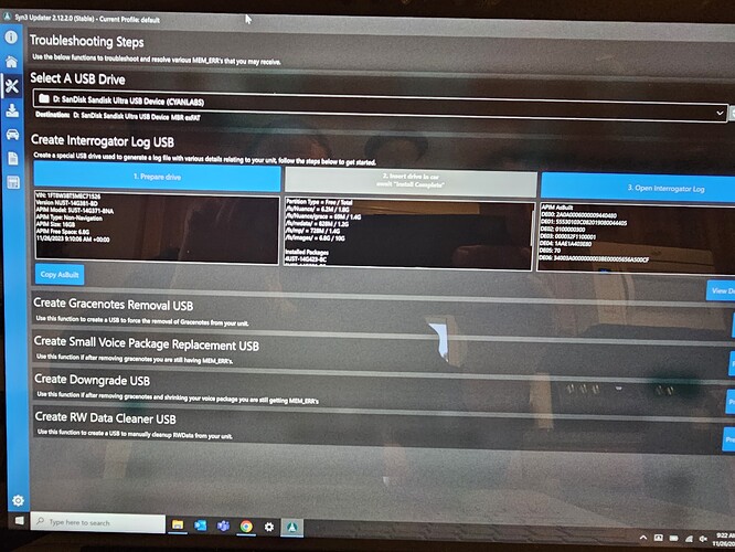

Here is what the XML file reads opened in wordpad:
