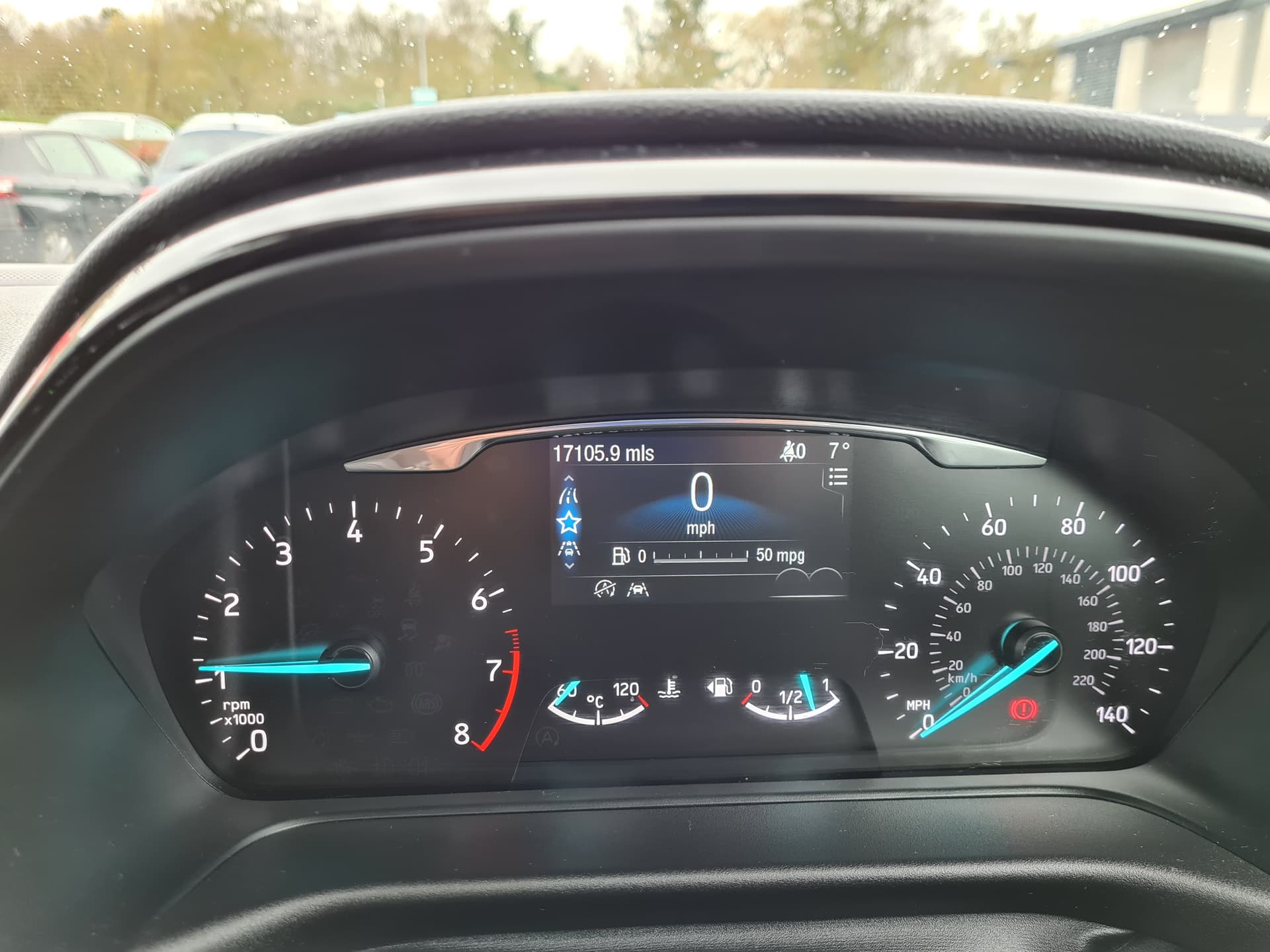

This is my dashboard with Google Maps direction
Did you master reset?
Hello, yes I did a master reset of the sync system. I’ve attached a photo of my dash if this may help anyone.
And my sync is 3.4, build 21265

Without checking those values, there is not really much to do here, because it should work without any modifications. You would need to get an adapter, get forscan, and check those values mentioned before.
