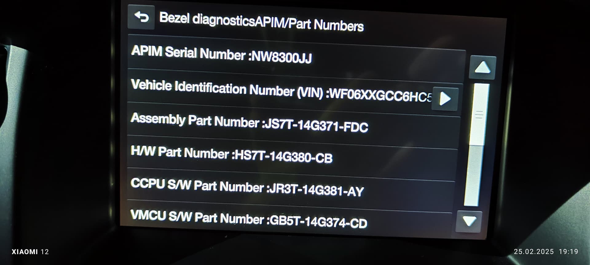

Hello, I updated the navigation from 2.3 to 3.0 on the Ford website. But the phones are still not connected to Android Auto. After several attempts it connects but for 10 seconds. After that the image disappears and returns to the basic navigation image. The phone appears to be still connected. The version I have is JS7T-14G371-FDC and it appears that it is not MY20. What else can be done?

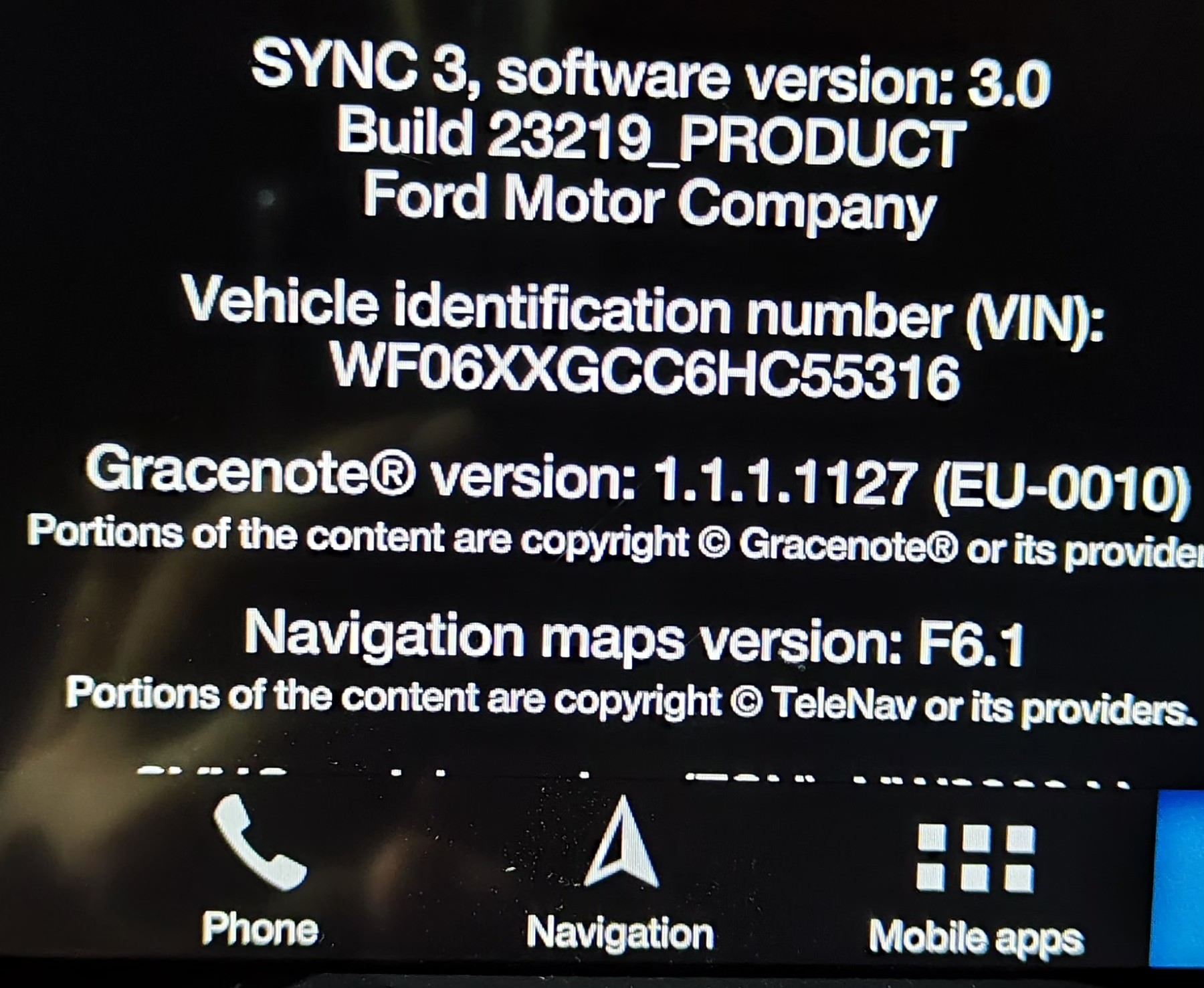

Old SYNC Version: 2.5
New SYNC Version: 3.0
