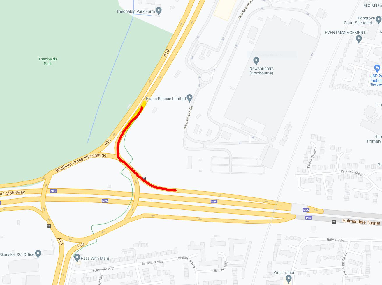

Also, the reverse of the above routes. An example is coming along the A10 from Ware in Hertfordshire approaching the M25 roundabout. Sync 3 screen says first left which is correct. The Nav Repeater shows a go all the way around the roundabout and come back on yourself. Both show the correct distance of 0.2 miles and the audio is also correct.
Again, this is only when using Android applications and they are working correctly on the screen. They provide perfect navigation but only the nav repeater is wrong which is annoying.
Just to confirm, is the location/turn in this pic one of the confirmed spots? I’m not in the UK so not terribly familiar but gathered from your post that this was a potential one.
If this is, I’m gonna see if I can get a test device running with a spoofed location and compare with my C-Max as well as the Android Auto Headunit emulator and see what I can replicate.
Yes, that is a location where the repeater is incorrect.
So I did manage to spoof my location and do a short ‘trip’ basically along that exact red line. The Nav repeater on mine just displayed the ‘Thru/forward’ icon for these turns (this I do have a video of). I may need to re-do and maybe try a longer stretch to make sure it has enough data to work with. Haven’t yet had a chance to try through the AA Headunit emulator which is my next task.
