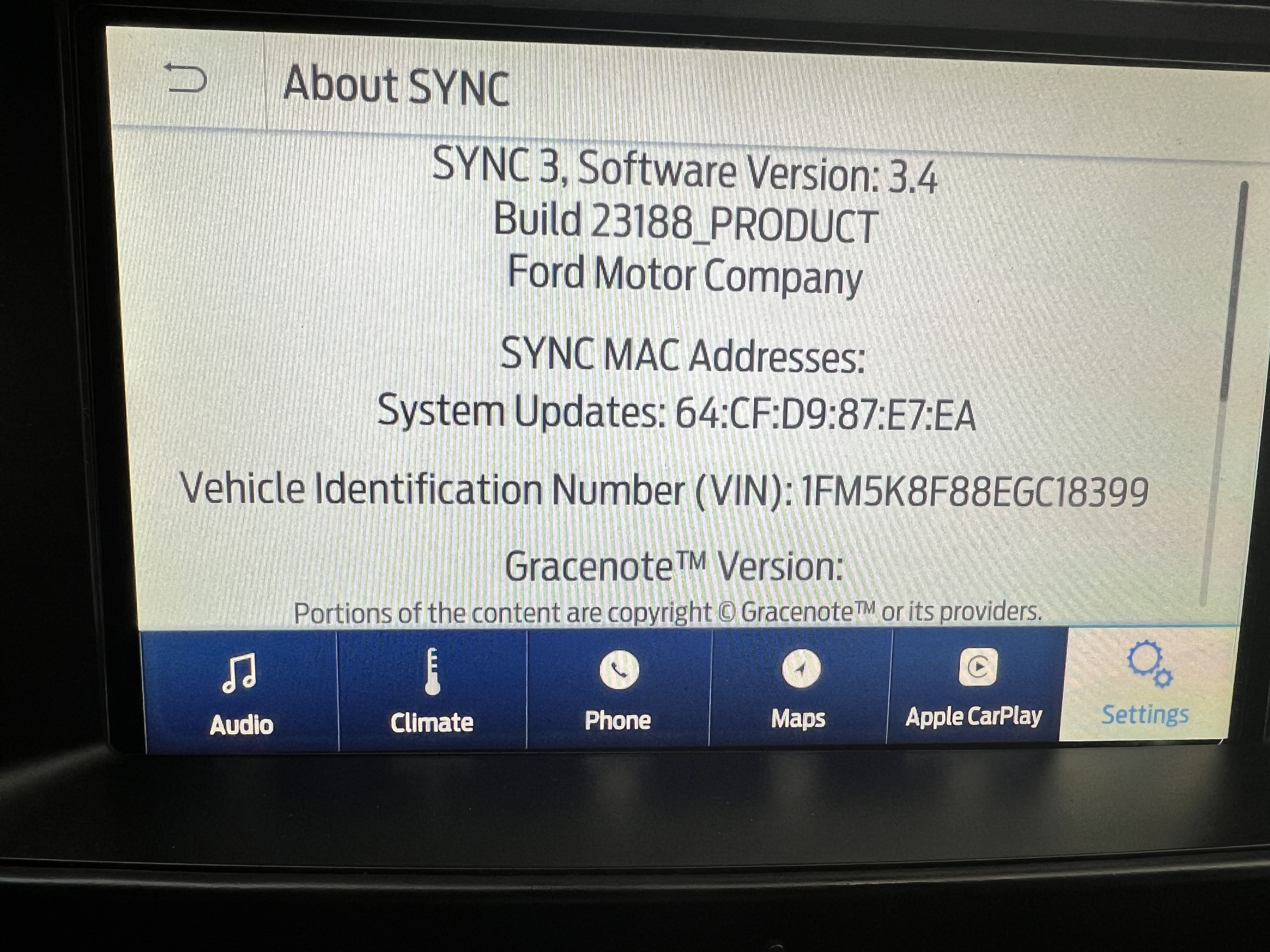

I have changed the APIM of my Ford Explorer 2014 from Sync 2 to Sync 3 (Version 3.0). Not sure if it has navigation or not. The module is from Ford Escape, it does not show the climate options and navigation. I need step by step guide on what needs to be done to update to Sync 3.4 with all the functionalities such as climate options for GCC region.
Old SYNC Version: 3.0
New SYNC Version: 3.0

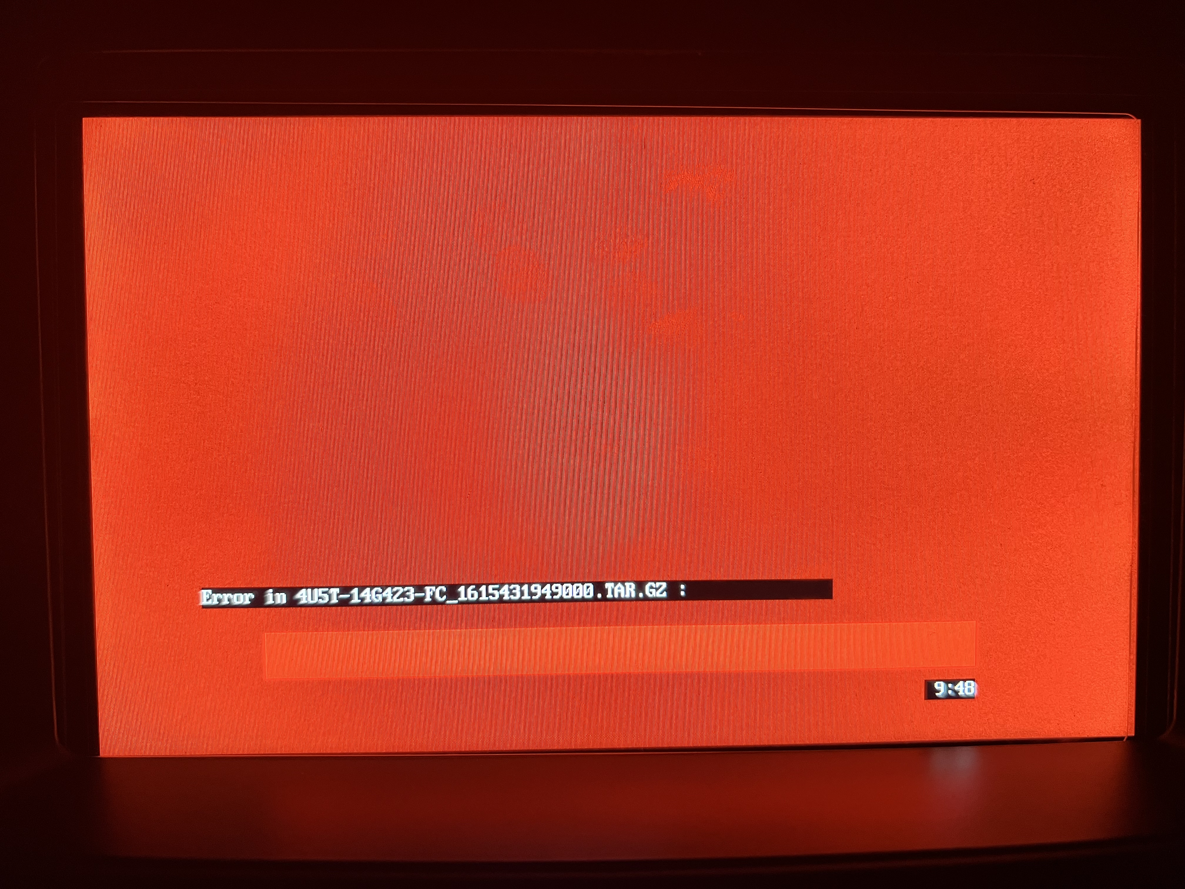

USB hub error for now. USB hub is for Sync 3.4. I have Sync 3.0 currently that I need to update.
Not demanding bro. Just need right instructions to follow without bricking the module.
Got the climate controls back by following one of the threads. Now trying to update via usb through Sync 3 updater app. Hope it doesn’t brick again. Hoping to get a guide. Any advice is highly appreciated. Many thanks.
