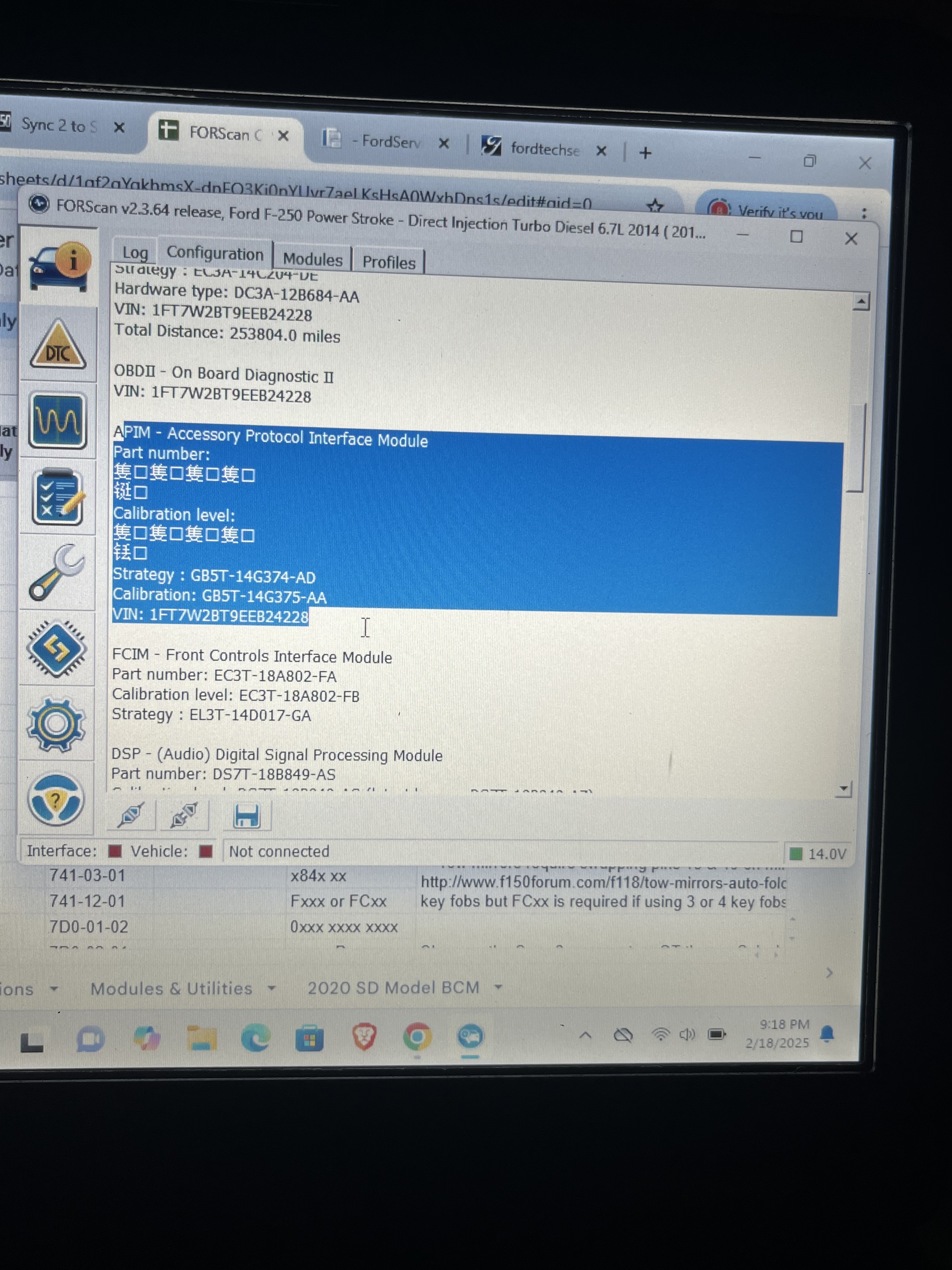

I went to confirm the APIM part number using forscan. When I pulled the data up it shows part number and calibration number in some weird format.
I purchased the APIM pre programmed.
Does anyone know why it shows up like this, could this be some sort of aftermarket APIM?

That is Chinese. You bought one of the counterfeit one’s off the internet.
Thanks for the response. That’s what I thought. I guess it’s a common thing?
Common only if you get a counterfeit one. It may work fine but it seems everyone eventually has a problem with them.

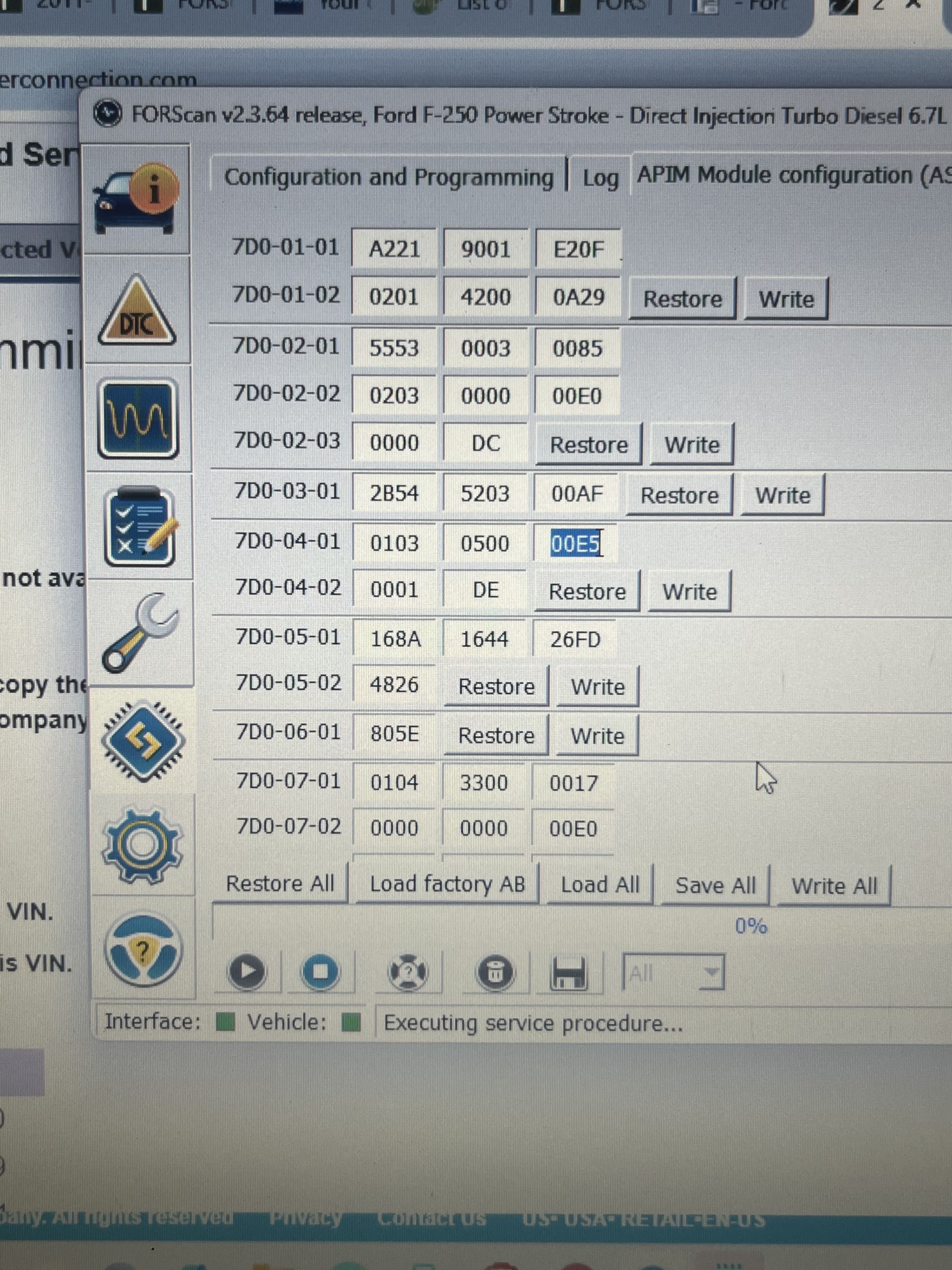

Your speed problem is probably due to some bad AB settings or antenna. Best you can do is post your APIM AB settings here so people can look them over. what antenna did you get for it?
I bought the antenna and splitter directly from ford for a 2017 f250 with nav and satellite radio.
Good, So that will not be your problem than. Odds are it is just an AB setting. Post those.

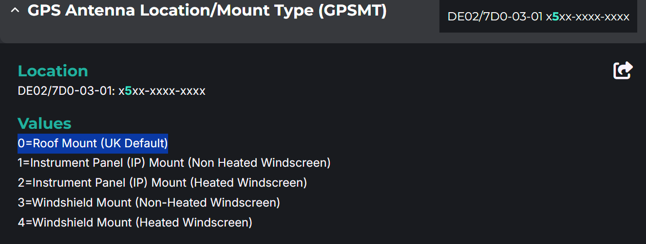

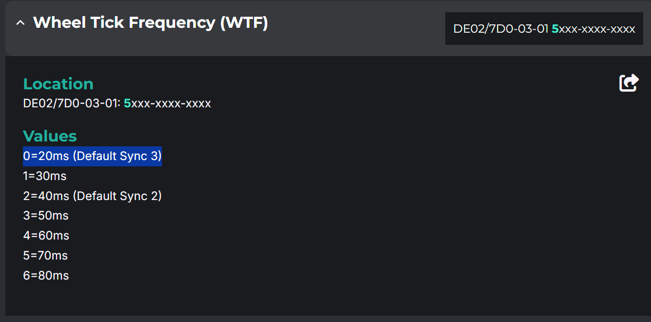

Try these…
Than make this a zero…
