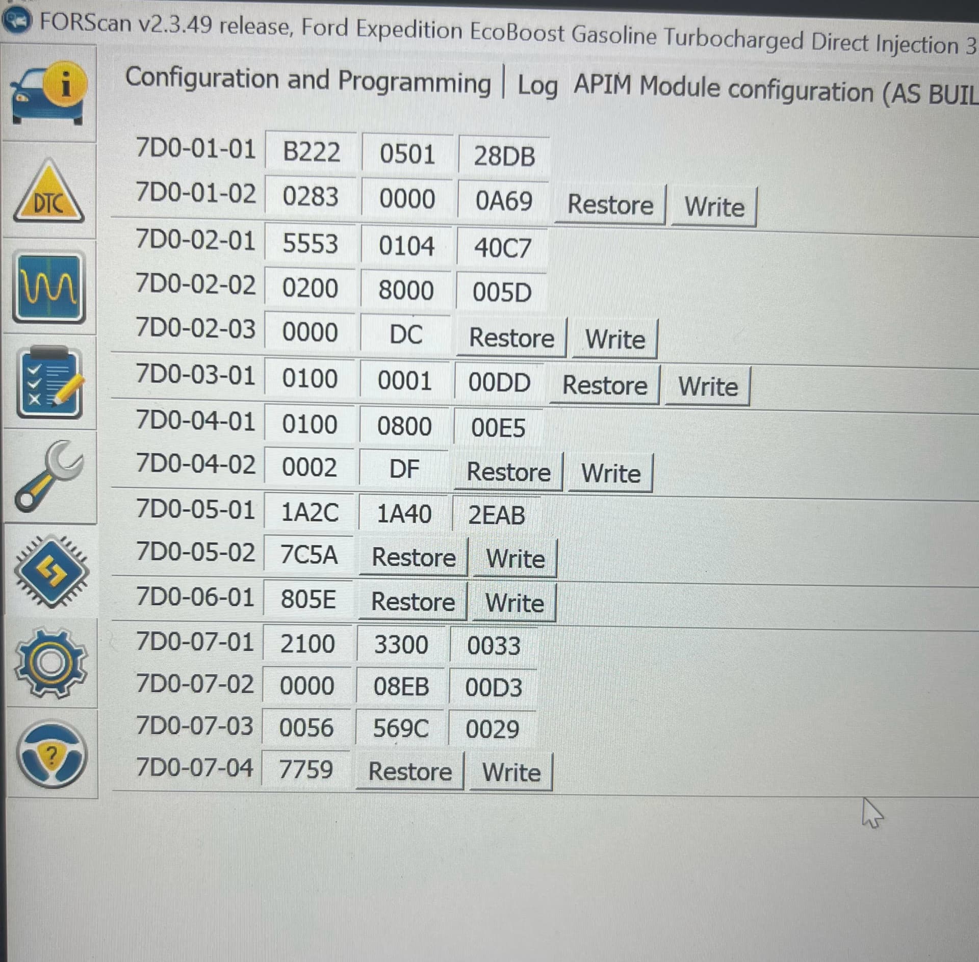

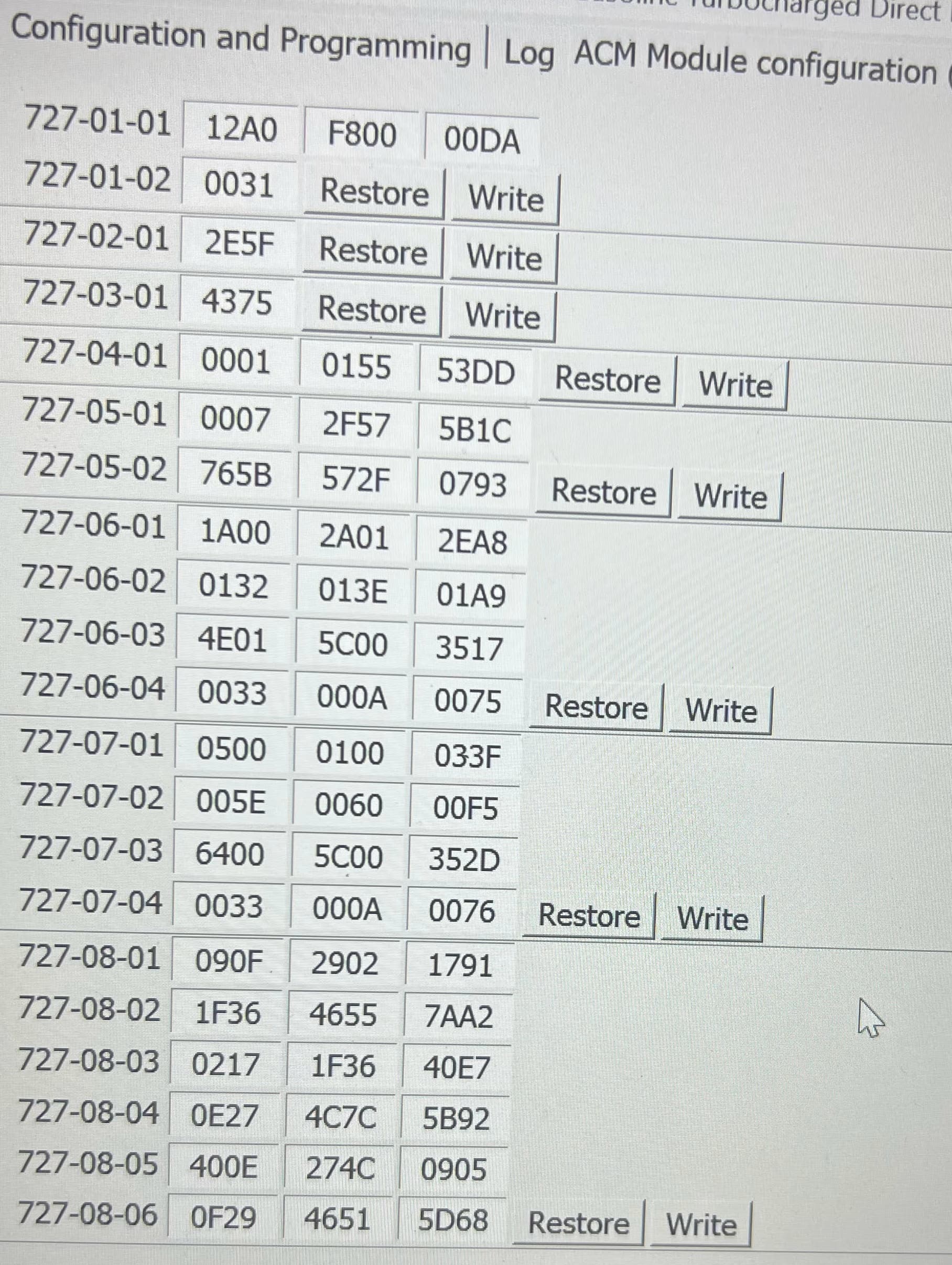

I need to see the asbuilts, please…
Here is the data thanks for helping

That is a possibility. I’ll look thru the asbuilts…
Update: the asbuilts look ok. The DTC however is an issue, see below.

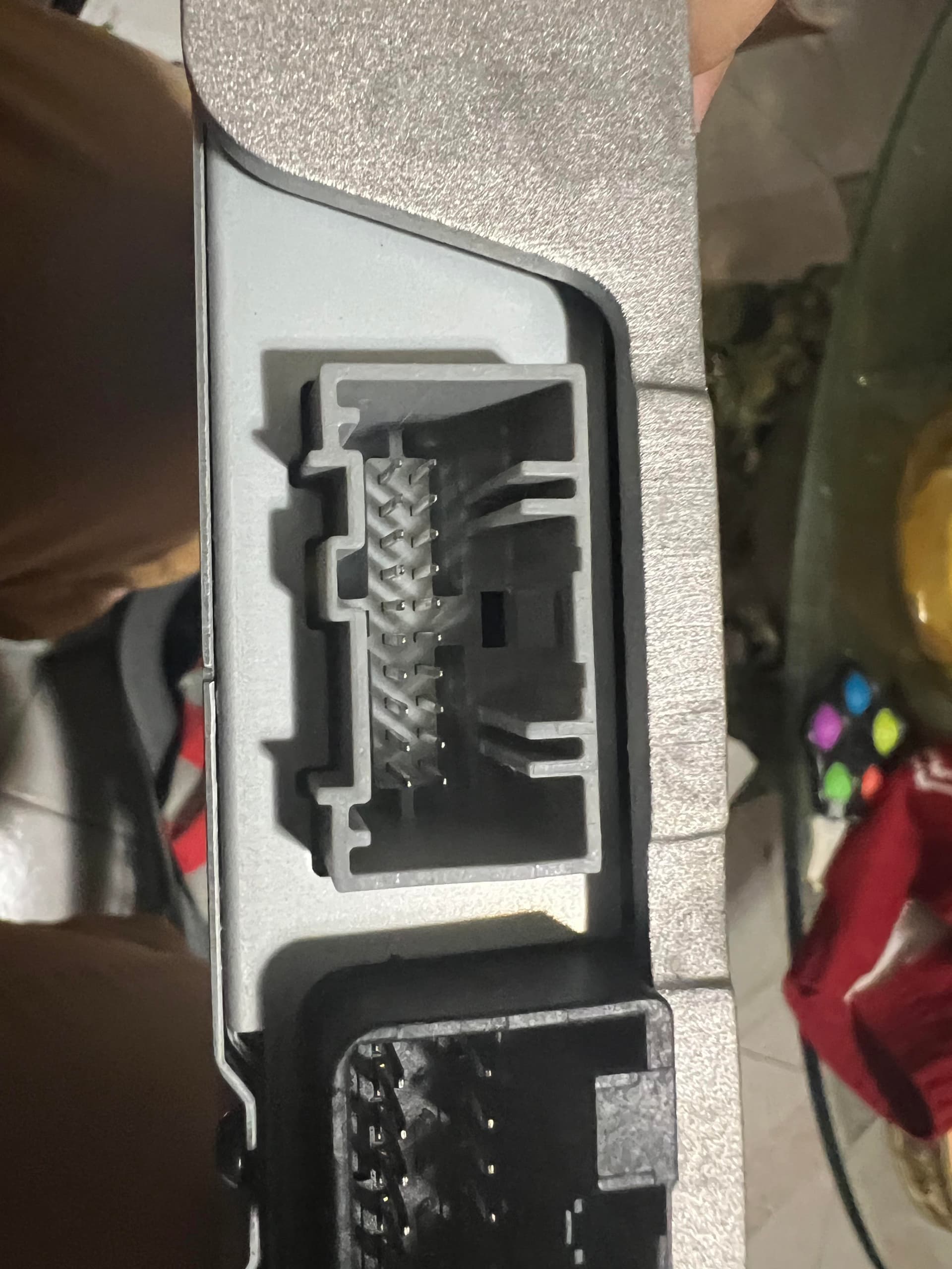

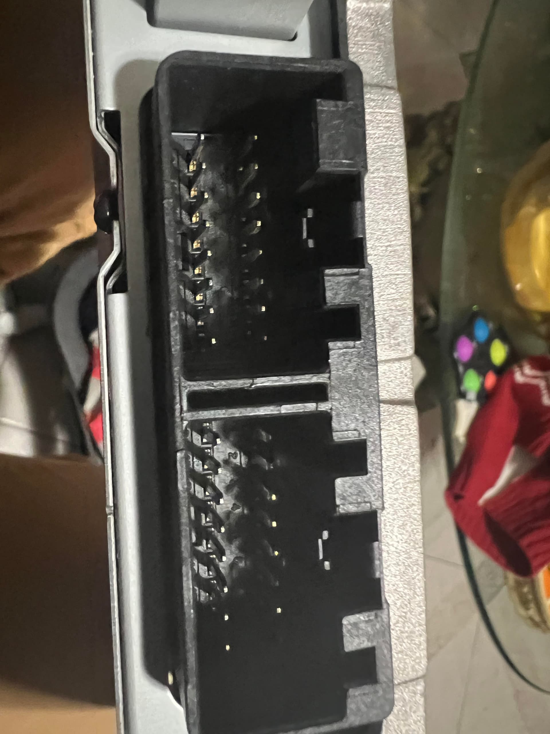

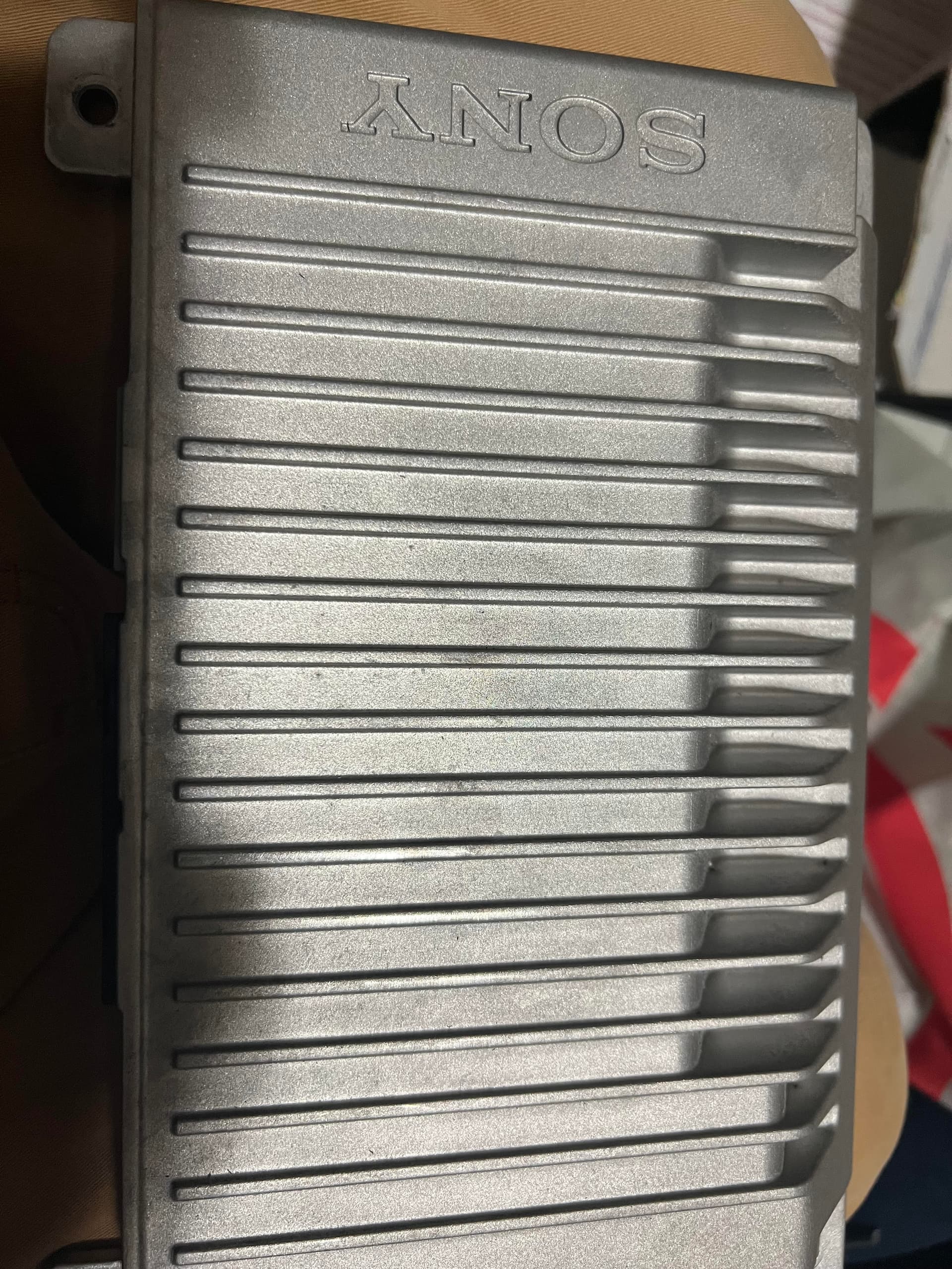

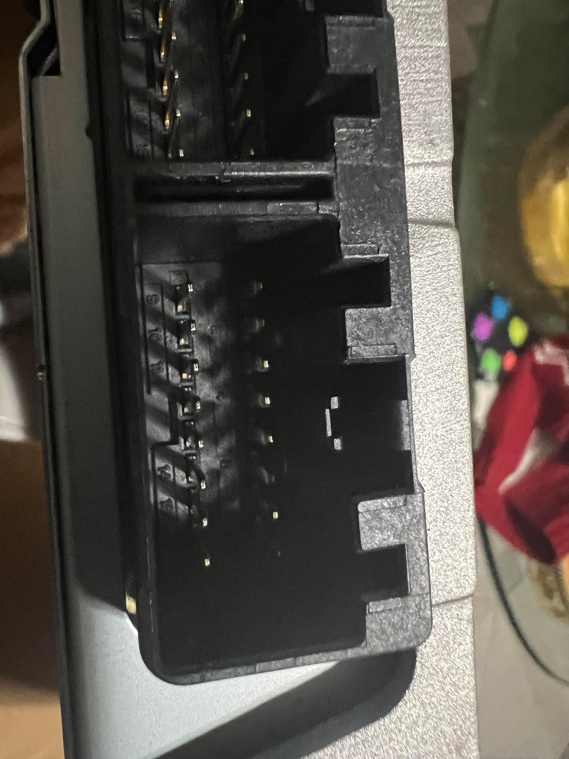

This could be the fault of the Sony amp if you have one. Check the power (fuse) to the Sony amp, disconnect and connect the connectors on the amp, look for corrosion.
Apparently this is a common problem and pretty well documented in several forums. The common solution was to replace the Audio DSP (Sony amp).
Thanks. I already change the AMP. This was the first suggestion from the AUDIO place but that did not work. Will try to unplug and plug it back and will pull the fuse again. At this point I am thinking it may be a wiring issue. I don’t know.
If any other suggestion I will appreciate. I am not trying to be negative but my radio was working fine no issue and the sound was good. After the update which i know is not the issue as stated before but something happen after that now no audio. Sony amp change, ACM module change. Will keep trying
