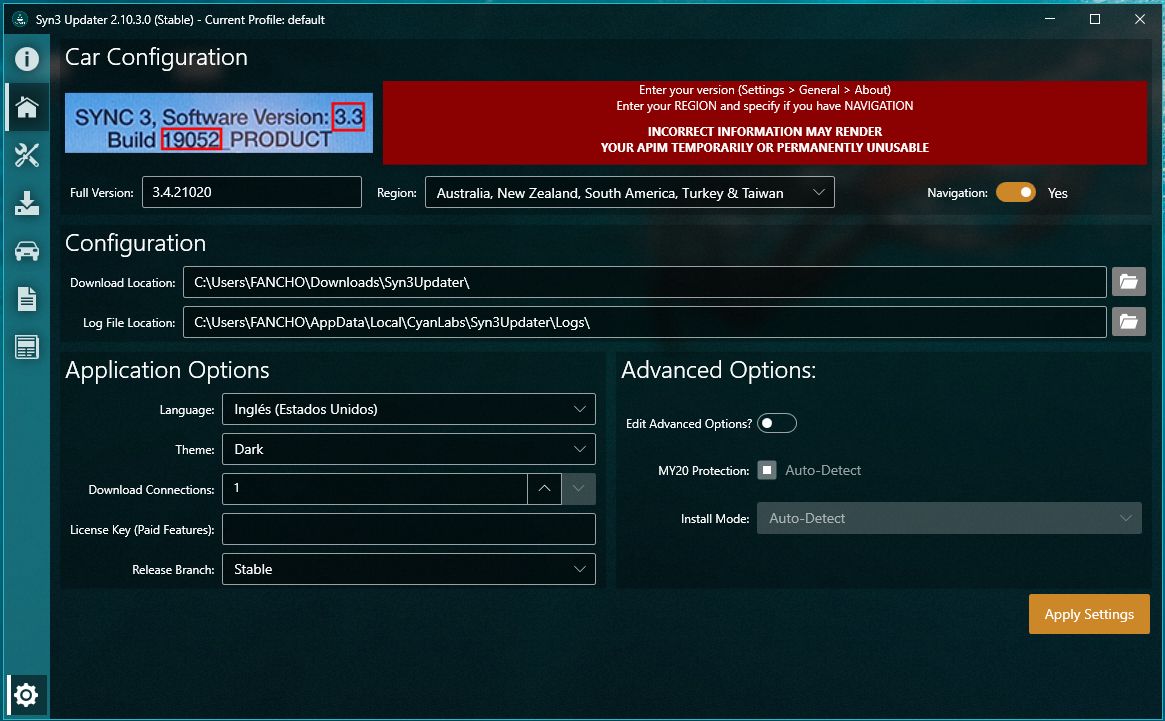

CYANLABS - SYN3 UPDATER - V2.10.3.0
Version: 3.4.21020
Region: ANZ
My20 Protection Enabled: Desactivado
Model: Kingston DataTraveler SE9 USB Device

[6/8/2021 14:10:38] Selected Region: ANZ - Release: Sync 3.4.21194 - Map Version: 2.20 (2020) - ANZ, SA and TW
[6/8/2021 14:10:38] Install Mode: Auto-Detect (downgrade) Forced: False
[6/8/2021 14:10:38] MY20 Protection: Desactivado
[6/8/2021 14:10:38] Formatting USB drive
[6/8/2021 14:10:38] Re-creating partition table as MBR and formatting as ExFat on selected USB drive

You will need to take your vehicle to the dealer to get your APIM repaired or replaced…2021 FORD RANGER qualifies as MY20 or newer…
The settings in the above log indicate that the MY20 Protection was overridden (deactivated). This mode is reset to enabled every time the Syn3 Updater is started unless there is a specific profile set up to deactivate the setting. You are using the default setting, so this was changed and the result was the reformat tool was used on a MY20+ vehicle.
Also, this warning appears clearly in the documentation for the app…
Basic Usage | Cyanlabs Docs
To build off what @F150Chief said, when you get the system replaced you CAN still update to 3.4.21194 but just make sure that you don’t override any protections and select “keep existing maps”. This will only update SYNC itself along with voice and Gracenote.
