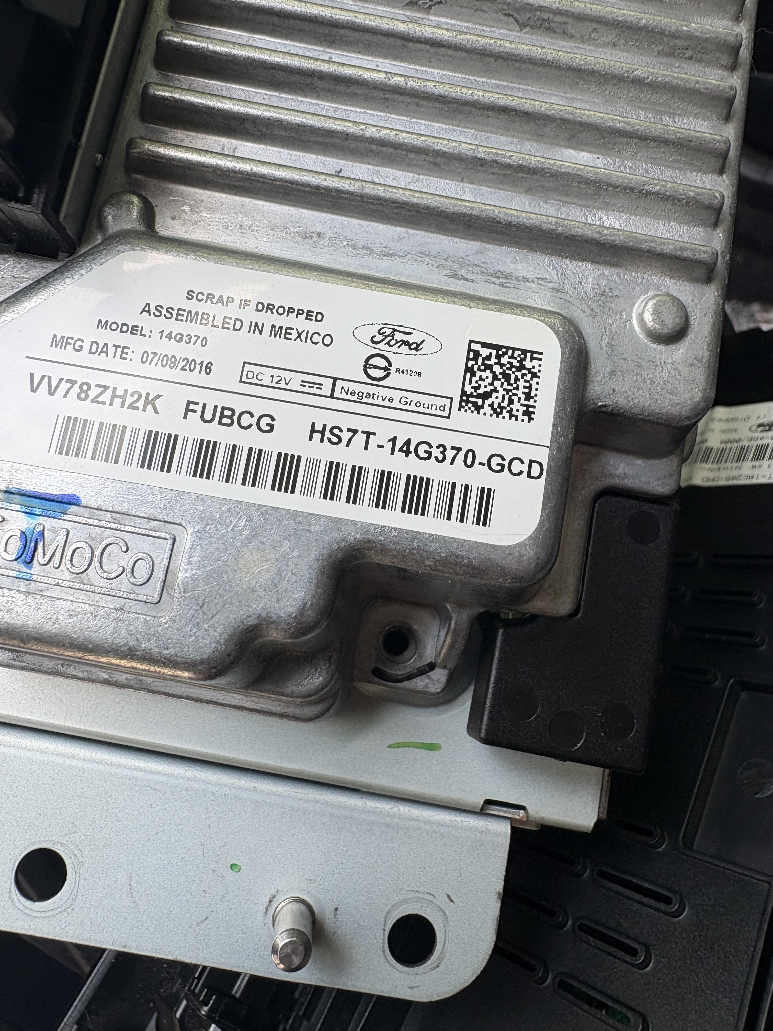

Tried to update firmware with forscan 2.4.8 and it failed and bricked my APIM. Just shows black screen now. How can I fix this??

You have a really old H series APIM. You are asking for trouble update calibrations on that. Unless you need to than I would leave it alone. You have nothing to gain.

My gps is keeps not wanting to work sometimes and someone advised me to update the APIM, guess I was told wrong lol I’ll just take it to the dealership for the gps then. Appreciate the info!
Worked perfectly! Thank you man
