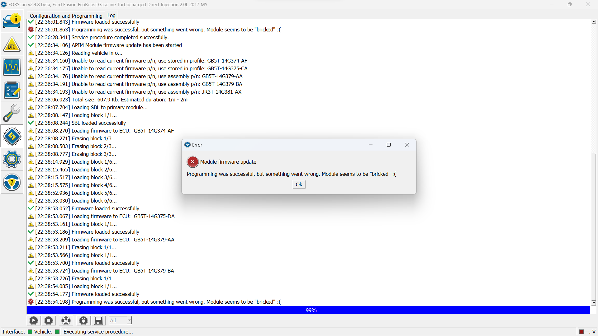

I bought a GJ5T-14G371-CFC APIM which did not start.
I ran it on the bench, the current consumption was at 40 mA.
I programmed via ForScan the bootloader GB5T-14G376-AA, the strategy GB5T-14G374-CB, APIM began to consume ~400 mA and it seems that it is trying to turn on, but the problem is that I cannot flash the 14G375 file, no matter what file I try to flash I get “Operation failed, retrying…”.
Can anybody provide the correct set of files? Unfortunately, I have nowhere to download the files, because ForScan only downloads GB5T-14G376-AA and GB5T-14G374-AF, for other files i have download error.
Old SYNC Version: 3.0.25306
New SYNC Version: 3.0.25306
And all my downloaded 14G375 files have size ~700 bytes, but ForScan detected it’s like 28 bytes, looks like there’s a problem with this. I have GB5T-14G375-DA, GB5T-14G375-CA, GB5T-14G375-FA, and all are listed as 28 bytes. Is this how it should be, or are there correct versions?
Tried with original files which described in “APIM Firmware Flash Rescue Gen 1 (G-2016)”
And tried with my files, which I used to update my another MY16 APIM
So, after many many many times i finally successfully flashed my APIM, but unfortunately seems to be he have internal hardware failures, because he doesn’t boot up & black screen, according to the current readings, it constantly reboots, a couple of times I saw the Ford logo, and that was it.
