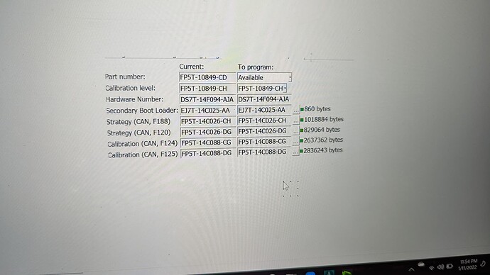

As for my car, my calibration files are the below values:

I have modified the Autohold values in my IPC, no as-built values have been changed on my ABS module as of yet. With that being said, I have the latest IPC calibration that FORScan shows as “available” already installed (just updated from FP5T-10849-CD to FP5T-10849-CH). Is there anyway to look at the entire FORScan database to see if I can find the calibration found stock on HP5T-10849-CF?
Send an email to [email protected]. The support folks might be able to make them available for you.

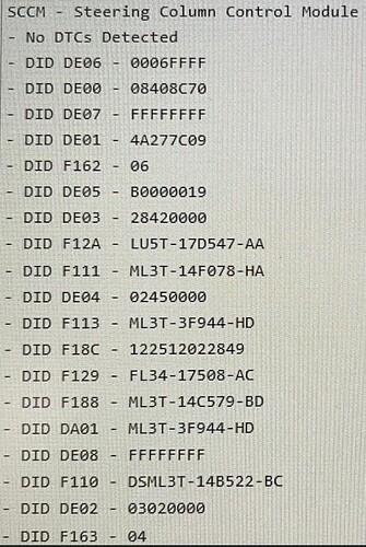

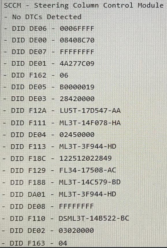

Just an update. Honestly kinda lost. I used FDRS and tried changing the config to no avail. Seems its looking for files that are not there. I can see in the logs that its looking for F12a (LU5T-17D547-AA), F129 (FL34-17508-AC) and F110 (DSML3T-14B522-BC). Also able to pull what is supposed to be based on my Vin.
On-line Diagnostic Database Reference Number (F110) for the part.
I have not seen DID F12a or F129, but i suspect additional ECU Configuration or Strategy files.
DID F162 and 163 are query responses.
I really think the module is corrupted and might need to just be replaced.
