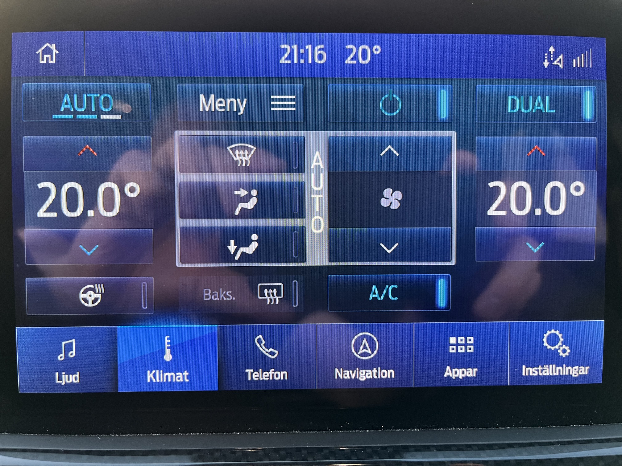

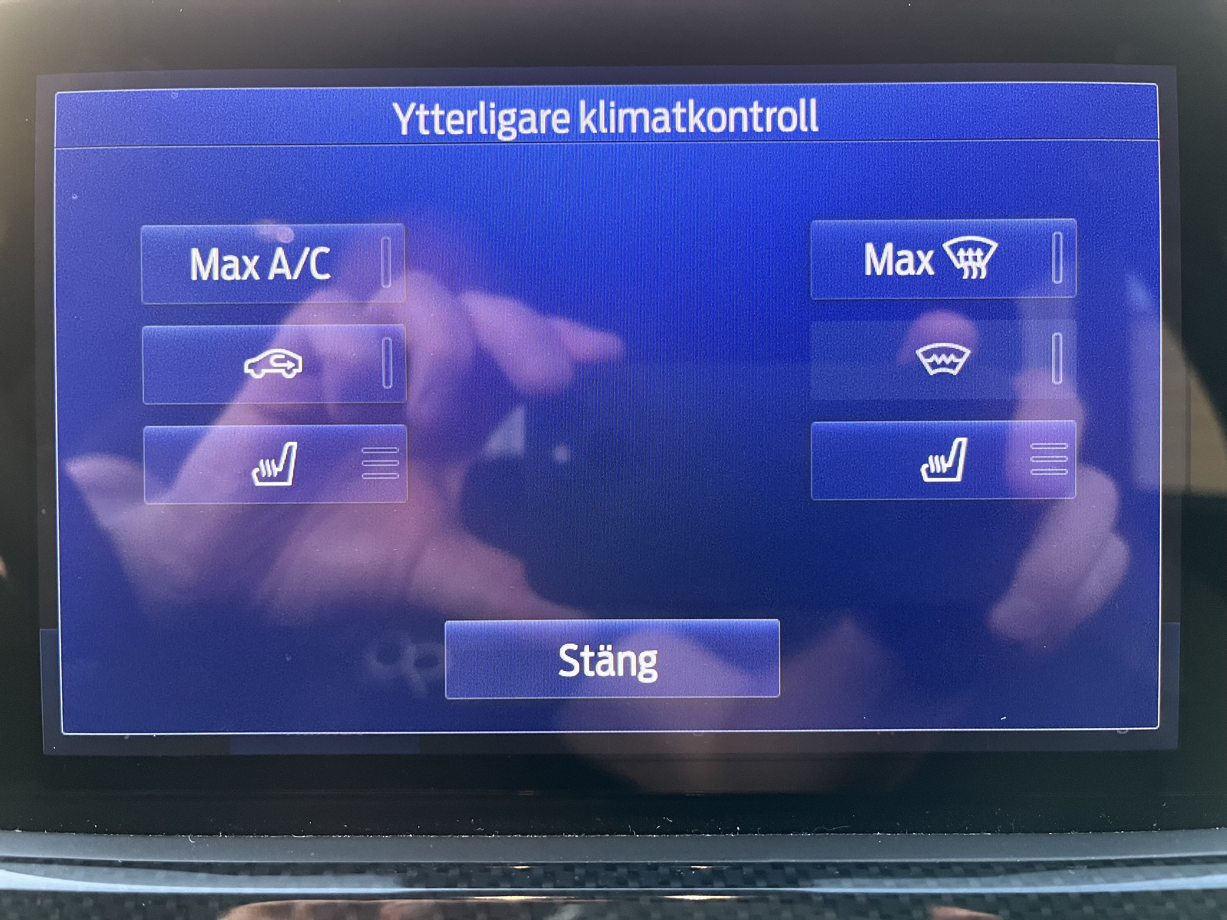

I added the heated steering wheel and heated seats icons to the home screen. Also activated the climate menu screen.
This works well. However these are added in the climate screen as well. Is there a way of selecting which buttons are placed in the main climate screen? Also having some not being seen? Or somehow moved into the extras menu?

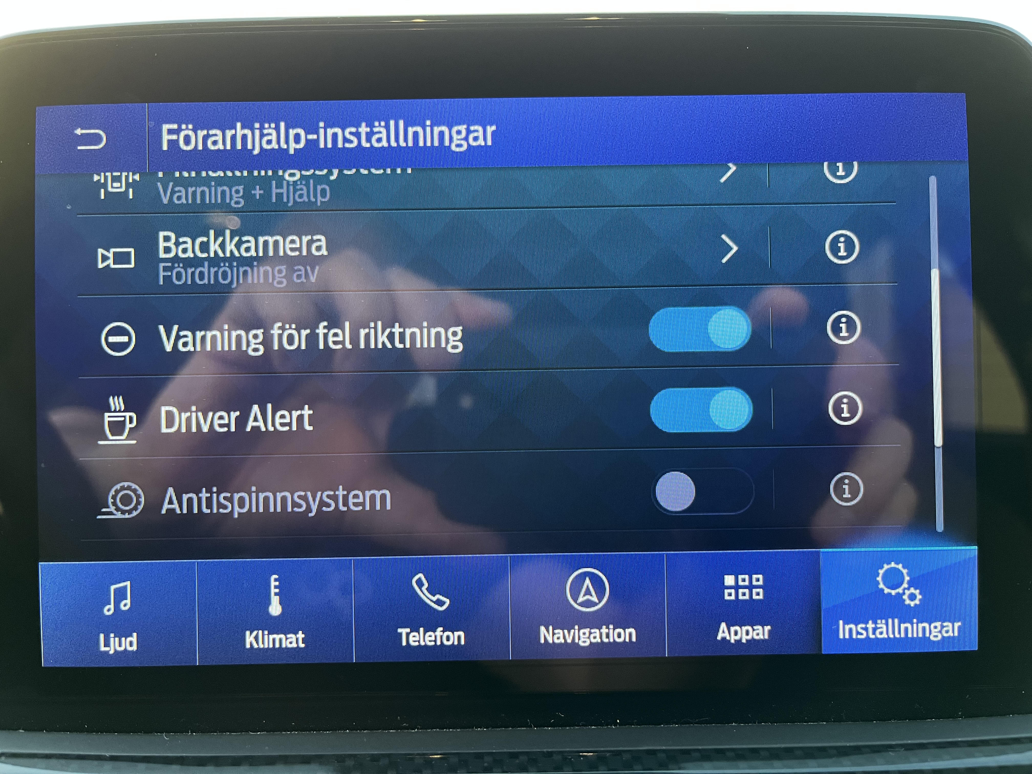

Also in my drivers aid menu I have ”Antispinn” but this option is greyed out.
I have not found a way in Forscan to either remove it or make it active.
Is this the same as TCS, the button I have in in the mid console?

Sadly, there is not a way to modify the screens.
This is likely a feature that is either not available in the vehicle or is not the same, or supported, as what is defined on the screen. This is likely TCS, but the TCS host system, likely the anti-lock brake module, does not support the communication with the APIM or Sync. It might be possible to upgrade the firmware in the ABS module to enable the communication, and control thru the APIM or Sync, but then it might require a completely different module. Just because the option appears on the Sync screen does not mean it can be enabled thru Sync.
Keep in mind that the vehicle must support the feature you see on the Sync screens. The menus in Sync will NOT add the features or functionality to the vehicle, this is just a control surface for existing features.

My guess is they’re talking about the non-AsBuilt config option in Forscan where it has the human readable options to change. For the OP: This is basically the same as the AsBuilt option for all intents and purposes so you have changed that. Rolling back to @F150Chief’s comment, if you changed settings related to the vehicle options you see on screen and are greyed out, it means the other modules in your vehicle in charge of said feature(s) don’t support Sync interacting with them.

Why I ask is because I have seen pictures of the climate menu that doesn’t look exactly as mine.
Not a biggie really, all options work fine.
Regarding the ”Antispinnsystem” I saw a couple of options that could have matched it. Called ”Advanced Traction” something, but they seemed to imply it was controlled elsewhere, like with a button.
Can any option turned off in the APIM settings turn it off on the physical button or to any other module? Or cause any problems with other modules? Maybe linked with another module?
When checking my Ford manual it does only mention the button on the mid console.
Why I want to remove or change this is because the option does not change with the real car settings. It’s always dimmed and off.

I don’t remember adding the Antispinn to my APIM settings. Although I have tried to add pretty much all other options for the drivers aid and car settings. Some have not worked in the SYNC screen so I have removed them. Although this option I can’t seem to find.
Probably something with ”Traction”…
Antispinn is available in my car. It’s controlled by a physical button.
I’m not really interested in changing anything major. If it can’t be controlled through SYNC then I would like to remove it from the menu.
This is what I have done with other options I have tried to add to SYNC that have behaved the same.
This option aludes me though.

Turned on all options in Forscan APIM regarding traction control and then off.
Restarted my car.
Now the ”Traction control” is gone from the drivers assistance menu.
Must have been some setting or memory that hadn’t been cleared.
It’s all good now.
Thanks for all inputs on the matter.
