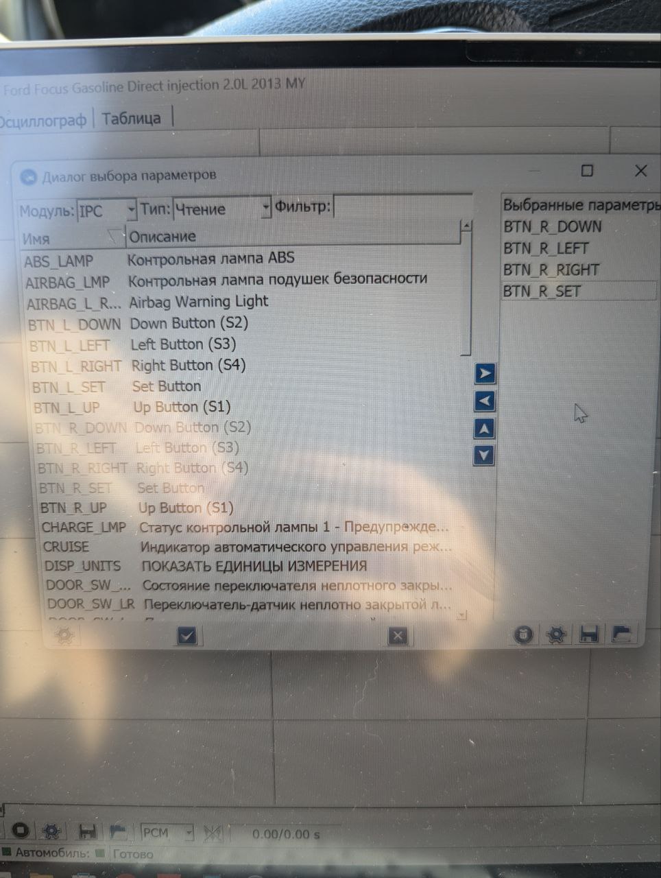

I have focus 3 USA 2013 year. I’ve upgraded sync 2 to 3 and now doesn’t work buttons what should answer call\ decline \ voice assistant. I tried to check parametres in asbuilt, but nothing helped. Buttons checked in forscan and they are works.

no. in forscan this buttons work, so module works as i think. I need to configure apim as i think

when I press button it shows pressed in forscan. For each button.
