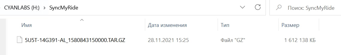

I want install russian voice package. I have 1.7gb free space. But voice file is very big (5U5T-14G391-AL_1580843150000.TAR.GZ).
So. i try resolve MEM_ERR03
