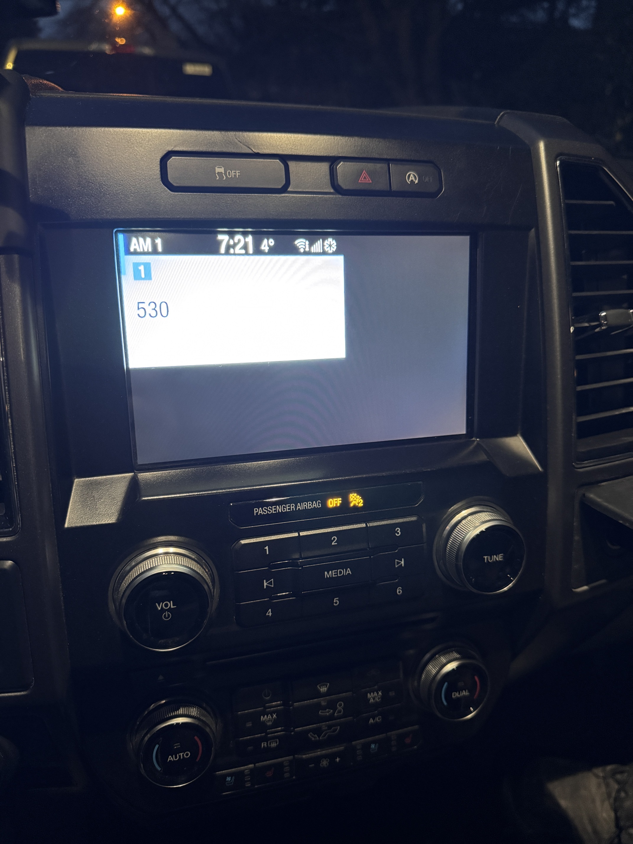

I purchased 2018 f150 XLT, and i wasn’t able to see the climate control on the touch screen i thought its a update issue, i updated through ford website with the truck vin number with usb.
After the update i don’t have touch screen anymore and got small screen on the left top corner.
I think the previous owner change the screen from 4” to 8” and the truck got the 4” version.

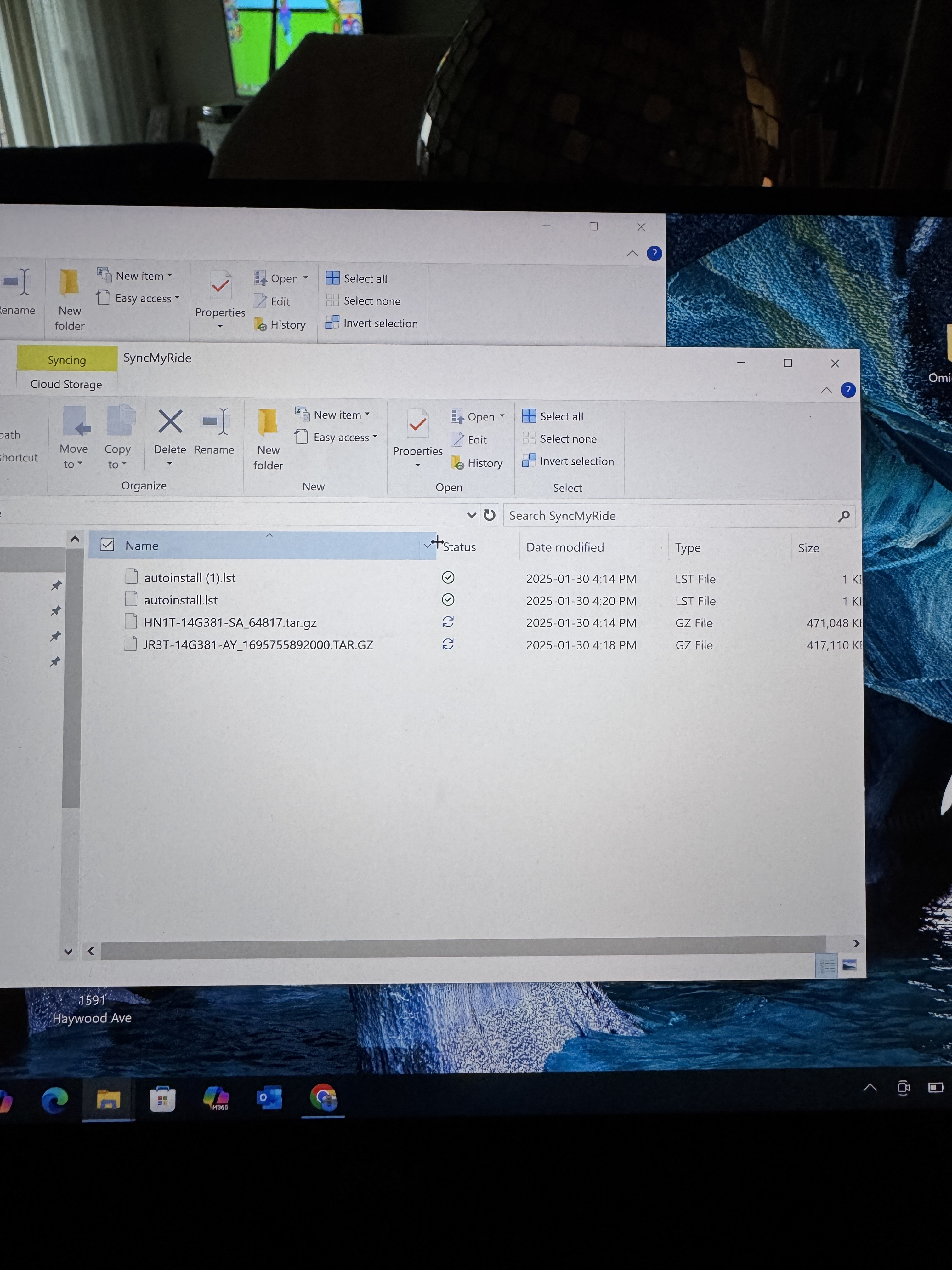

Just making sure autoinstall.lst(1) is correct?
Since you can’t have 2 files with the same name, you will have to perform one install, then rename the files to install the other package.
I thought telling you that Sync3 upgrades by reading the autoinstall.lst file was enough. I didn’t say “autoinstall.lst(1)” nor “any file starting with autoinstall*”… :wink:

ok i create a folder with name syncmyride and install the A and B in that folder.
after that part D and E I don’t get it the edit part.
how do I edit it ?

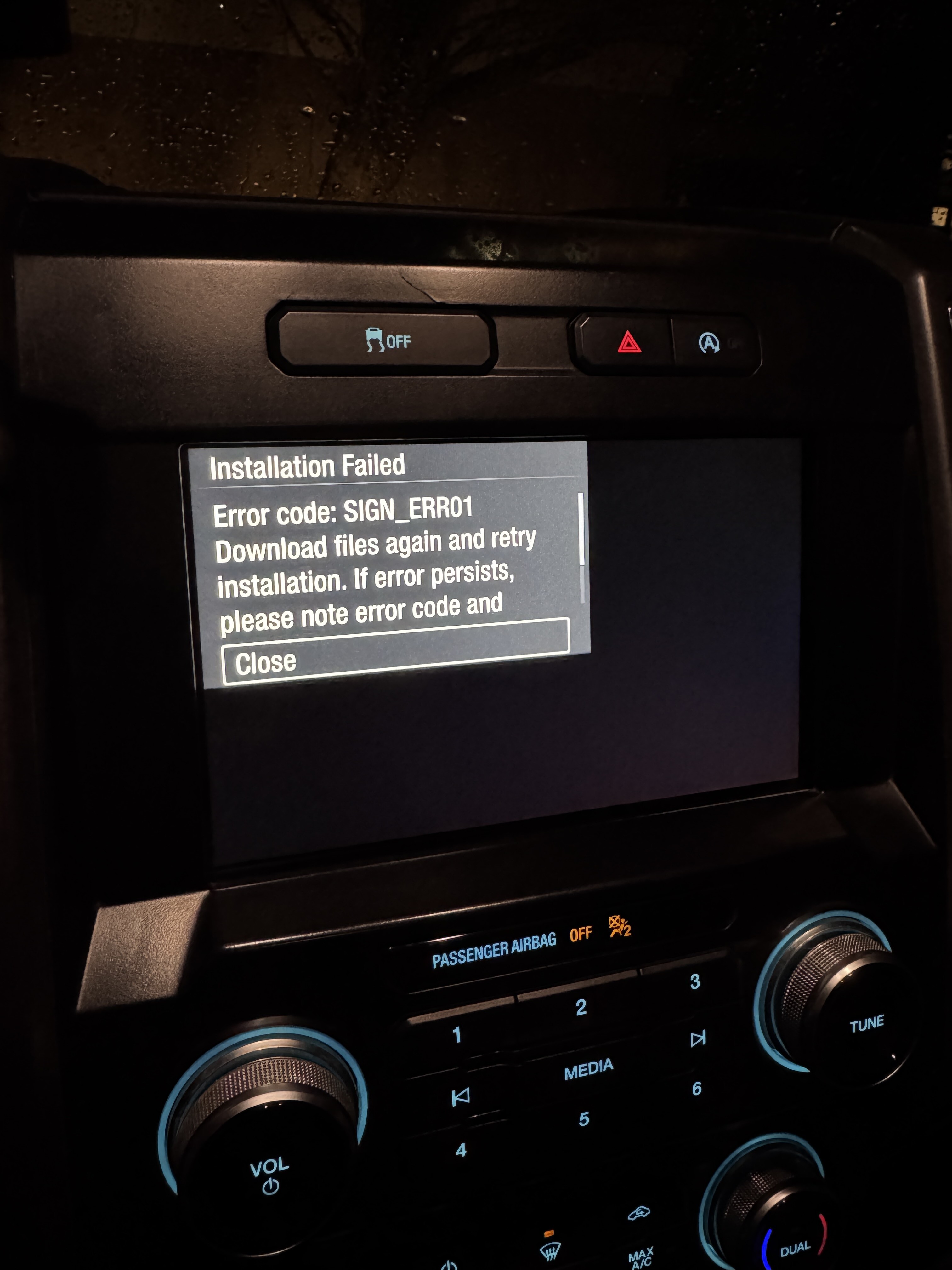

Doesn’t work
