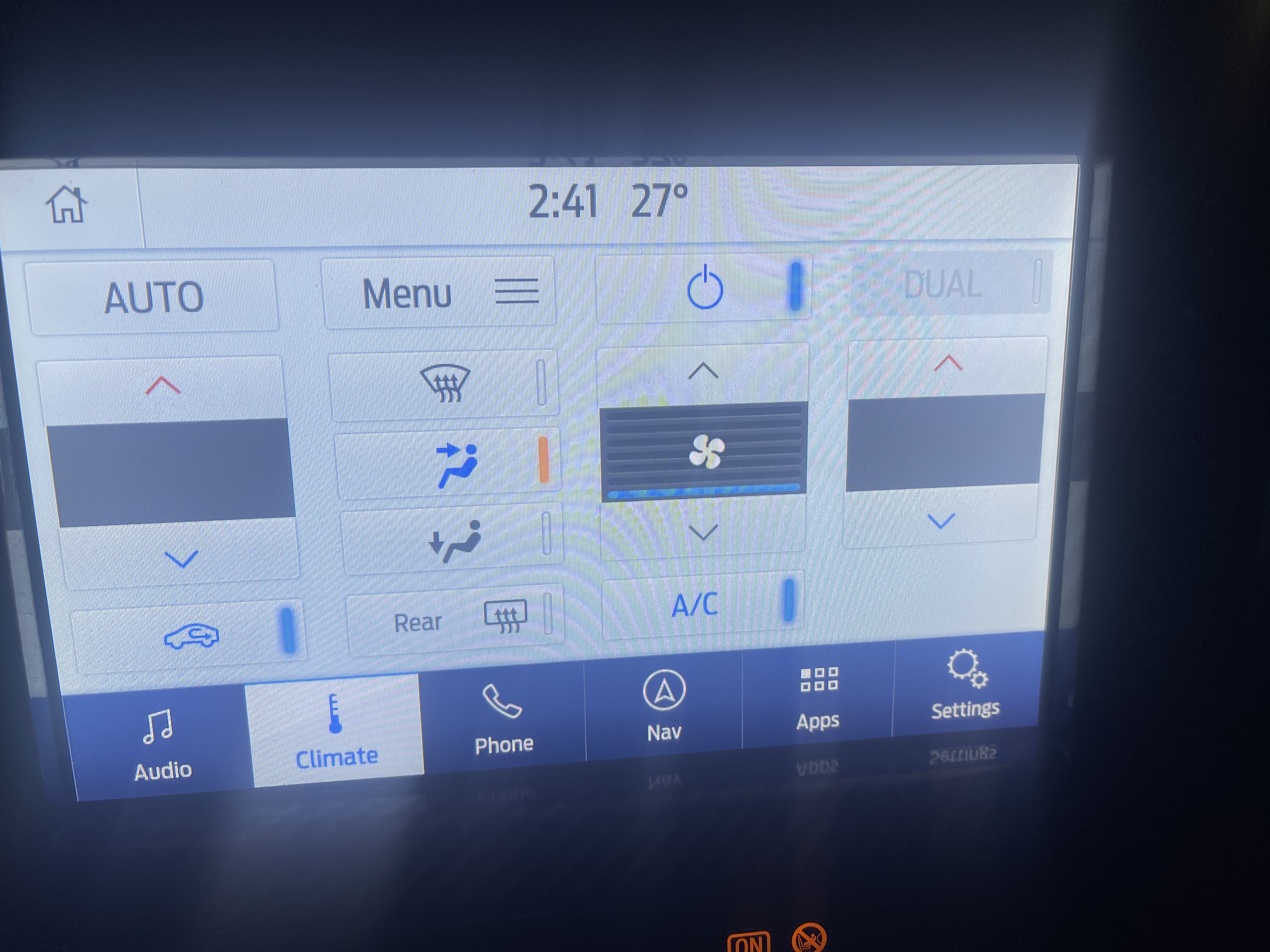

I have recently upgraded my F150 XLT 2015 to sync 3.4 with the latest software version. I enabled the climate on the screen as you see in the attached image but still can’t the temp buttons do not work and I also cannot control the fan speed from the screen as well. When I rotate the knob I get the fan speed indicator on the screen moving but there is no control of the temp even from the other knob or it changes without showing on the screen, something I do not know. I did enabled the single repeater thing as well as the temp and fan speed repeaters using forscan. Could you help? The vehicle had sync 2 installed before the upgrade.

Your XLT likely has manual climate controls…probably need to set the climate for single zone manual climate in the asbuilt.
You could look at the Sync 2 asbuilt to determine your climate settings, or post it here so we can look at it.
Thank you. Yes manual climate controls. What to do now?
Set the proper values in the APIM asbuilt using FORScan.
here is the pickup original as built data. Could you please show me exactly what to do cause I changed a lot of values and I want to start over
