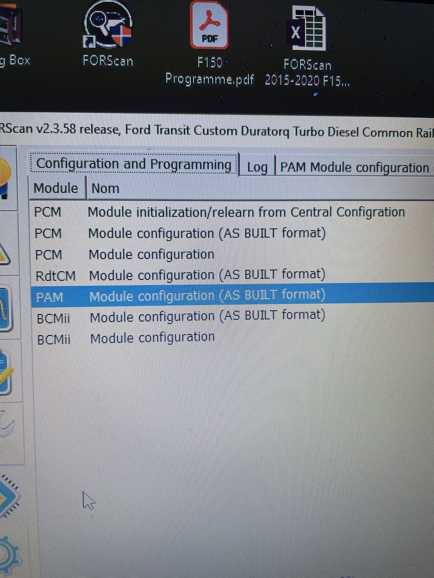

hello, I would like to enable the fader menu in a 2021 transit! would you have a solution? THANKS.
Do you have the software you need and a USB device?

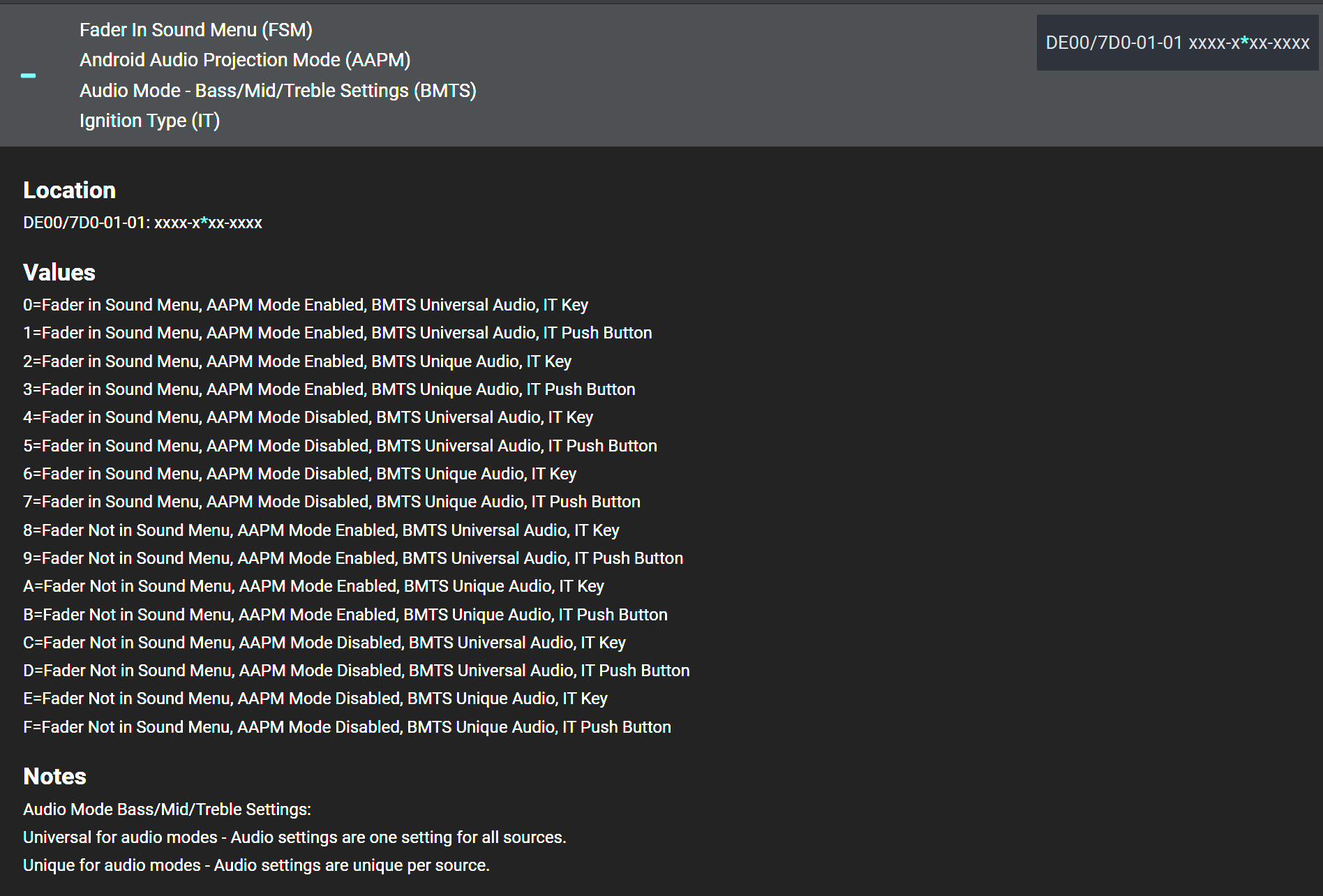

If you have ForSCan and a device look for “Fader in sound menu”
yes I have forscan and a usb device.
but I can’t find the procedure with forscan. fader does not appear in the sound menu
It’s right in the Database on here for Sync 3.

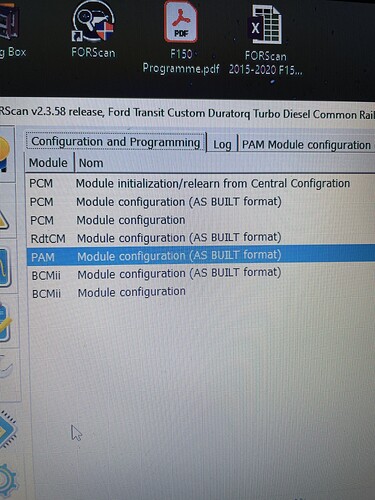

thank you for your speed but I can’t find it in the modules. I am attaching photos.
it’s good :+1::+1::+1:. THANKS
