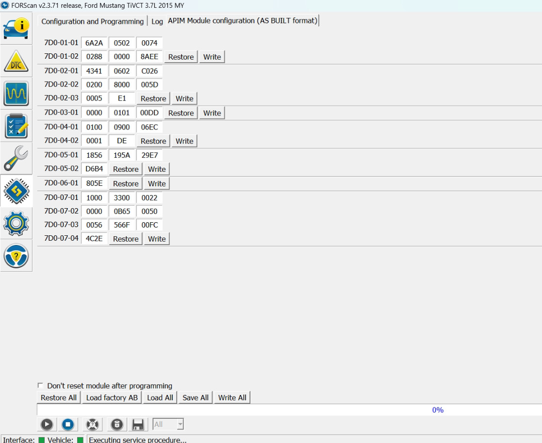

here is my apim as built data
So bluetooth for the phone, music or both?
Is this asbuilt data from the 4" Sync or other? It is mostly ok but the vehicle data in 7D0-05-xx thru 7D0-07-xx need to match your vehicle or the nav will not work properly.
Post you Sync 4" data.
Here is it

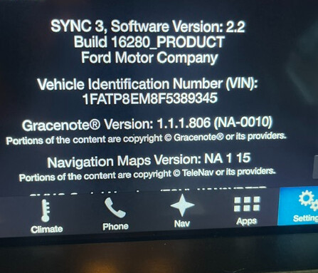

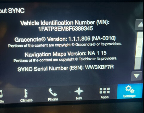

Also can you post a Pic of your about Sync screen so we can see the version information of the software on your Sync unit? You can redact any information you care about.
i did it but still no luck
here is the info you requested
Got a pic of the rest of the information on the screen?

Based on the VIN asbuilt info you did not have a 7D0 asbuilt. You need the asbuilt from a comparable 2016 Mustang with Sync 3.
