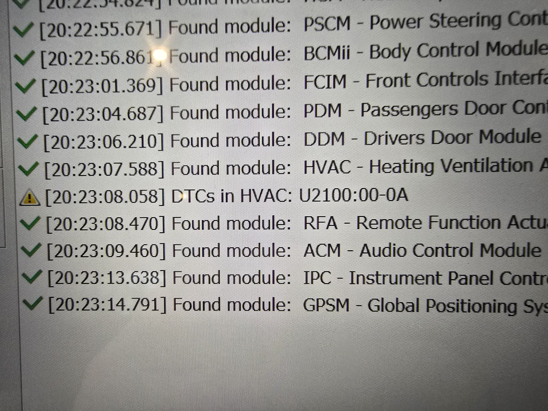

And have nav but when i click maps just black screen. Also screen fllickers a dawn n dusk ok in day or night
That is not related to Sync 3 directly but maybe someone made and adjustment to the HVAC when it was installed? It’s saying there is an incompatible or missing HVAC configuration. As far as the maps it might be the APIM asbuilt.
Run the Interrogator Utility in the Syn3 Updater and post the xml file here.
