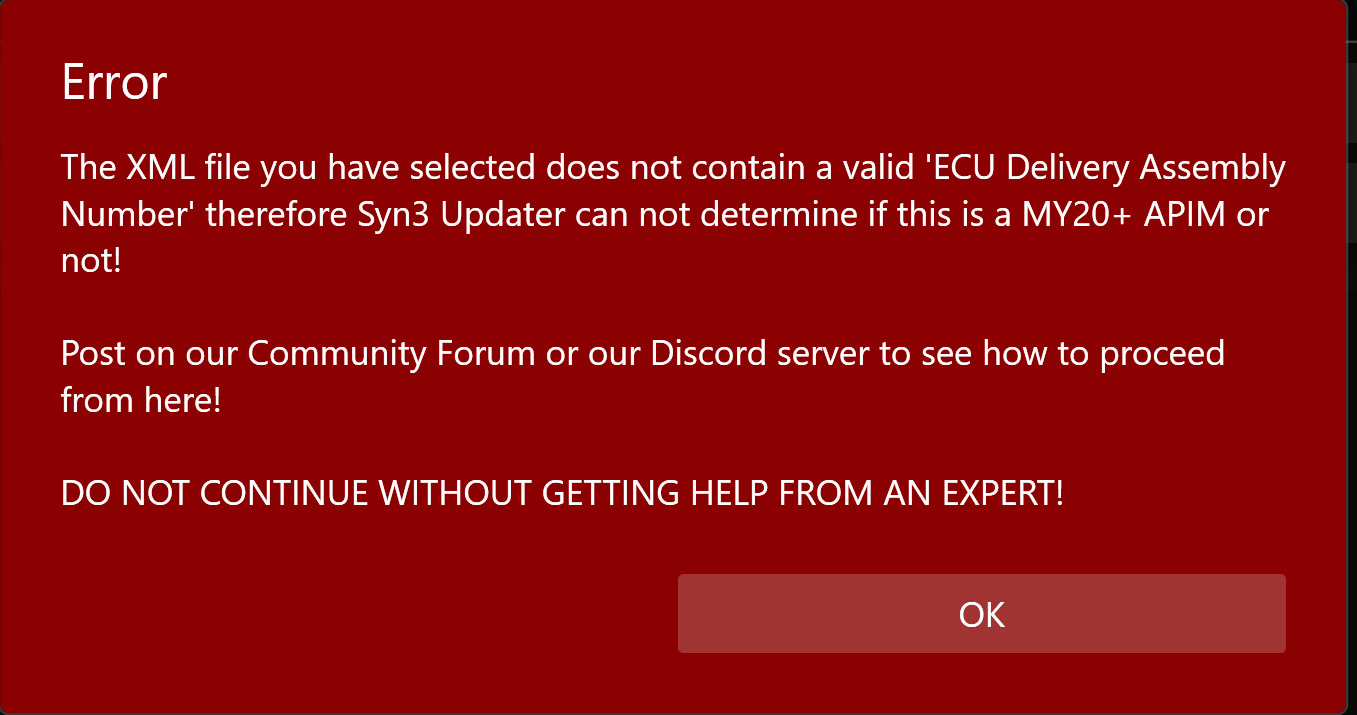

Im trying to upgrade my current Sync3 to latest version. Im currently in 3.4.22200 on a 2022 Scape Titanium HEV
When running the interrogator step, i get this error
You have a MY20+ APIM. DO NOT FORMAT. I would use the Ford route from their upgrade site. What are your trying to do that would require Cyanlabs? There is nothing to gain by going to 22251 IMO.
thanks to both.
i went the ford route and updated to latest recommended software which turned out to be 22251. With 22200 i used to have a very laggy interface but it now seems to be a little bit faster. Sync_W12T71T9_1FMCU9DZ0NUA46311.xml (10.7 KB)
