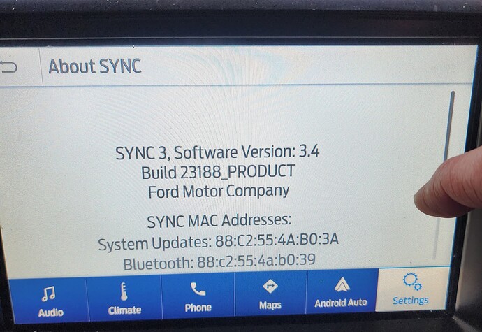

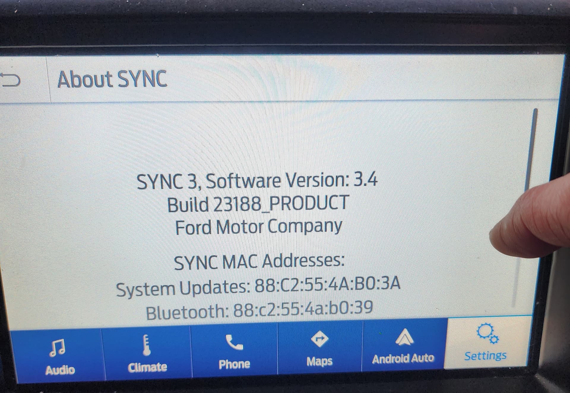

2016 ford flex sel. I updated to 3.4 two months ago, at one time i was able to connect via Bluetooth, now it no longer will connect that way. Is there a way to be able to connect again by bluetooth?
Other issue is error message occasionally says usb hub not supported, i click ok but i am still able to connect by usb. Can i update the hub to this HC3Z-19A387-B on amazon Amazon.com it looks like it should work, i wanted to check here first.
What version did you install?
The latest 3.0.23219
I was wrong about version, it is 3.4
