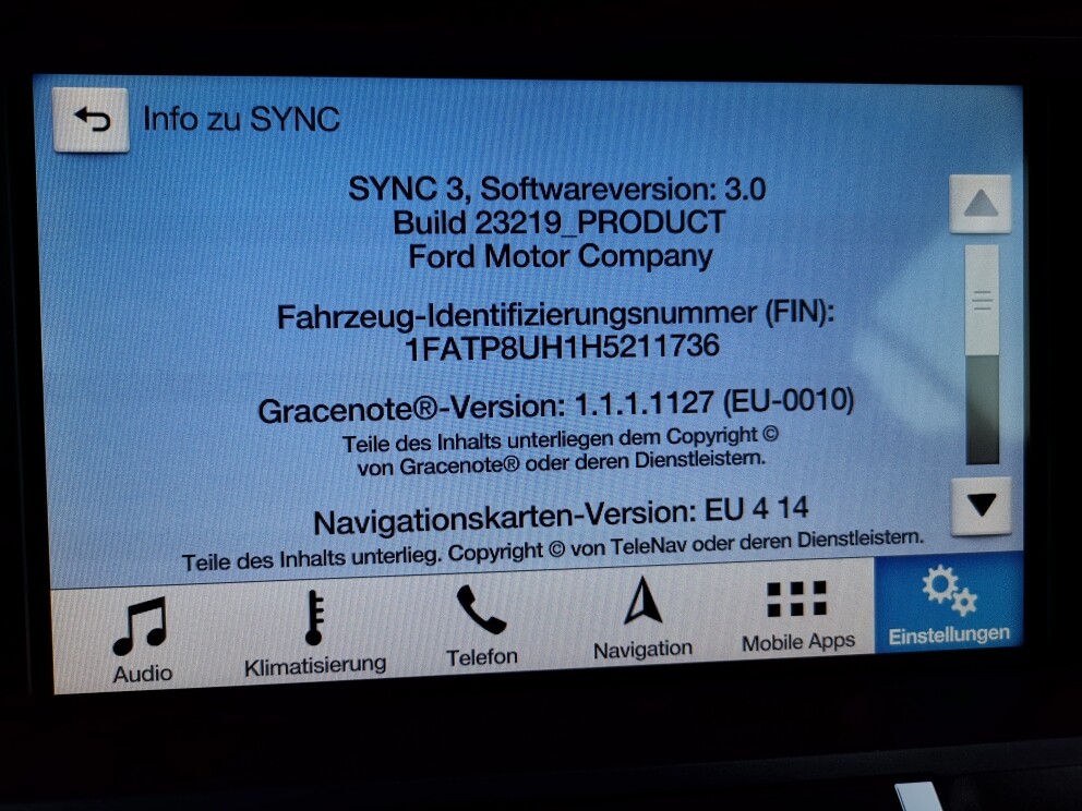

My 2017 EU Mustang convertible ecoboost has the latest software version Sync 3.0 built 23219, map version EU 4.14.

Which irritates me is that [SYNCGen3.0_3.0.20204] is displayed in the autoinstall.lst file, even though Sync 3.0 built 23219 is installed on my Mustang.

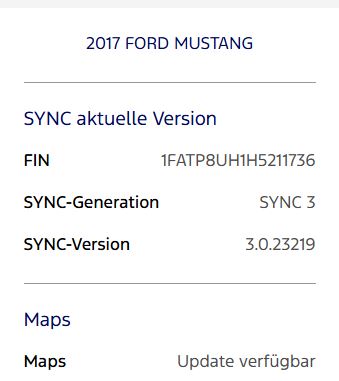

I downloaded the sync version 3.0.23219 with VIN information from the Ford website and successfully installed it in the Mustang, then uploaded the XML file. The website and the car show the current sync version as
3.0.23219. See screenshot.

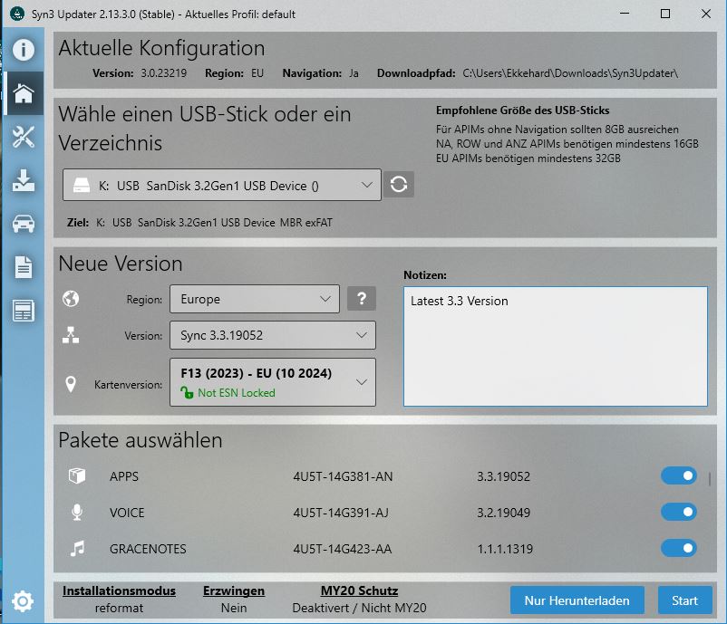

Wouldn’t it be easier and safer for me to use the Syn3 Updater and go to 3.3 - F12?
Attached is a screenshot of my preset configuration in the Syn3 Updater.

HB5T-14G371-FAG is NOT MY20+, so you could just use the Syn3 Updater. Just update to the latest Sync app and maps. You CAN use Sync 3.3 but keep in mind it is probably not optimized for the F13 maps. You MAY have issues with the voice control and directions.
