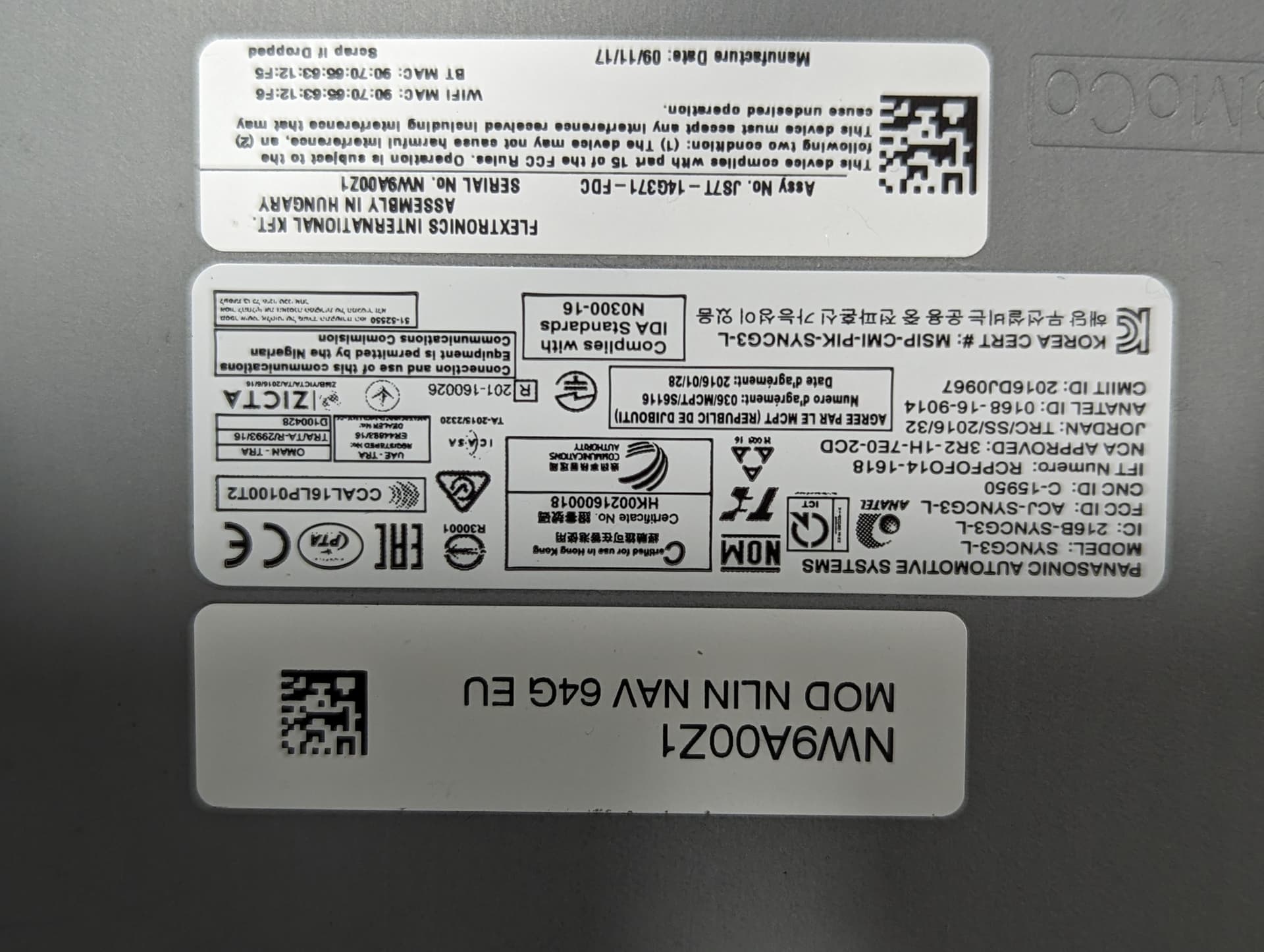

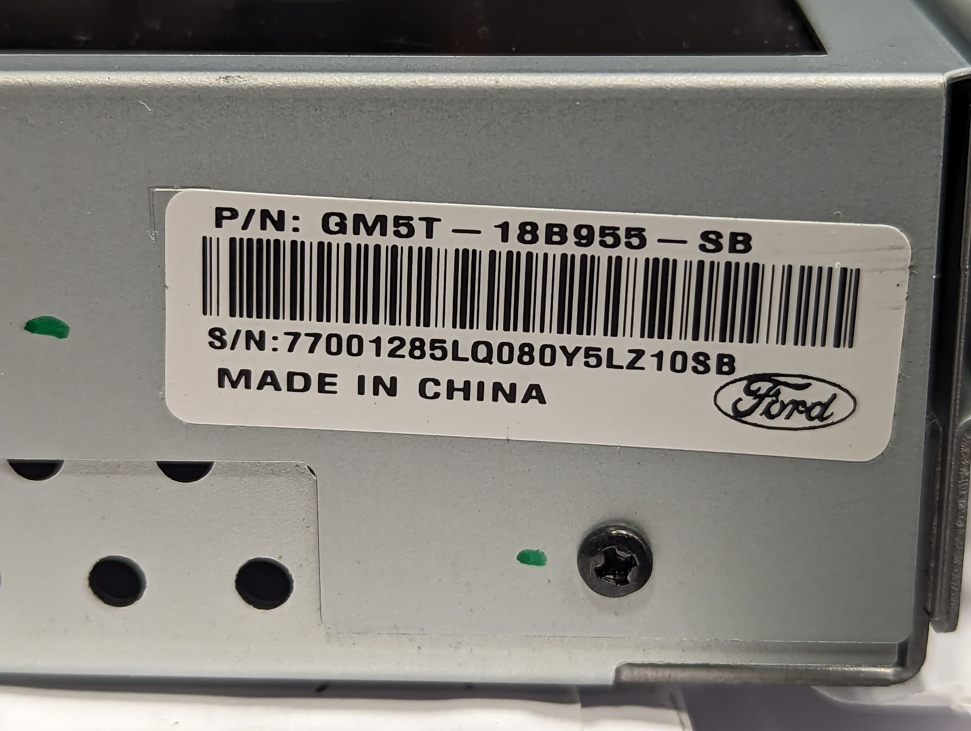

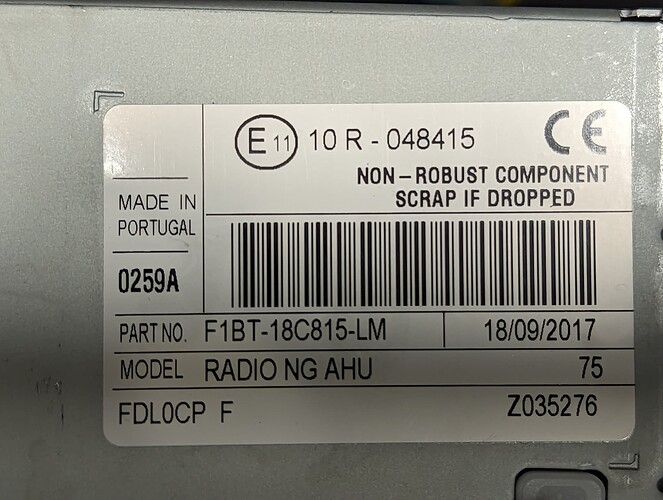

Hello.
Im not to sure which numb
er is correct to find in database. anyway i removed and made all pictures of stickers.
Hardware issue mean as damage electronic components on the board , software issue mean is is software corrupted are data corrupted .
Regards
Arek
Thank you for the pictures, the 2nd one is the APIM.
I do not recognize that APIM model, nor does our database. A quick search of that APIM on the forums does not return any results either, so I’m not sure what that is.
