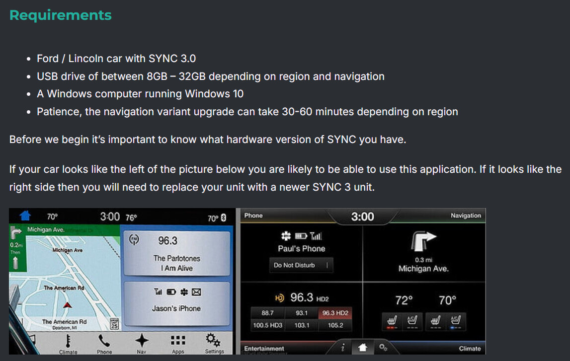

But from the documentation this is shown as supported/required hardware:
Those are 8 inches screens…
Also, the 4 inches users compared to 8 inches are really small…
