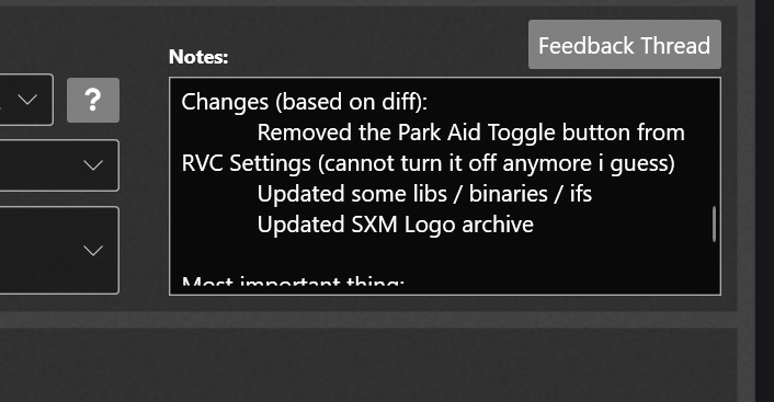

There is no list and Ford does not release what they updated. There are a couple differences that users found out and are noted in the version window of the update tool and that is it. Those are usually all that are known.

3.4.23188 & 3.0.23219 on the back end appear to be a leveling of things like the BT drivers.
And just like a PC a lot depends on the firmware/calibration loaded on the APIM, build of Sync3 and other modules in the car.
Depending on the vehicle/model year there are things that don’t work correctly when you put 3.4.x on a 3.0.x native APIM (eg the clock on non-NAV APIMS which requires 3.4.21265 if you want it to work).
