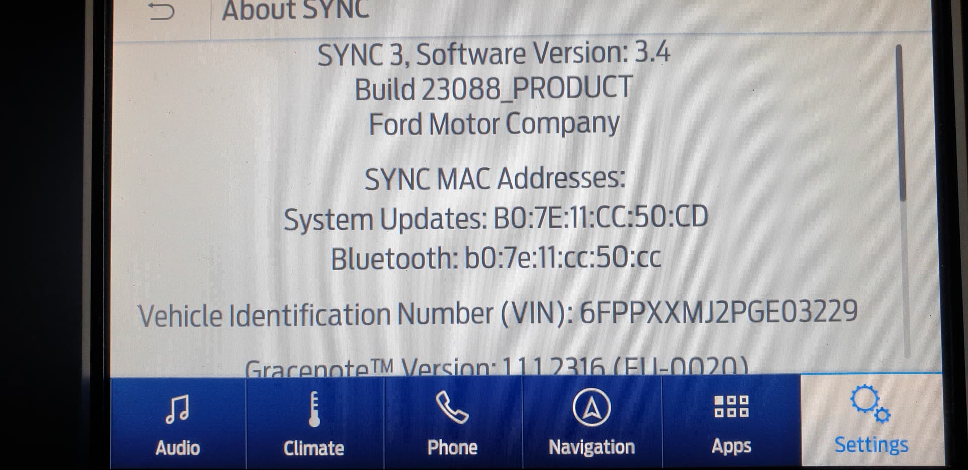

What model and year this was installed in?
Here is the specs
