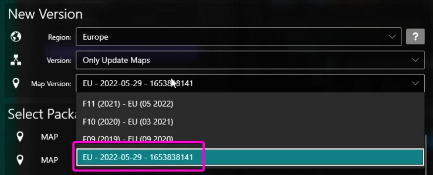

I followed the directions and did see where there was an option to pick full maps, or cut down maps but I will look at it again. I have attached a like to what I am looking at for map selections.
Again, I am not seeing where I can select full or partial maps in the selections.https://drive.google.com/file/d/1k742DMHTezP_C34iKSwtXZWYu1oMm5EU/view?usp=sharing
Dude sounds like a Dick if ya ask me Jeff.
Out of curiosity, what part of my message did you find rude?.
Step 2 of the cut down maps link I’ve sent:
It’s called “generator key” now, since this used to be a paid feature but now it’s free.
Clear that value up, I do not know why you have a value there.
Alternatively, just do not select that option from the maps dropdown but the desired normal full NA Maps as shown in step 3:
