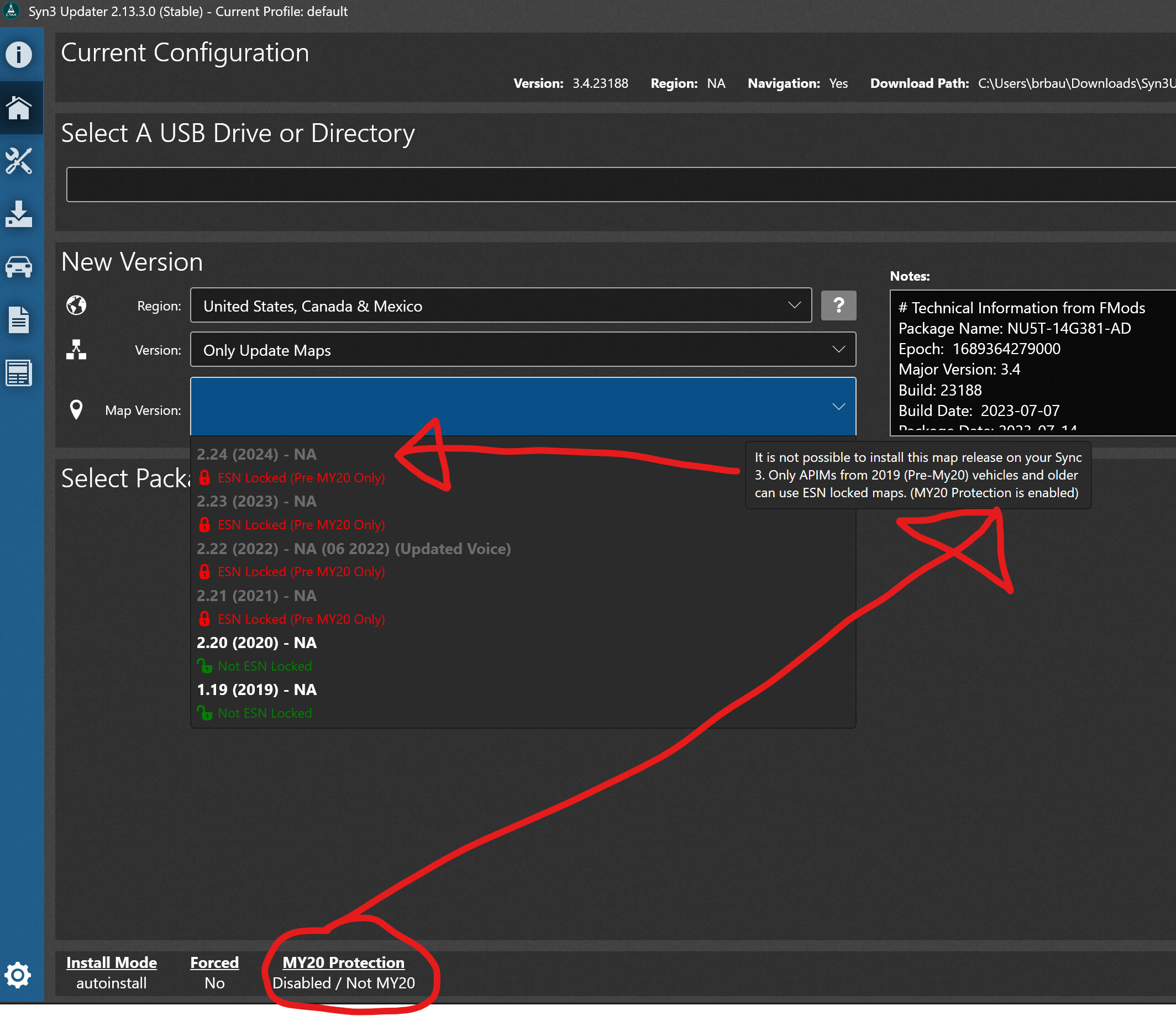

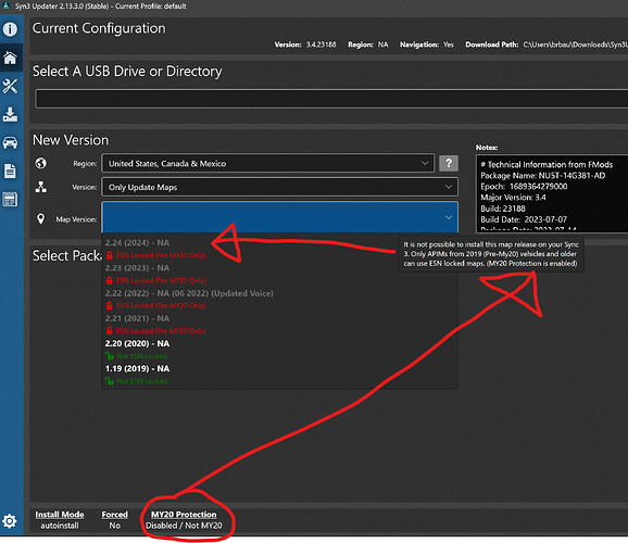

I’m trying to create a Map Update Only USB for this release and it is locked out due to the My20 Lock. I have this disabled and have tried restarting the program - still getting the same results.
This requires a reformat.
You can’t just do a map update.

if maps are esn locked reformat or jailbreak is the only way, that wording could probably be made a bit clearer though
Okay, so it is locked for everyone, even those of us rolling in a pre-My20 system. Have a 2016 F150 with 3.4.23188. Guess I will sit tight until it gets unlocked
Thanks for all the work and effort you all do for us
Or you just can reformat the unit and install them like any other ESN locked map in the past…
NA maps need to be licensed unless you install them via reformat. There is no other ‘practical’ way.
