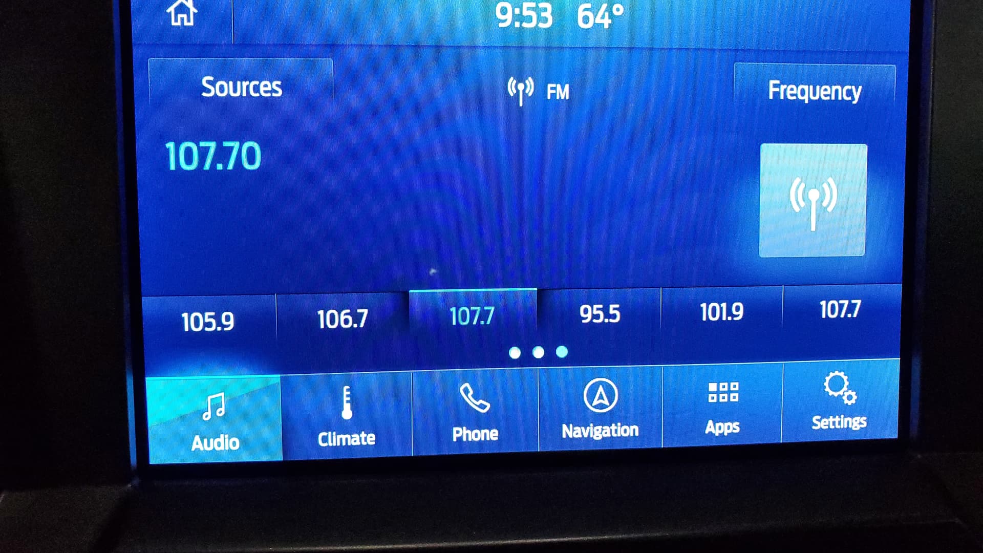

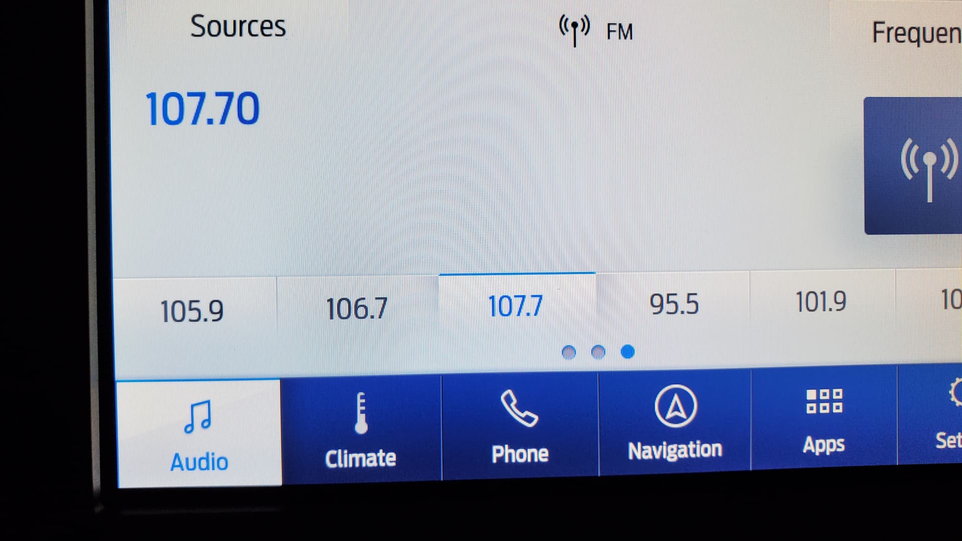

Recently after the map update I noticed the tabs On my API m screen have a diagonal line where the top side Is light shaded and the bottom half is darker shaded. I tried a couple of master resets with no luck. Has anyone else experienced this after the map update Or have a possible remedy?
Thank you in advance..
