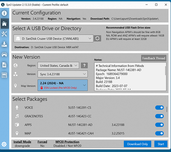

I did purchase the map update from Ford’s website and downloaded the files along with the license, unfortunately I can’t update my maps because the error message says that Sync software is not compatible even though i’m on 3.4 build 23188. I reached out to Ford and they are showing that i should be on sync 3.0 build 23219. Any suggestions?
That would be because the map package was built by Ford for 3.0.23219.
As soon as you reformatted the APIM to go to 3.4.x you went into an unsupported configuration.
Can you post the autoinstall.lst so that we can see what is in the package.
Here is the file attached.
autoinstall.lst (781 Bytes)
Sync 3.0 maps…not compatible. You can update to the most recent using the Syn3 Updater.
Is it correct then that the install method would show downgrade even though it is the same build number, or do I need to make a change elsewhere? TIA
Yes, you need to downgrade to Sync 3.3 to run the reformat tool. The installation will take about 35 minutes altogether.
Read the Installation Instructions section of the attached to give you an idea of the process.
Current EU Maps Installation on US Imported Vehicles - Ford / Guides - CyanLabs Official Community

Back in 2022, I used CyanLabs to upgrade my 2018 F150 from Sync3.0 to 3.4 (which would have inevitably required a reformat if I remember correctly?) So, my question is, can I now use Cyanlabs to upgrade my maps to the new NA2024 ESN locked version? Will I require another reformat, or was the initial reformat sufficient? I am obviously worried about bricking my APM.
You can and it will require a format again for US maps. They are all ESN locked for the US so it requires a format for that reason.
Excuse my ignorance. How do I force a format when I am already on Sync3.4?
You don’t, you downgrade and then reformat. DO NOT force anything in the app.
So which version should I safely downgrade to in order to make it format the apim?
If you set up the Syn3 Updater with your present version and region and nav or not, leave it in auto-detect mode, the app will decide for you. It should choose downgrade and then reformat for the map upgrade.
Worked like a charm. Thank you Bill32399 and F150Chief!
