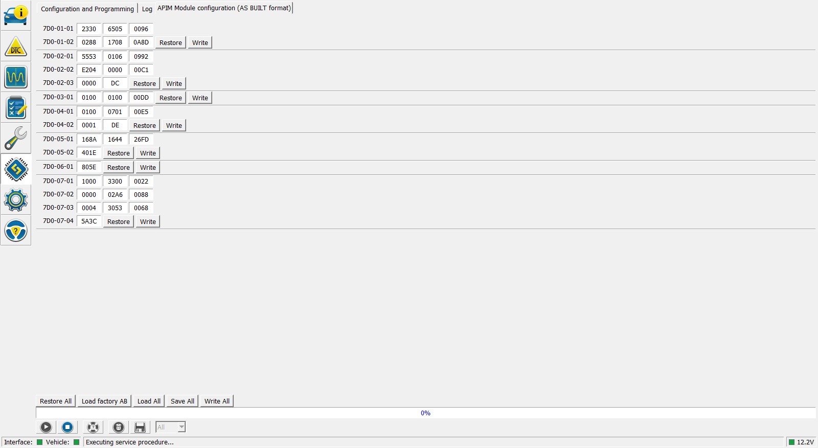

I just did a Sync 1 to Sync 3 upgrade in my 2017 Fiesta. The unit I installed came out of a '16 Fiesta that, when I installed it, had software version 2.2 build 16280, gracenote 1.1.1 806 (NA-0010), maps version NA 1 14. I upgraded to 3.4, build 23188, gracenote 1.1.1,2323 (NA-0020), maps version NA 2 23.
If, when I first get in the car, I turn on the ignition, but dont start the car, I will get a pop up thats says “Navigation Fault. Navigation is not functioning properly. Please visit you dealer for service.” I have to close this pop up and everything works fine.
If, when I first get in the car, I just start it, the maps will pop up with a little yellow hazard sign that says “navigation fault.” for a couple of seconds, then it just starts working fine.
Old SYNC Version: 2.2.16280
