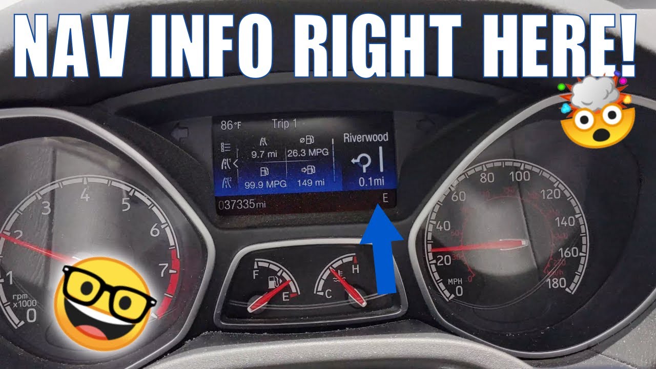

My IPC looks like this:
Is this possible to do or I am missing something?
Will IPC firmware update fix this for me?
Also one question, if I make firmware update will settings be reset or will stay with current values?
my 2015 Ford Focus had it but that IPC is not the same as that, the display on your one is horrible resolution and very low quality compared to the Ford focus Mk3 one.
