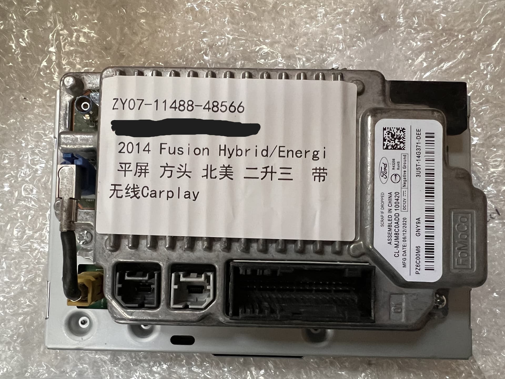

Brand new here and been reading over the forms a bit. Just purchased a Sync 3 kit from eBay and wanted to make sure I am good before trying to update the unit. It’s on version 3.4.21020. Looking to get it to the latest. It shows a build date of 06/12/2020 and model is 3U5T-14G371-DEE. Assembled in China. I see a bunch of comments about MY20+ and how it changes updating so concerned about the build date before I upgrade anything. Thanks!

Hello.
Take a photo of the sticker on its back and share it with us.
That model number is not known to our DB, and since it says it was made in China, this may be a red flag.
Anyways, keep MY20 protection active.
If it’s MY20 you can’t reformat it, that’s about it.
Thanks.
Well… If I have to judge that APIM based on the sticker, I would say it’s not OEM / original… It may or may not be, but based on the sticker, I have my doubts.
Also, the APIM model listed there is not know to our SYNC 3 APIM Hardware Database - CyanLabs , so you are the first one to come by that model (if genuine, of course)…

Well, that makes sense… It’s a HP5T-14G371-CCA APIM with a fake sticker on its back.
HP5T-14G371-CCA is documented in our DB, and it’s not MY20.
It’s running current versions so upgrading should not be a top priority for you, maybe in the future.
Now, are you safe if you decide to reformat it in the future?, it’s hard to say.
Based on the APIM’s model I would say YES, but since the unit has been tampered with (at least the sticker was forged), I cannot assure that…

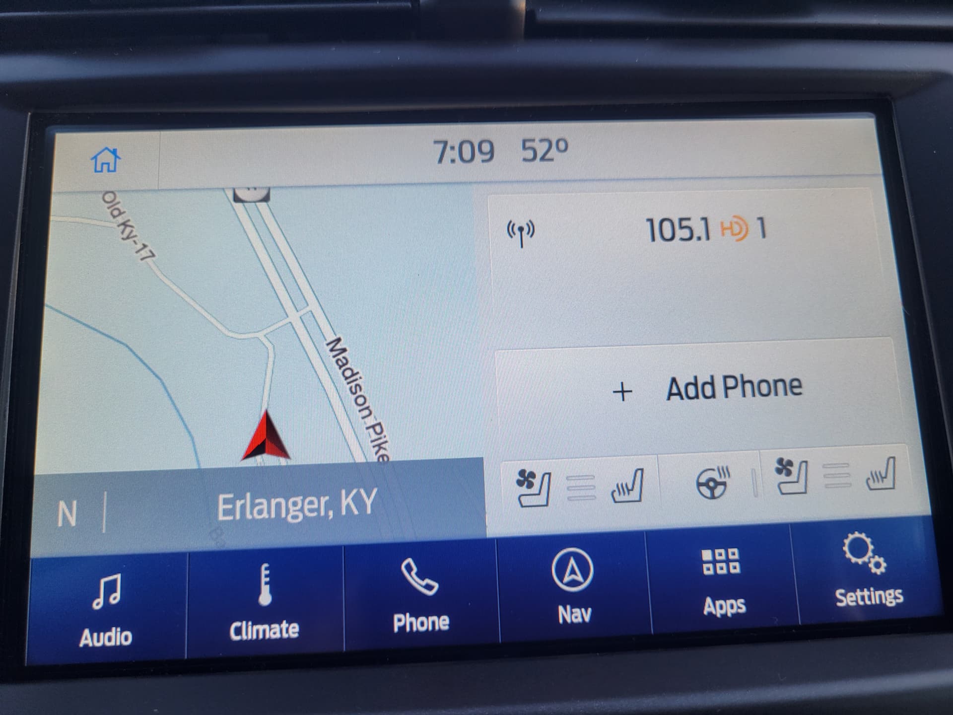

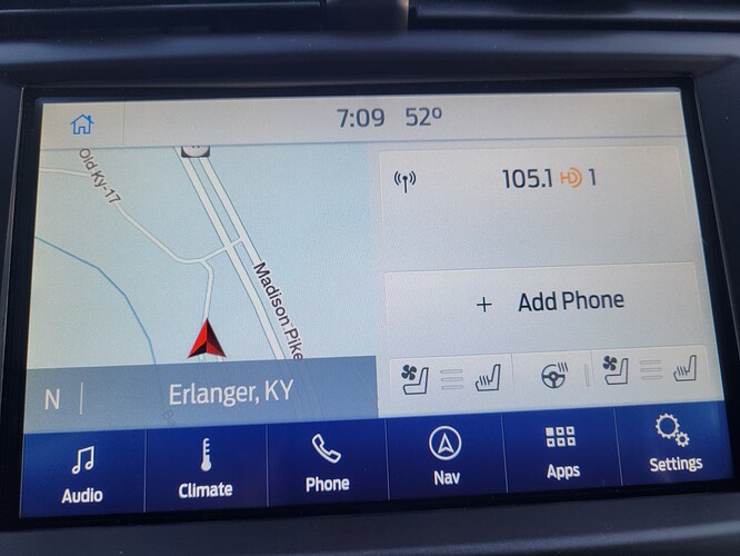

I don’t have my SE any longer, here is a pic of the screen from my 2018 Platinum Hybrid with the powerflow removed, heated/cooled seats and heated steering wheel.
I have a Titanium with Sony stereo. That picture is exactly what I want. Just don’t have the heated steering wheel.
