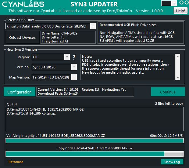

trying to put new update 3.4.20196/ maps 1.19 onto usb stick, it starts downloading and freezes roughly a quarter of the way through. is there a fix, or am i doing something wrong?

I have installed the new version of Syn3 Updater 1.0.0.2.
I used another computer with Windows 10 and everything was downloaded and installed on a DataTravel 32GB pendrive. I will test it on Windows 7 and let me know.
I tested it on a computer with clean windows 7 and there is also a problem. The recording of the pendrive stops. On a computer in Windows 10, there is no problem on the pen drive and SD card.
