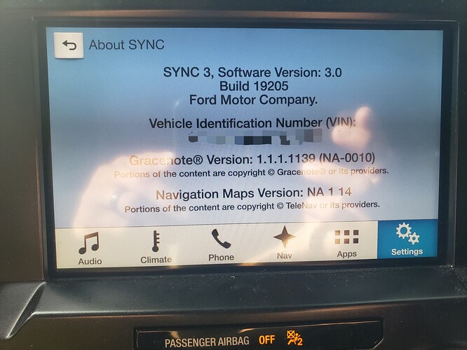

Good morning everyone. I’m new to the forum. I bought a 2016 f150 Lariat and Sync3 was never updated as far as I could tell. It was version 1. I tried to do the USB update through Ford’s website and it failed “The installation has run out of space or does not work with this version”. I turned on auto updates and connected to WiFi. That successfully updated my system to version 3 build 19205. However when I plug in my USB to my Samsung Galaxy S9+ it charges and I can play audio through the USB as a source, but I have no option to run Android Auto. After doing a bunch of reading I think I skipped the version 2 update that included Android Auto. I found a post on here that talked about how to install that version through CyanLabs, but I can’t seem to get USB updates to work properly. I always get the message “The installation has run out of space or does not work with this version”. If someone could help me out I would really appreciate it as this has been frustrating. For the record I don’t care about apple car play. I just want Android Auto.

Master reset did not fix the issue. After running the interrogator I got a red error message. “The XML file you have selected does not contain the expected output. Syn3 Updater has determined you are on 3.0.19205 and may be using overlays. Syn3 Updater is unable to determine the configuration of your APIM. Request assistance on forum.” XML attached.

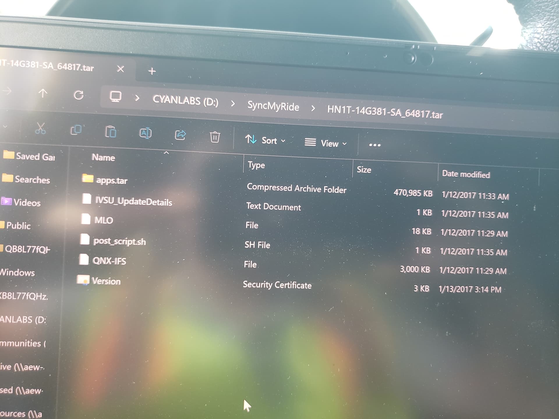

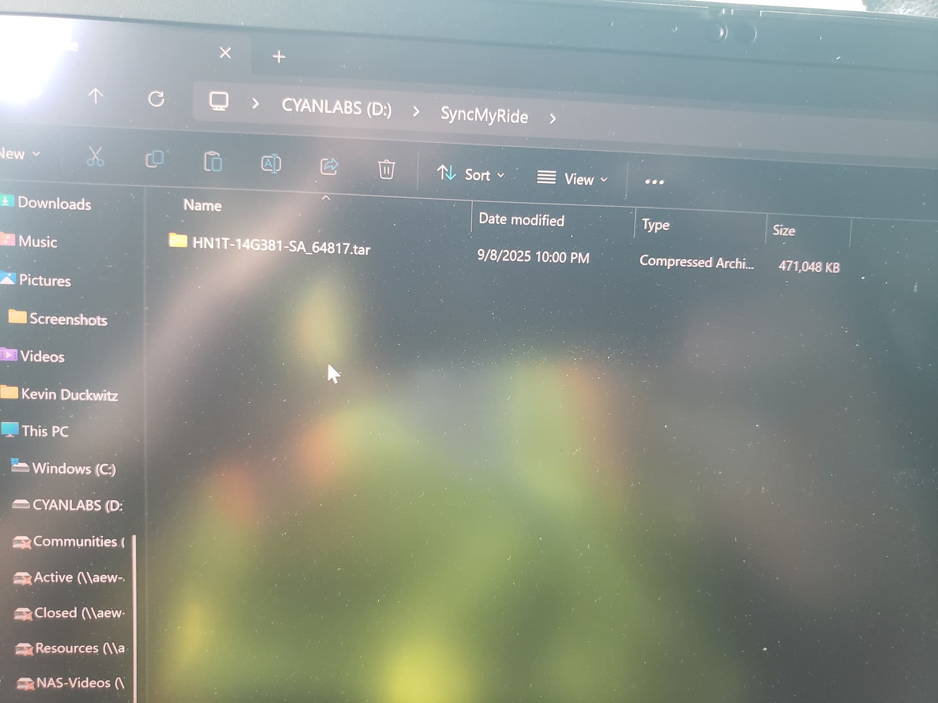

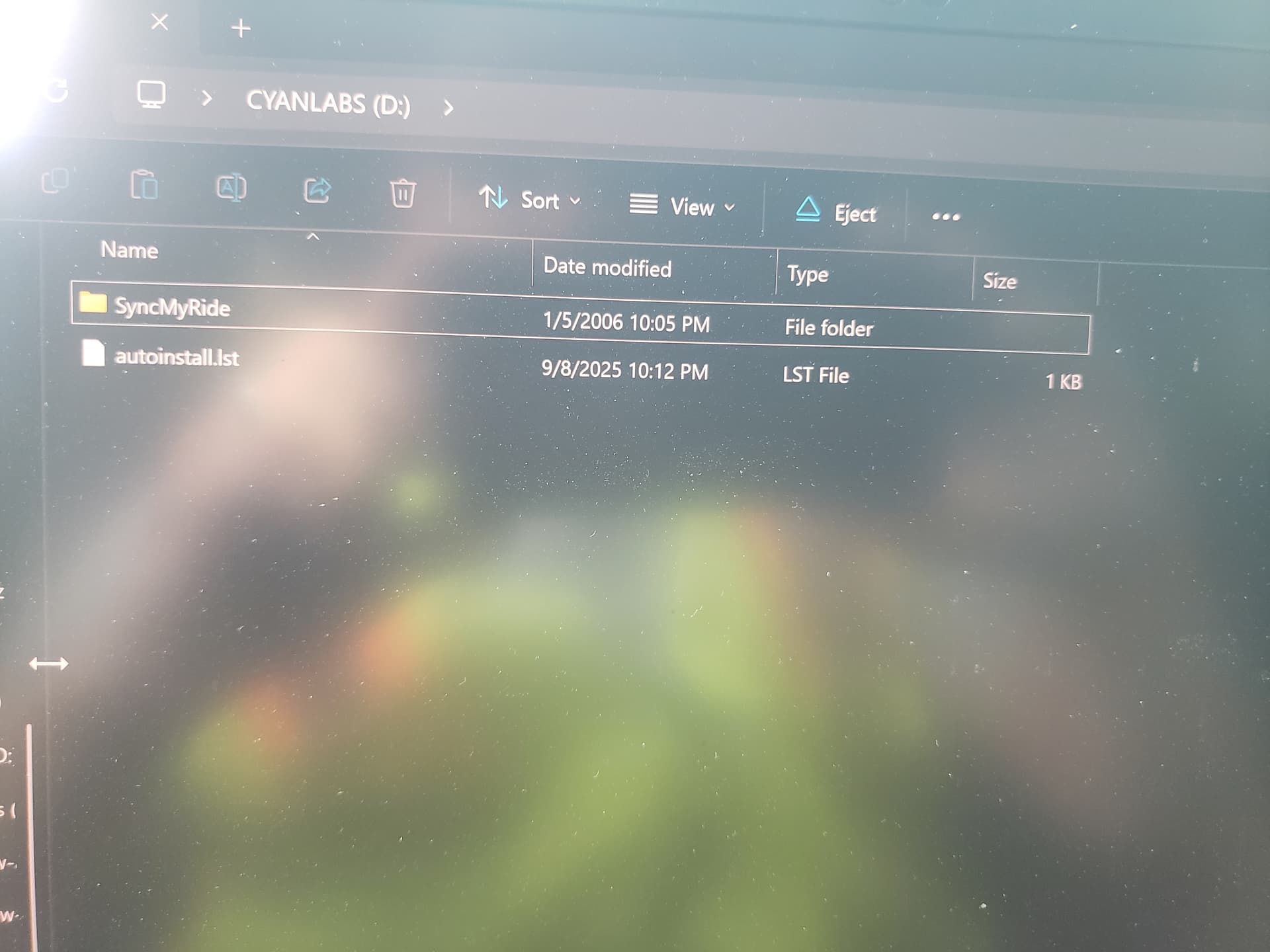

That is the post I was following when I tried installing version 2.217xxx but got this message “The installation has run out of space or does not work with this version”. Pics of the USB that I set up, maybe you’ll see something that I did wrong.

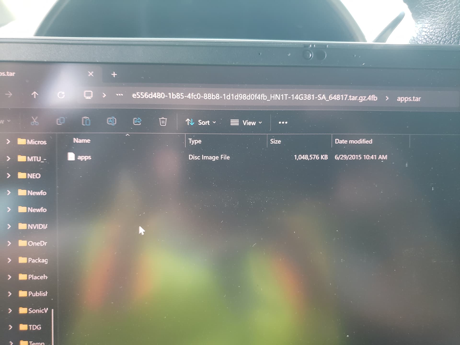

Do not uncompress the .gz zip file.
Good catch, but I do not think he did… I think windows is just not showing the extension… But he should confirm this…
I didn’t do anything to the gz file. Only edited the lst to add “; 2.2.17011 install”
Finally got around to doing the master reset and trying the 2.2 install again, same installation failed message :face_with_symbols_on_mouth:
The root of the USB shows the autoinstall.lst file with extension but the tar archive does not show the .gz extention on the same drive. Your autoinstall file calls for the file with the .gz extention. Make sure this is correct.
This could be due to windows’ configuration: if I remember correctly, Windows hides known extensions by default, but shows the one that are not know to it. Of course the user can change that for it to always show extensions.
Either way, if he created the USB with Syn3Updater and didn’t modify anything, this is not an USB creation issue.
