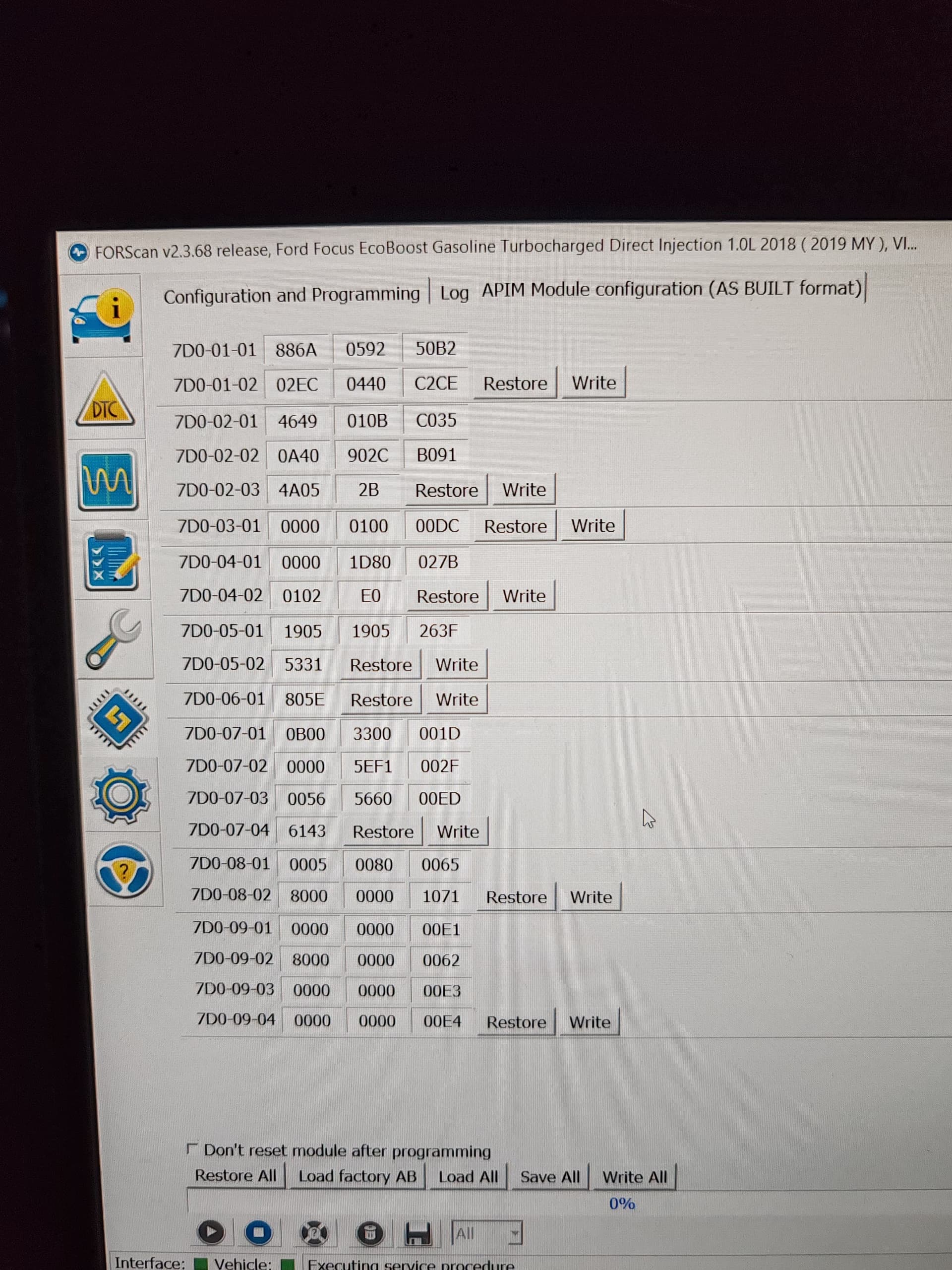

I went to check the AsBuilt data present in the APIM using Forscan (It was hard for me to understand the format collected by the interrogator). I compared it with the original AsBuilt data from Motorcraft. I realized that the previous owner probably messed with the configuration especially the branding when he was trying to change the theme. Anyways, It should be strictly mentioned Ford if it is a Ford brand. like here : DE00/7D0-01-02: *xxx-xxxx-xxxx, it should be 0 (B Ford, Not a Hybrid (HEV) Vehicle, USBOSTD Enabled) in my case (it was C before : B Configurable SplashScreen, Not a Hybrid (HEV) Vehicle, USBOSTD Enabled). https://cyanlabs.net/asbuilt-db/sync3-apim/?search=Brand%2520Identification%2520(B)
Also, because my APIM was at the last version of 3.4, keeping DE02/7D0-03-01: xxxx-**xx-xxxx to 01 (01=Obsolete (Old Ford Timeless, in 3.4 sets Ford MY20 theme with custom Boot Screen)) automatically used new blue theme Ford MY20, so I was wrong, keeping asBuilt 00 or 01 for 3.4 APIM will automatically set Ford MY20 theme and even I changed DE01/7D0-02-01: xxxx-**xx-xxxx to 16 for ST line, it did nothing, it kept stock splash screen. (01 was kept in my AsBuilt).

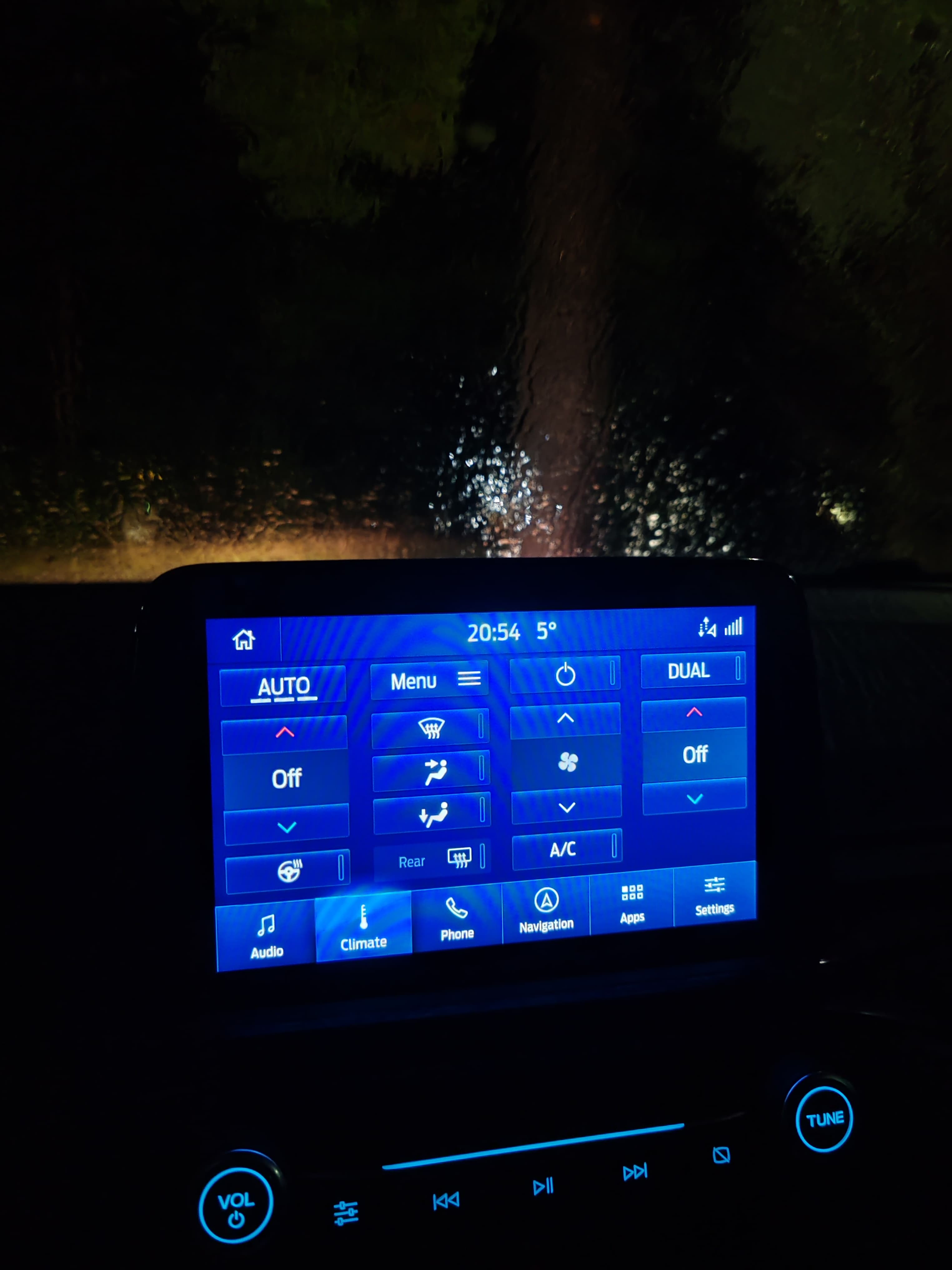

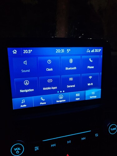

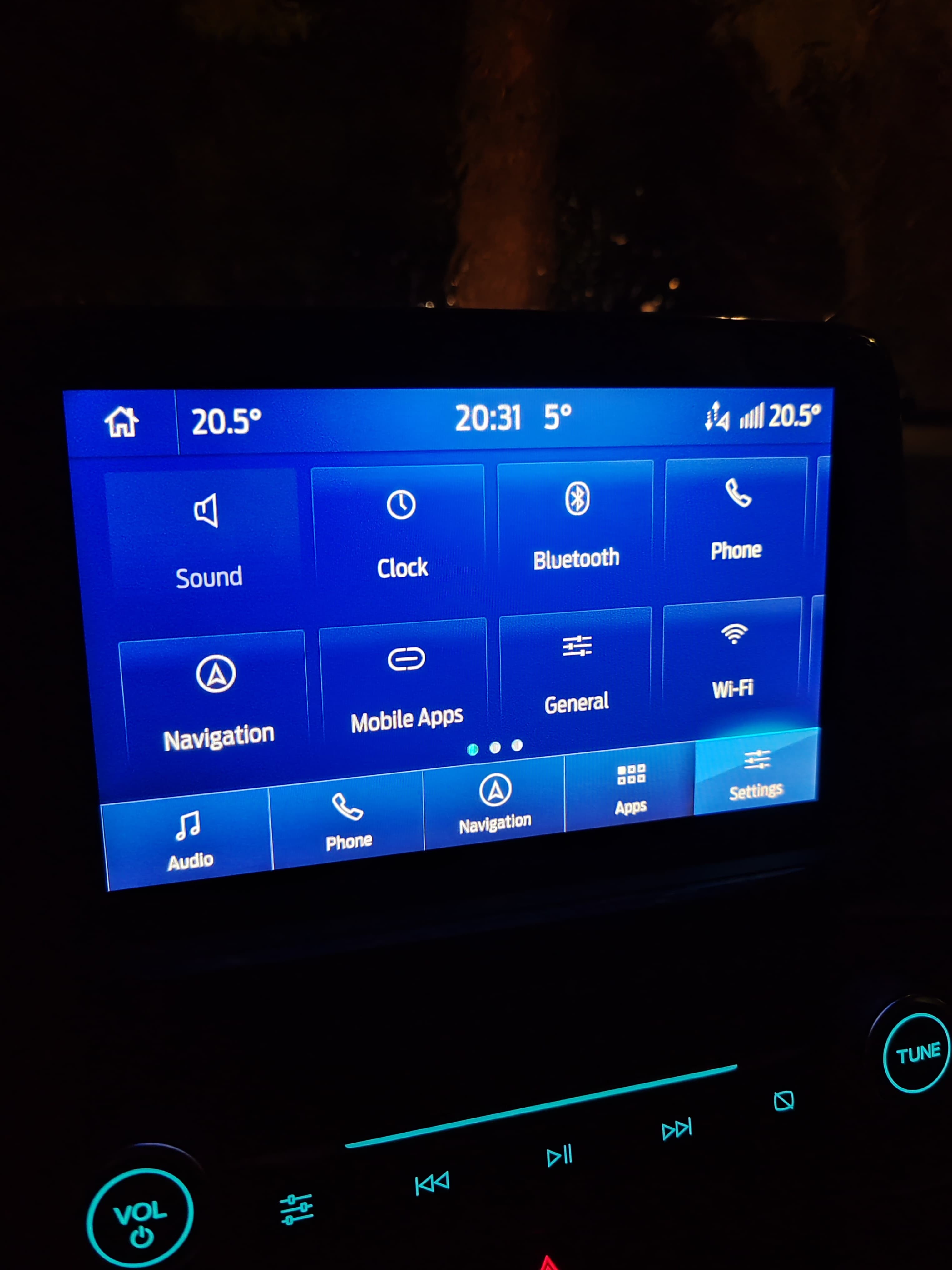

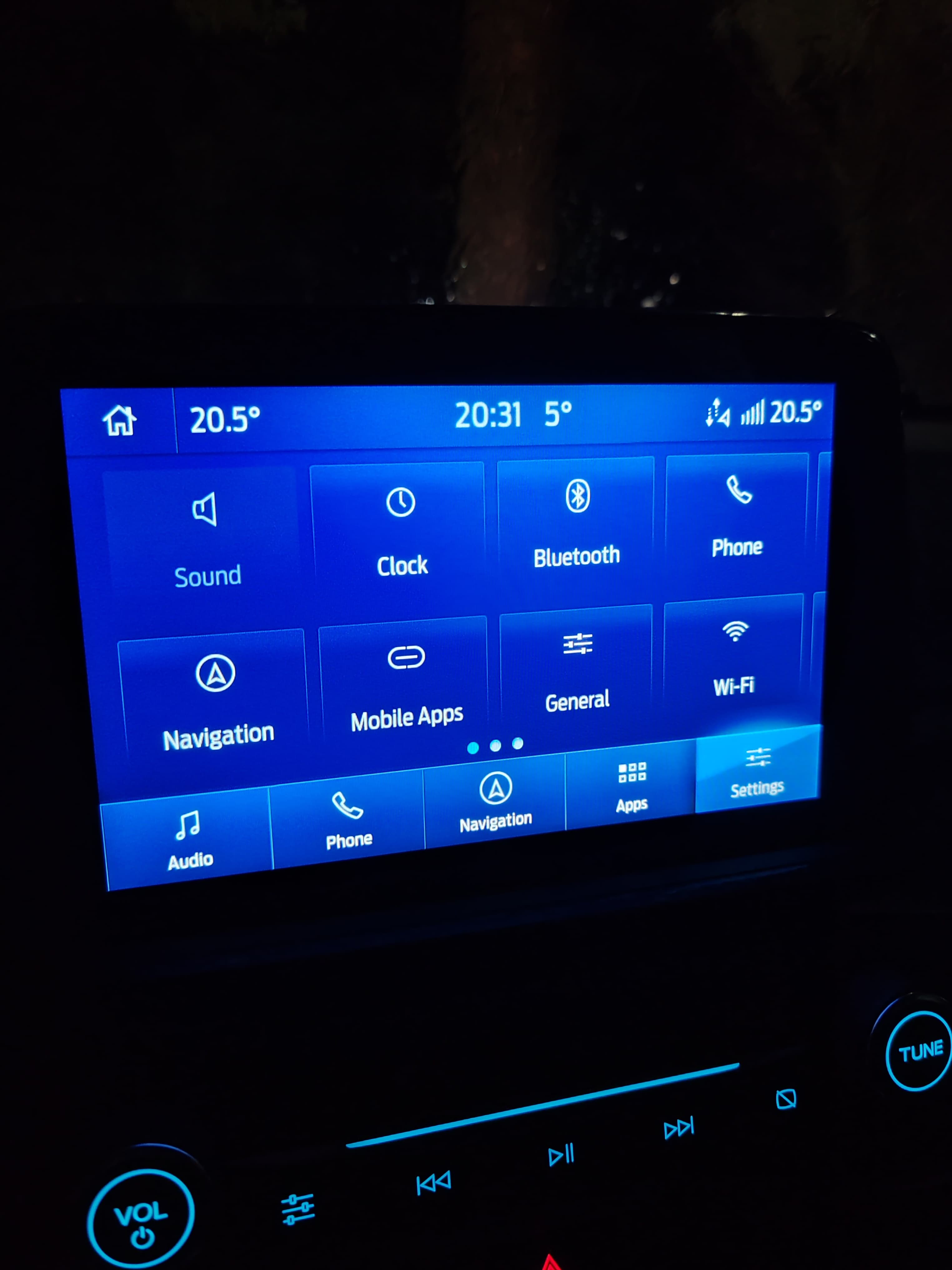

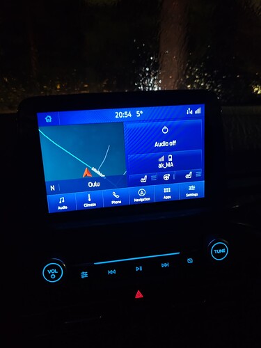

I’ve been also able to bring the climate icon, with the voice control and heated seats and steering wheel icons, with temperature repeater in top menu for dual zone with rotary temperature update when increasing/decreasing temperature or fan speed using hard buttons. But the best thing is the time returned to the top menu from –.– to the current time (Most probably it was because of the brand not mentioned in the APIM).
Pictures are attached here with current asbuilt I have now.
The pictures with temperature repeater in top menu without the climate icon in the bottom menu were before I activate the climate control type to auto. Then It appeared like you can see in the last picture. The climate came first without steering wheel and heated seats icons, so I used forscan APIM list to activate them.
