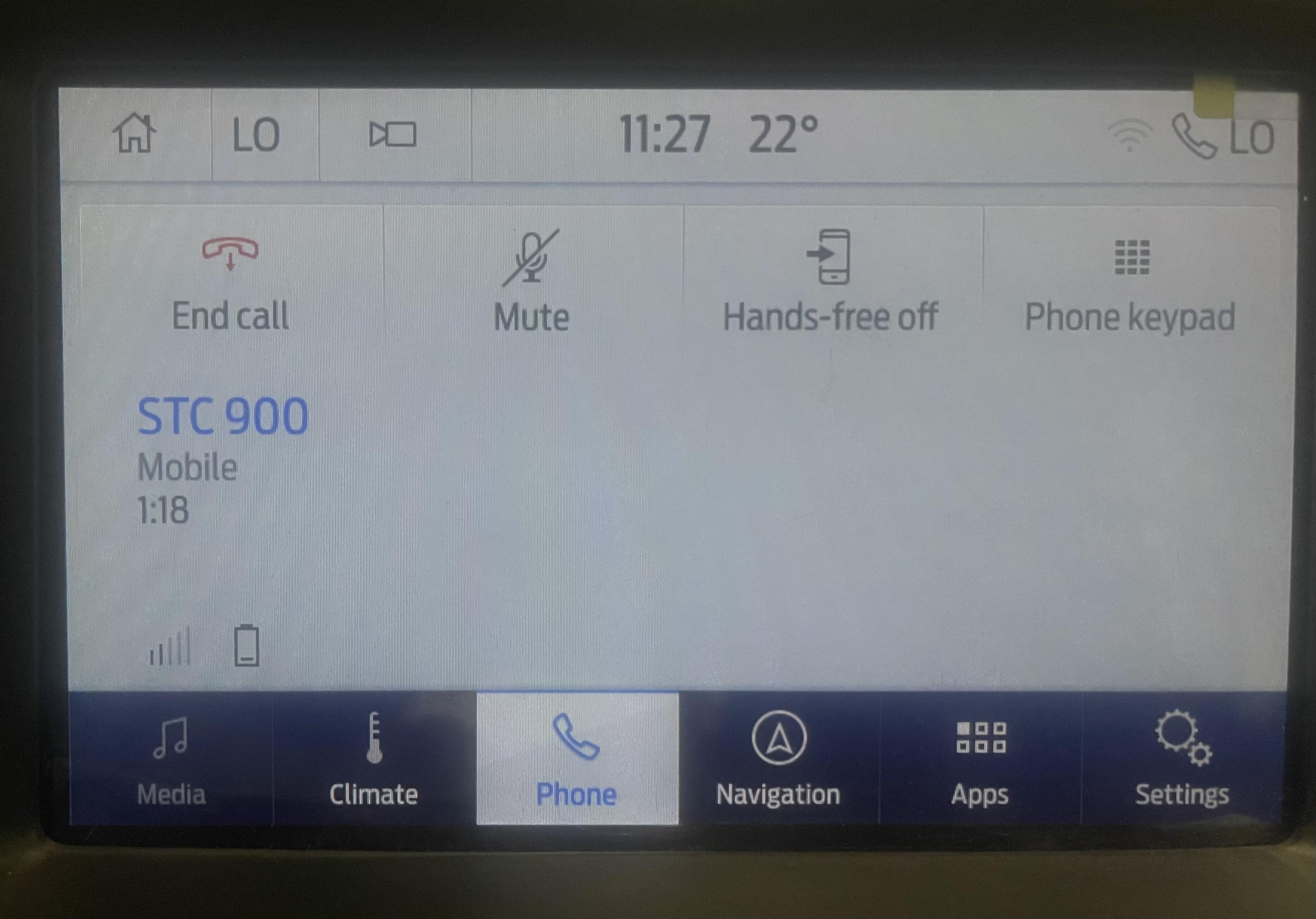

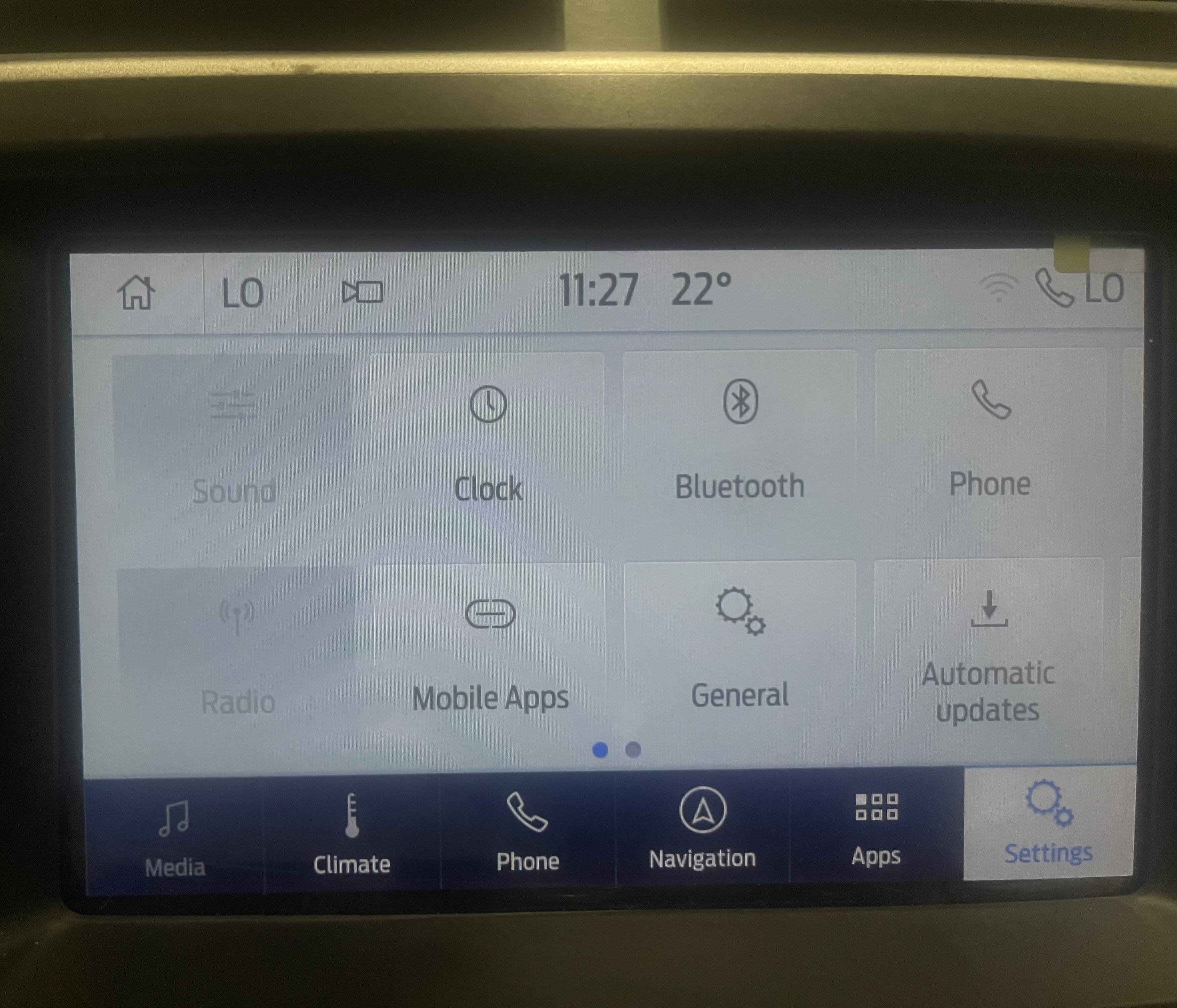

Yes, I mean phone calls.
Voice navi works
But when making a call, the media option becomes dim and you cannot switch to Bluetooth. When you end the call, it returns to normal.

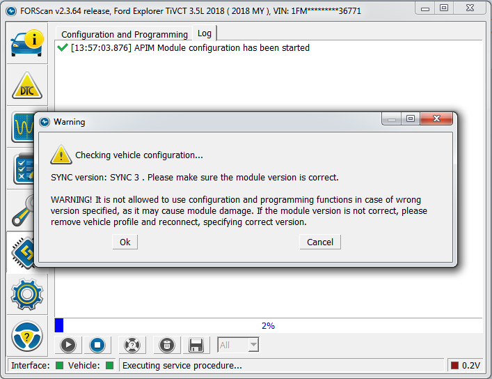

Restore the APIM from Jailbreak and reformat.

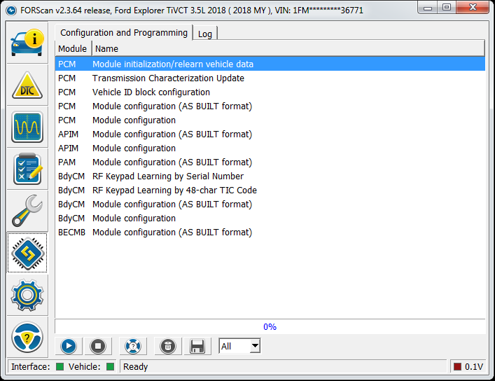

With Forscan, go to the “main module + hidden and engineering mode” configuration and look for the “TouchScreen” option. Select Sync 3 or “8-inch screen” there. This tells the BCM that your Sync 1 is now Sync 3. For other models, this usually has to be done through the ACM via AsBuilt, but for models like mine, the BCM controls this setting.
These settings
APIM
no ACM or BCM

What adapter are you using? If these is all the modules that you are seeing you have some serious problems. You should see at least 10-15 modules.
The settings you need to get to are:
