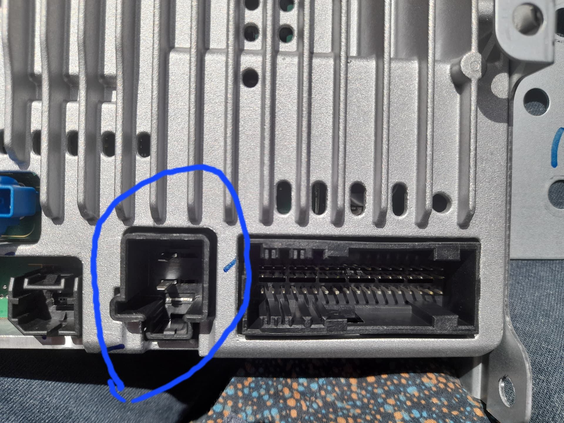

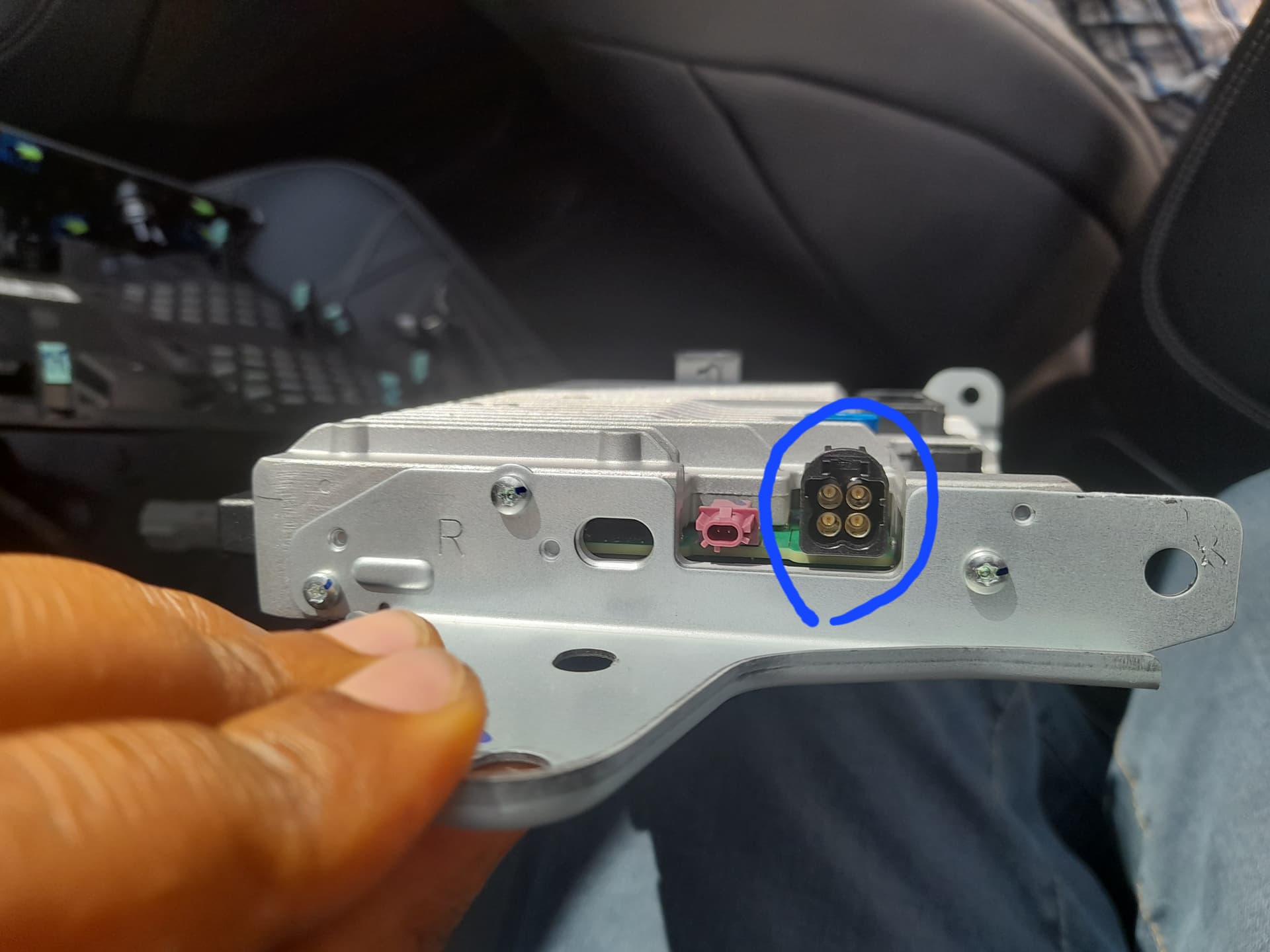

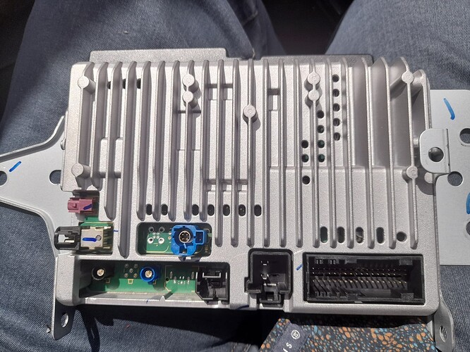

Read through the discussion which was very informative. I have a 2021 Mach-E (Chinese market) and was considering buying an APIM module (EU location) to replace mine to change the location and language. But the module in the Chinese Mach-e has 2 additional ports which I plan to leave unplugged since the EU module doesn’t have them. Would anyone in this forum be able to identify what they are and if they’d cause issues if left unplugged. All the other ports are the same as the EU module
This is automotive ethernet, used to connect to the GWM and TCU.
I believe this is for an external power connection, but not 100% positive.

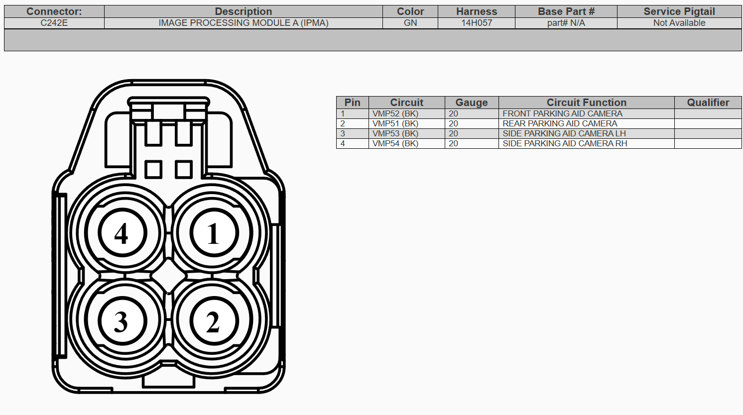

The pink one is for the vehicle Ethernet. The 4x square one is for the 360 camera’s. This is the plug on the 23 Expedition for the same thing.
