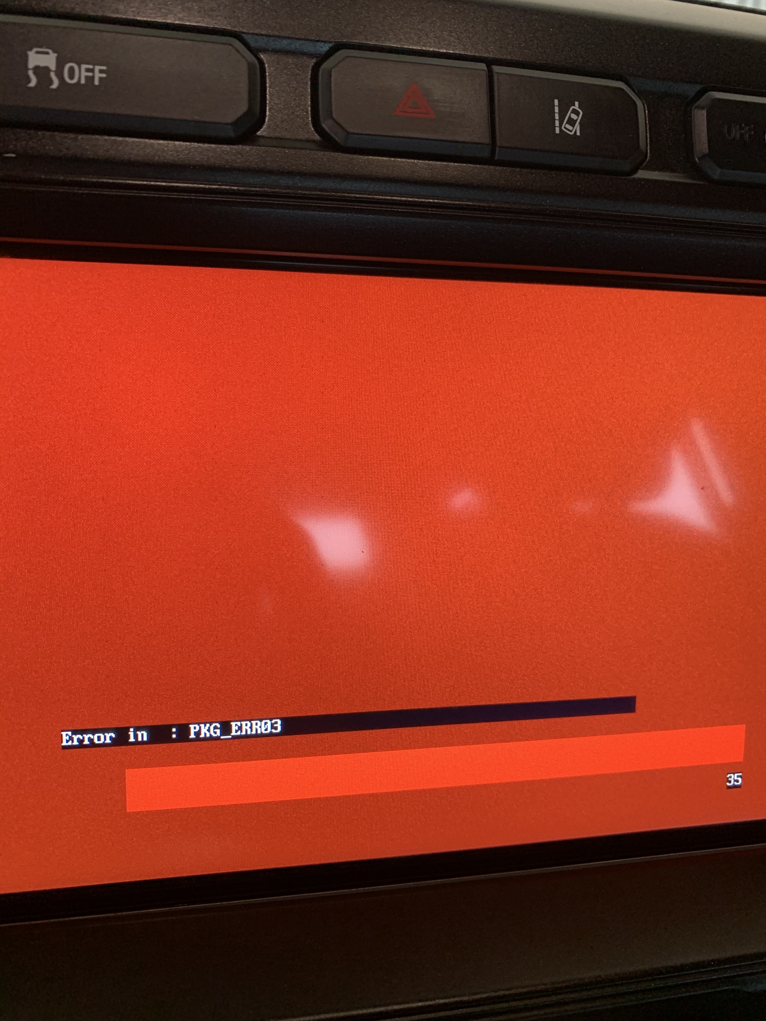

Hi all!
During the installation process I get the error message PKG ERR03 after around 30-60 seconds.
Please help.
Thanks ![]()
Hi all!
Please help.
Thanks ![]()
used the app? post the log.txt file in the root of the usb drive
you haven’t put a reformat.lst in the usb
Thank you! Amateur mistake.
Worked perfectly after re-coping the file list to the LST file.
Hi i am getting the same error. But i tried it with the app and i have the reformat.lst on my usb.
Here is the logfile:

It is saying, that some packages are unable to check/copy… could you help?
thanks in advance,
Ploptimus
Your reformat.lst file seems completely corrupt, it should be plaintext not loads of symbols like that.
ok, then i try to use the app again and take a look in the reformat.lst file… i keep you posted
Thanks, really not sure what has happened to your reformat.lst file, never seen that before, if you have the same error as above it is easily fixable once you have correct reformat.lst
Put this in your reformat.lst (open it in notepad)

Im getting the same message at about 35 seconds in. Im using the manual method on a Mac.
Welcome to the forum, please provide more information…
Current sync version, copy of your autoinstall.lst, copy of your reformat.lst if applicable, region, maps?
Thank you.

Region is NA using maps
please upload your reformat.lst likely the formatting is wrong, also make sure it’s called exactly reformat.lst
also please take a photo of your exact error
Thanks! You were correct about the formatting. It seems my problem was that I used a Mac app called Pages to copy the file list to. Once I changed it to an .lst file I discovered that I could not open it. I then used an app called TextEdit and it seems to have solved my problem. Now the usb is back in the Expedition and I made it past the first 30 seconds with no error messages. I’m in the “extracting map package” phase now. This process and the resulting error made me a little nervous and your quick help was very helpful. Thanks for what you do.
