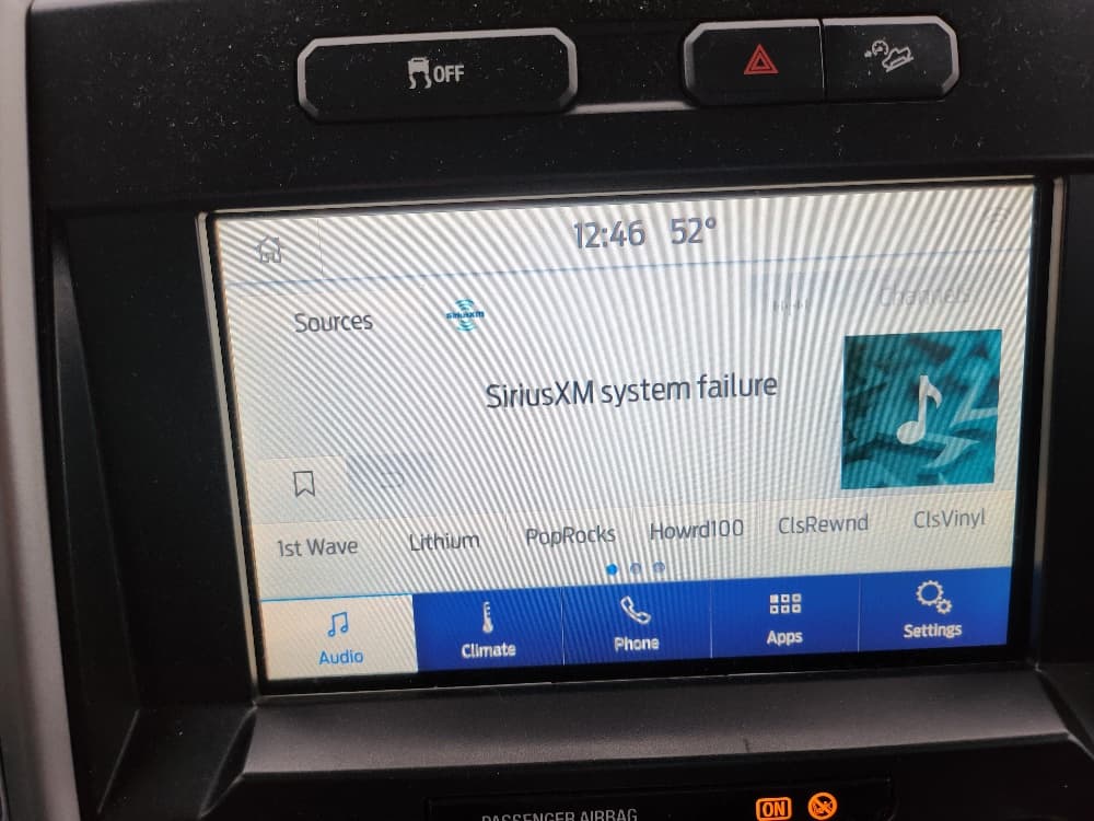

My 2019 F250 self upgraded to sync 3.020204. my XM radio stopped working after it up graded. I decided to use Cyanlabs to upgrade to sync 3.4 and still have same message??

I did it and nothing. Is there a way to roll back the update??
Try pulling the big black fuse under the bonnet.
I disconnected battery and still same problem.
