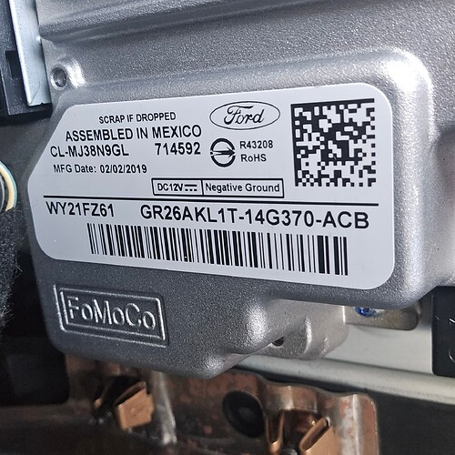

My apim was replaced from ford today. What are the chances of having my20 even though my truck is an 18.

Almost 100% sure that APIM is a 2020+ APIM. I would not reformat it. The only way to know for sure is to remove it and look but with Ford replacing it is pretty for sure it is 2020+

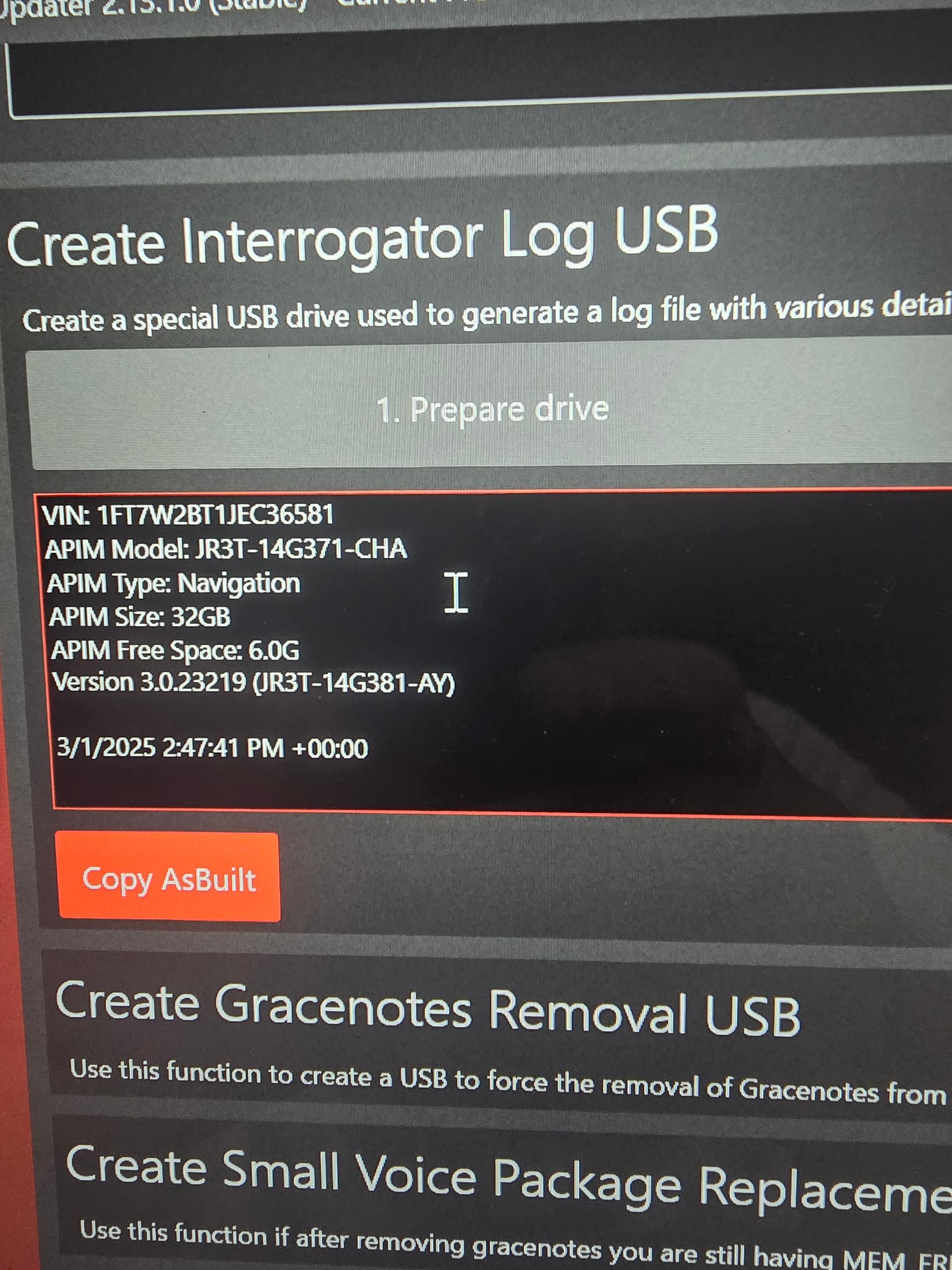

If it’s running 3.0, you will need to jailbreak it and reformat it with FMODS’ tool instead of what Syn3updater uses.

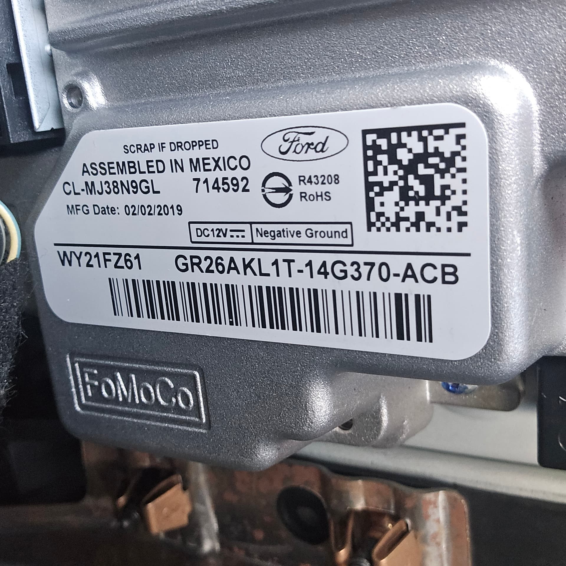

So this is saying a 19 wich indicates no my20. Do i just go along with what the auto updater says and load files to the drive and insert?

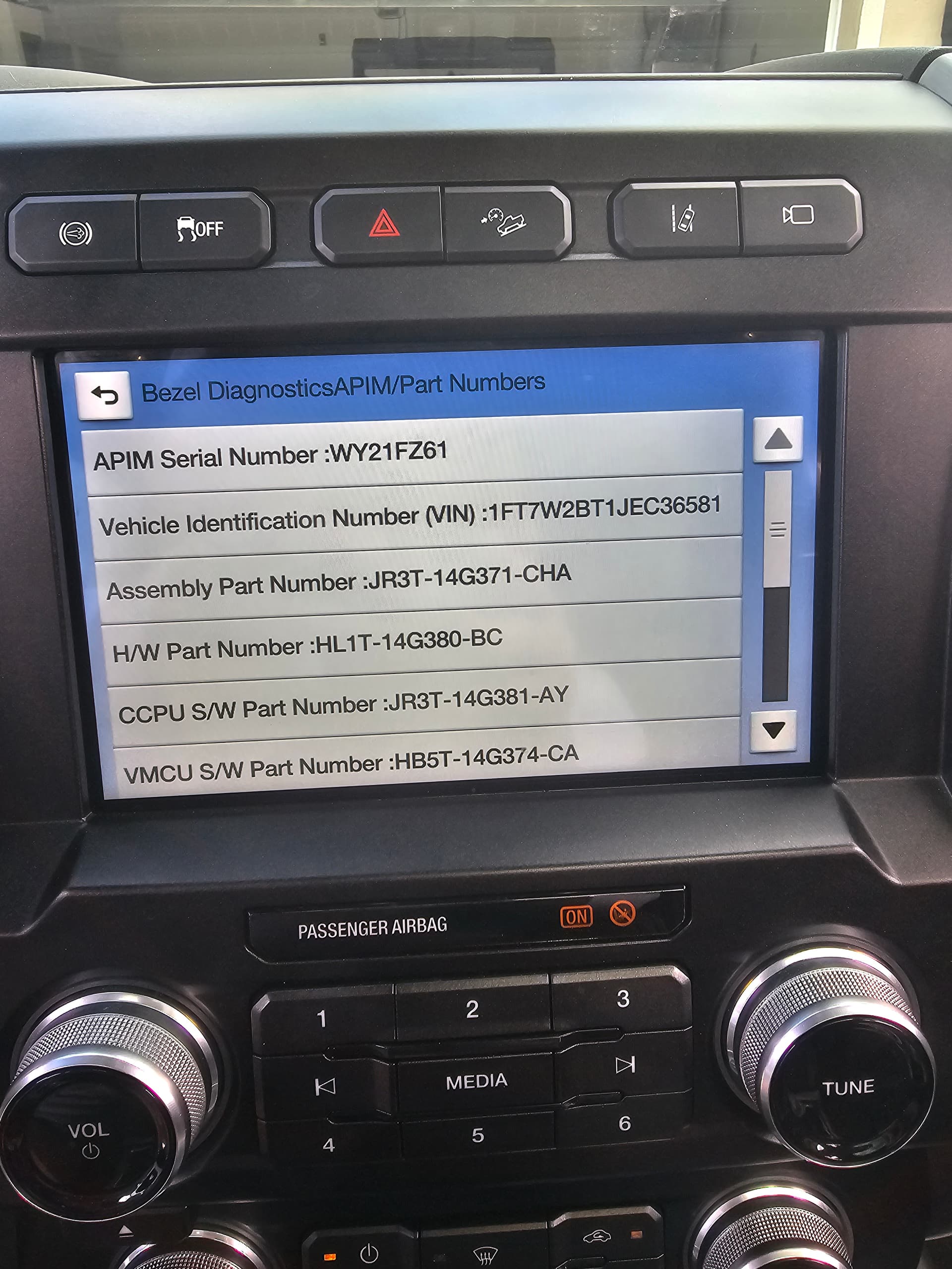

That’s a good sign, but I would double confirm it by either running the interrogator log or going into bezel diagnostics…
The reason I’m saying this is because the 370 PN is for the assembly, not the APIM itself… You are looking for the the 371 PN for confirmation.
Also is this enough free space to load everything to the latest 3.4?

As far as we know, that should be safe to reformat. It’s not MY20 as per our hardware database, but there’s always a chance the screen is and there’s no way to know that I know about.
But being the assembly from 2019, it’s unlikely.to be MY20.
