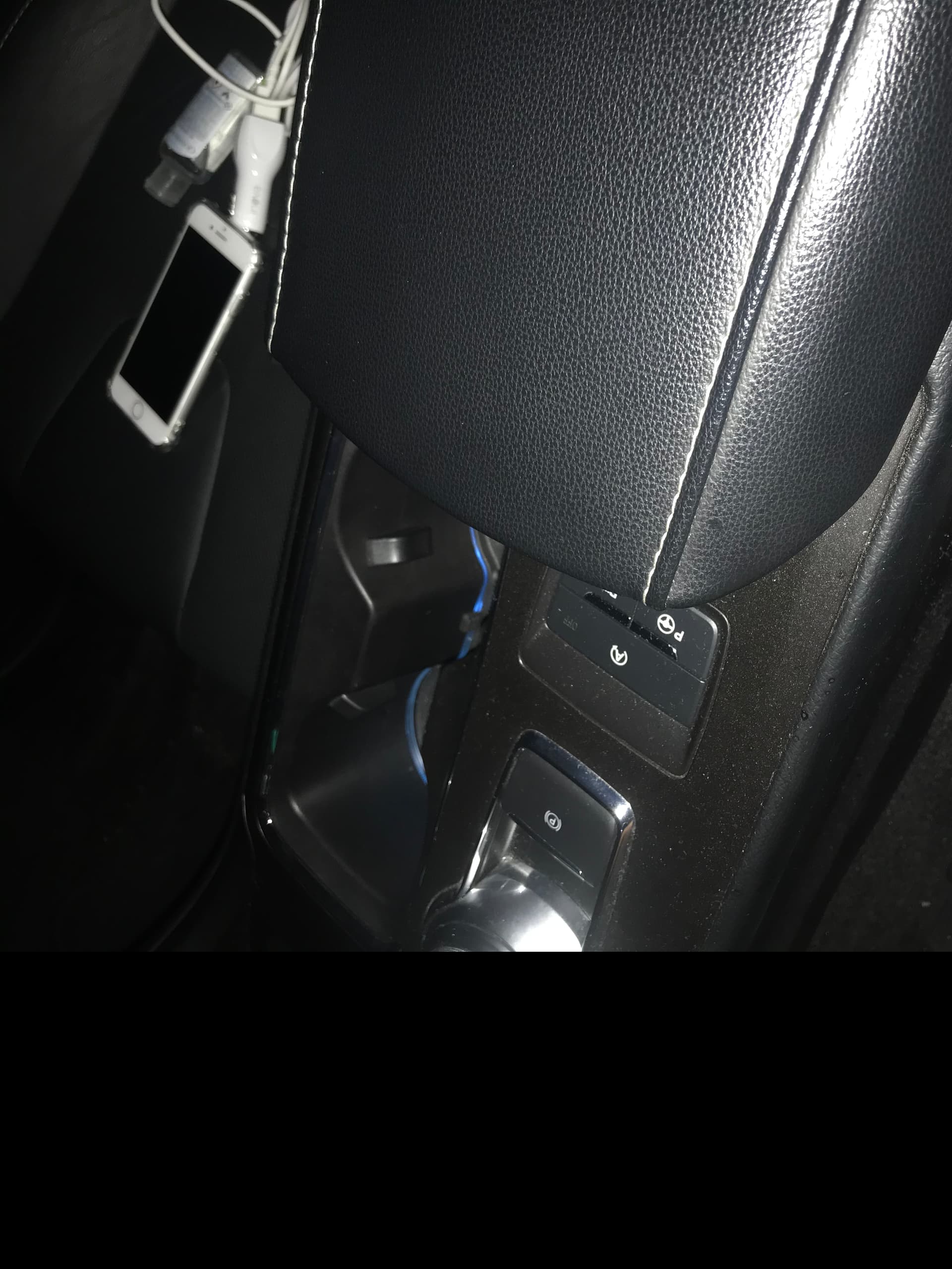

Carlos
28 October 2021 22:54
25
Don’t think, be sure it is an user error. My error.
In my defense, I can say that I read the instructions, already did the procedure once in the past but forget that exists another USB port inside the armrest … in the end it is a big mistake and I have no excuse for that.
It WORKED !!! My multimedia is back again. Thank you both for the marvelous help.

SaNdMaN
(SaNdMaN)
28 October 2021 22:58
26
That’s ok, if you followed F150chief’s instructions, then you are here:
But, you have no NAV.
So what you need to do now is to create a new USB, set 3.3.19052 as current version, and select whatever desired version WITH MAPS you want.
Then, proceed once again with the overall process. It should reformat the unit again, you will see the screens you already saw, and install everything this time.
It will take about 30-45 minutes to complete.
