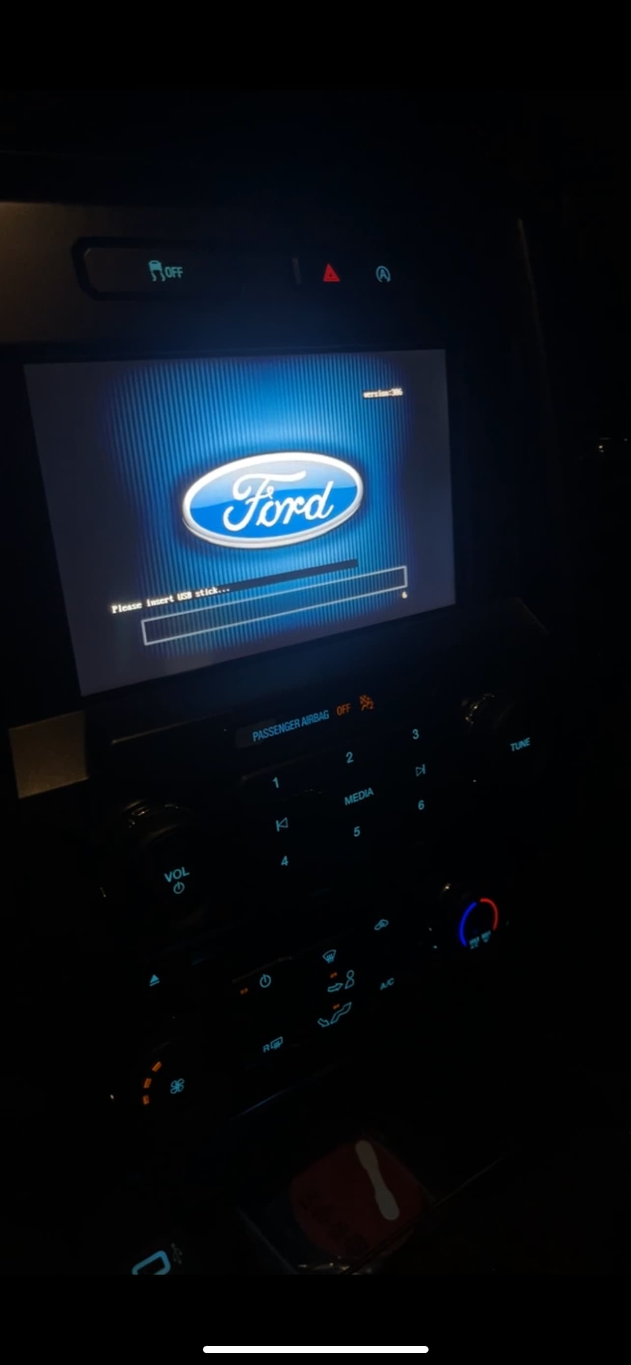

Hi, I was trying to update my system from sync 3 to sync 3.4 manual way, and when it asked me to remove the flash i removed it I haven’t noticed the note to not remove the usb. And now I am stuck in please insert usb interface and once i plug it again it gives me an error.
Install Type: Unknown
Old SYNC Version: 3.0
1- please insert usb stick
2 - error in list(when I replug it)

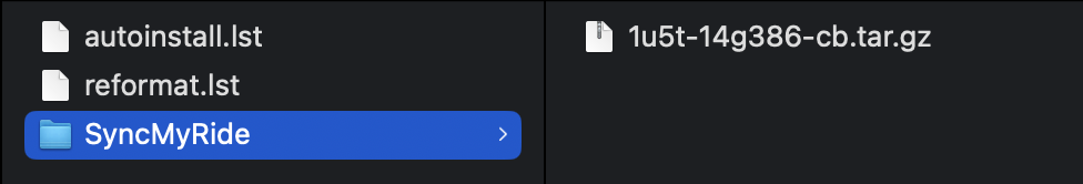

Hi, I have followed this link instructions except for the do not remove the flash part I haven’t read at that time.
This is a screenshot of the files which are on the flashdrive.
autoinstall.lst
Item1 = 1U5T-14G386-CB - SyncMyRide\1U5T-14G386-CB.tar.gz
Open1 = SyncMyRide\1U5T-14G386-CB.tar.gz

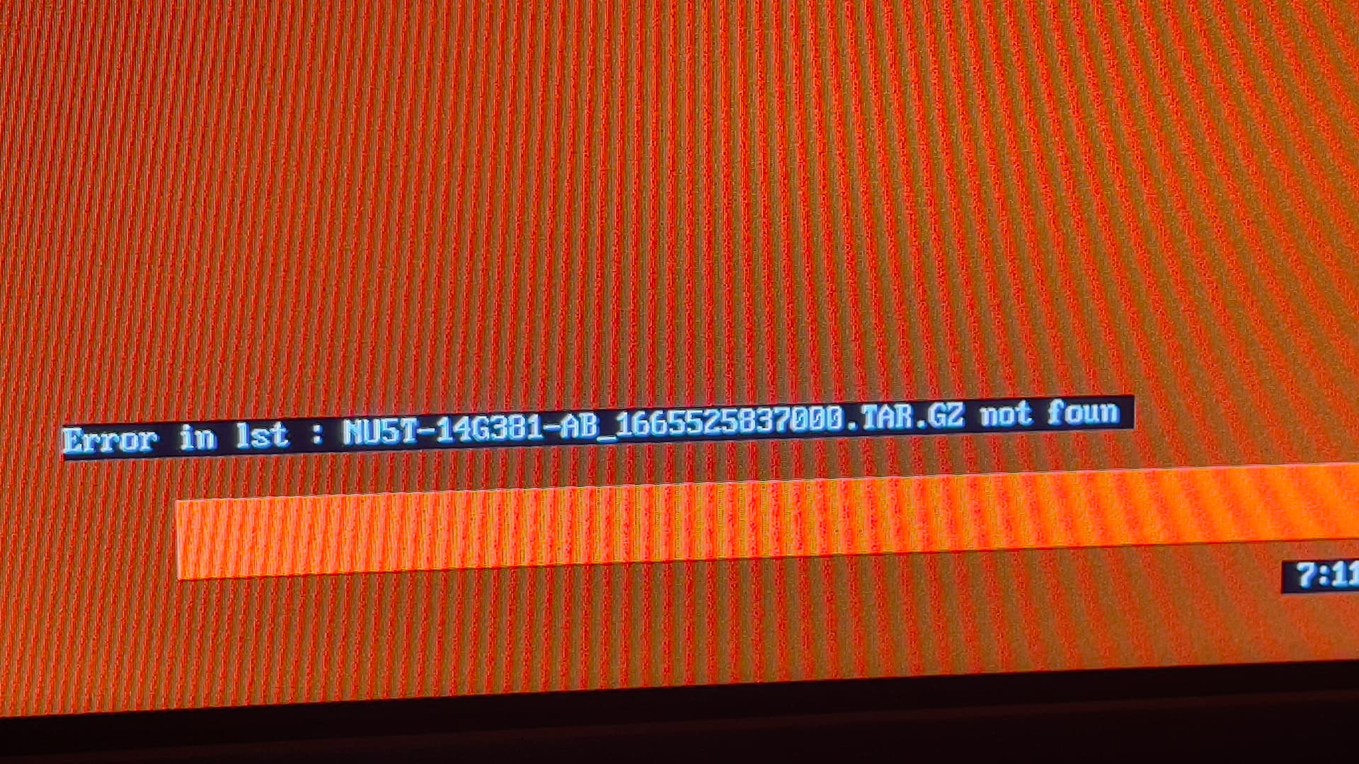

Thanks post, a photo of the error on the car screen
attached is a photo
when the flash is unplugged:
when it flash is plugged:
CyanLabs
(CyanLabs)
31 October 2022 16:39
7
You don’t have any of the TAR.GZ files other than the Reformat Tool, you somehow haven’t downloaded any of the maps, apps, voice, etc.
