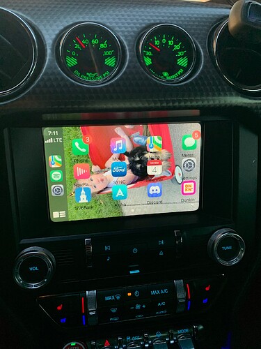

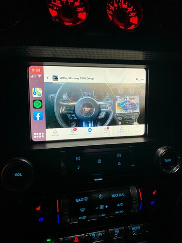

Thanks I’m not so much worried about WiFi atm just wanting remote features I’ve got an obd WiFi unit from T-Mobile I use sometimes it’s kinda pointless seeing how I’ll never use it while driving. Right now I’ve got a pretty cool setup with my jailbroken iPhone and jailbroken APIM I can use any app on my phone using CarPlay. I just think it’d be fun and worth the effort to retrofit a modem. I appreciate the info
If anyone was wondering how to use apps in CarPlay u must be jailbroken with a few tweaks called carbridge, CarPlay++.
