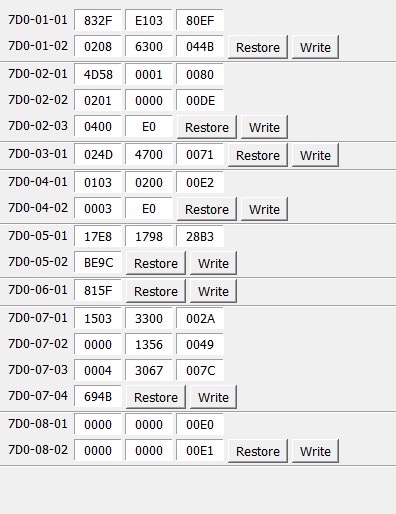

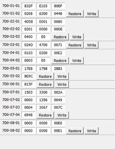

Can you post the AB that is currently loaded into the APIM
Here it is!
Probably need to change the Illumination Strategy setting…
Do you mean changing the value of the illumination strategy to be C1CMA? I already did that on forscan, changing the value on 7D0-06-01 to X1XX :frowning: is that what you meant? I am no expert by any means, this is the first time i do a retrofit.
