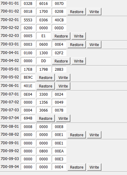

If you have forscan, provide a screenshot for your APIM asbuilt.
I would try changing these two values to 0:
any chance you could type out the lines that i have to correct and what i should change them to, or highlight them from the image i provided I am an idiot and I cant understand how the database works. thank you
As an example:
