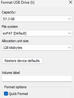

These are the details and whats on the USB. I think its alright?
i dont know if the tar.gz file matters if its a WinRAR it keeps staying WINRAR

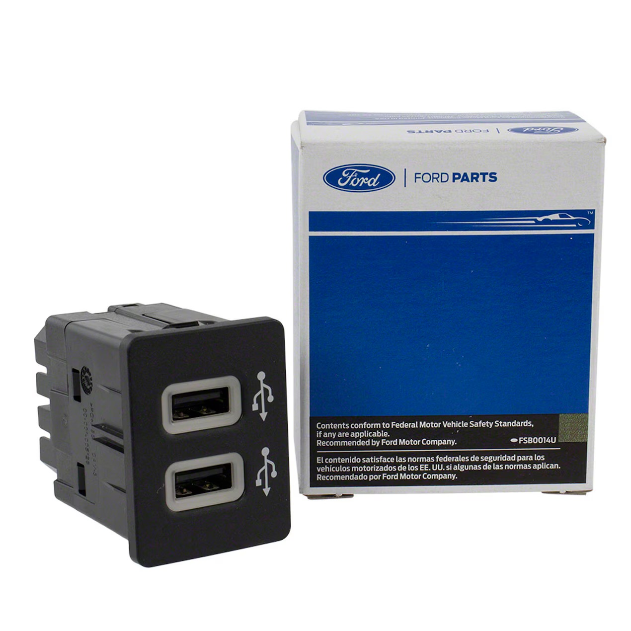

Where did you get this USB hub? What is the model number on it? Maybe a pic of the front of the USB hub also.
So the main problem before was the USB like some of u said it recognised it for a bit but then not anymore (i received the new usb port only yesterday) and its an replacement port from the ford garage. (HC3Z19A387H) i will attach an image.
