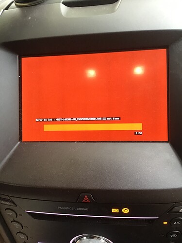

This was the error screen we received yesterday:
However thats the only file thats supposed to be in the SyncMyRide for recovery (which i had but it says it wasn’t) and i then resetted the usb and downloaded it again and then the same error popped up.
So the unit is working, it will progress thru the reformat process if it can find a file.

The reformat.lst file is in the root of the USB. This is evident as the reformat process does call the Sync 3.3 app file, as shown. This tells us the USB hub is working properly also.
But, the file cannot be found…this comes down to the procedure.
Ensure that the USB is formatted properly.
Ensure that the SyncMyRide folder is correct, and spelled correctly with the proper letter case.
Ensure that the file shown above is in the folder.
Ensure that the filename matches EXACTLY to the name in the reformat.lst file.
