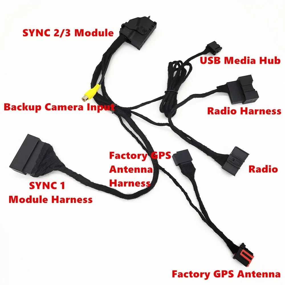

Can you tell me if I got the right Harness? Do i need a harness for the factory GPS antenna too like This One? I’m not even sure if my interceptor has GPS. The new APIM I ordered has navigation so I’m not sure I would need it anyways
The harnesses look correct. Like I said I wired mine to resemble OEM. If it is a Nav APIM than yes you would need one of the GPS antennas for it.
The APIM i bought comes with it’s own GPS antenna. Did you plug your harness into your vehicles factory GPS antenna or did you use your own antenna? That’s my main question, do i need to plug my harness into the factory GPS or no? And I’m almost positive I don’t have GPS

He is just plugging into the old GPS module to get a MS-Can signal is all. The harness in the pic above are sold on Ebay. Just use the PN in the pic.
That was the first thing I did but I got results for a whole bunch of different Ford parts haha. I will take a better look today, thanks. I bought the the harness from the first link I sent but it doesn’t have that GPS T harness or anything to plug into that spot. Do I NEED that MS-Can signal? Most of the harnesses I have found don’t include it. Or should I just try to find your part number instead? OR just use the aftermarket gps antenna that they provide with the new APIM? I’m a little lost on this one

Edit Update: I found the harness in your picture for $80 on ebay. I don’t know what I need though. I thought the 4" to 8" harness I bought had everything I needed. This is really frustrating and confusing. I just want the damn SYNC 3

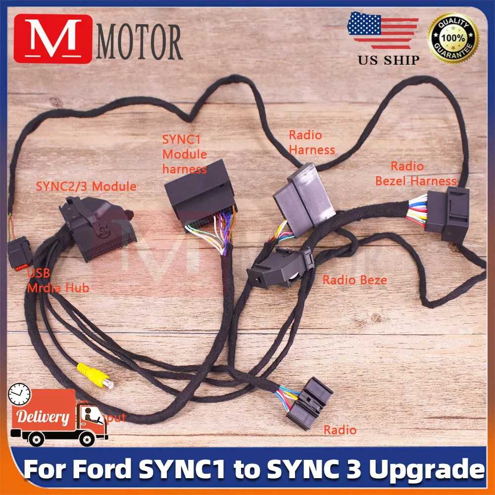

Here are the differences I’m talking about. The first harness in the picture (the one I bought) doesn’t have the factory GPS antenna included. The second harness photo does have the GPS factory antenna included. Which one of these do I need to complete the upgrade?
and they both have 8 connectors total, so it’s throwing me for a loop
Either one is probably fine. I have never looked into these as I have always just made my own connections.
I sent a bunch of messages to the sellers and figured out that the harness with the factory GPS antenna is for upgrading to a sync 2, but is not required for a sync 1 to sync 3 upgrade.
